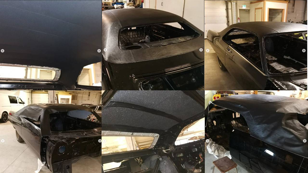

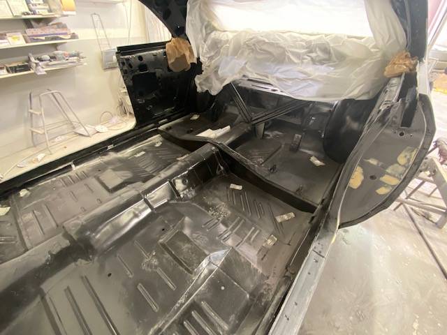

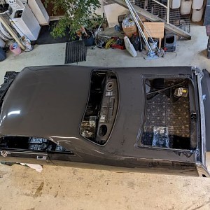

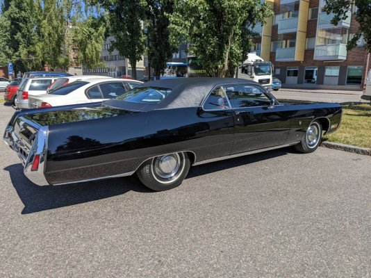

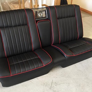

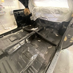

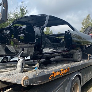

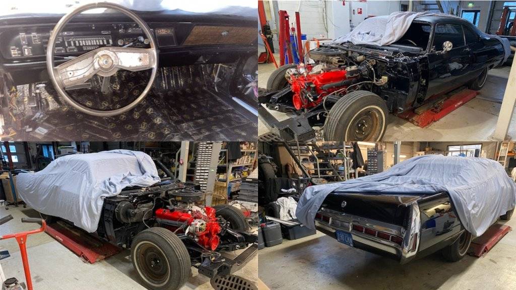

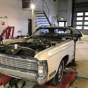

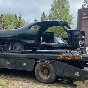

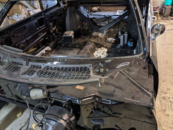

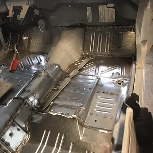

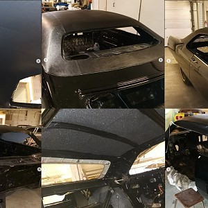

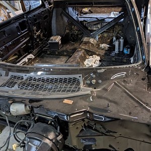

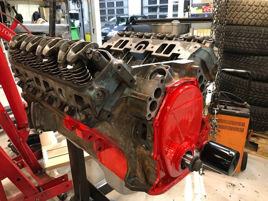

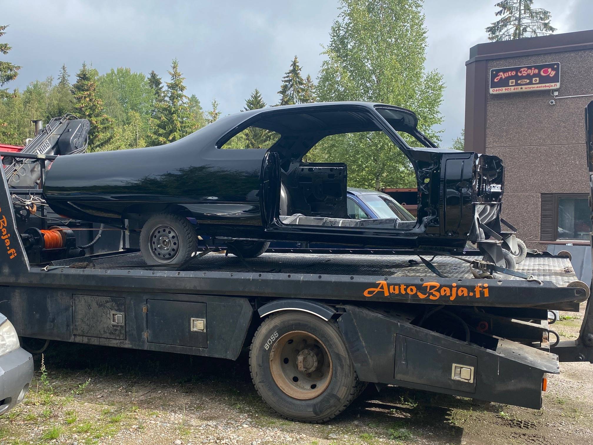

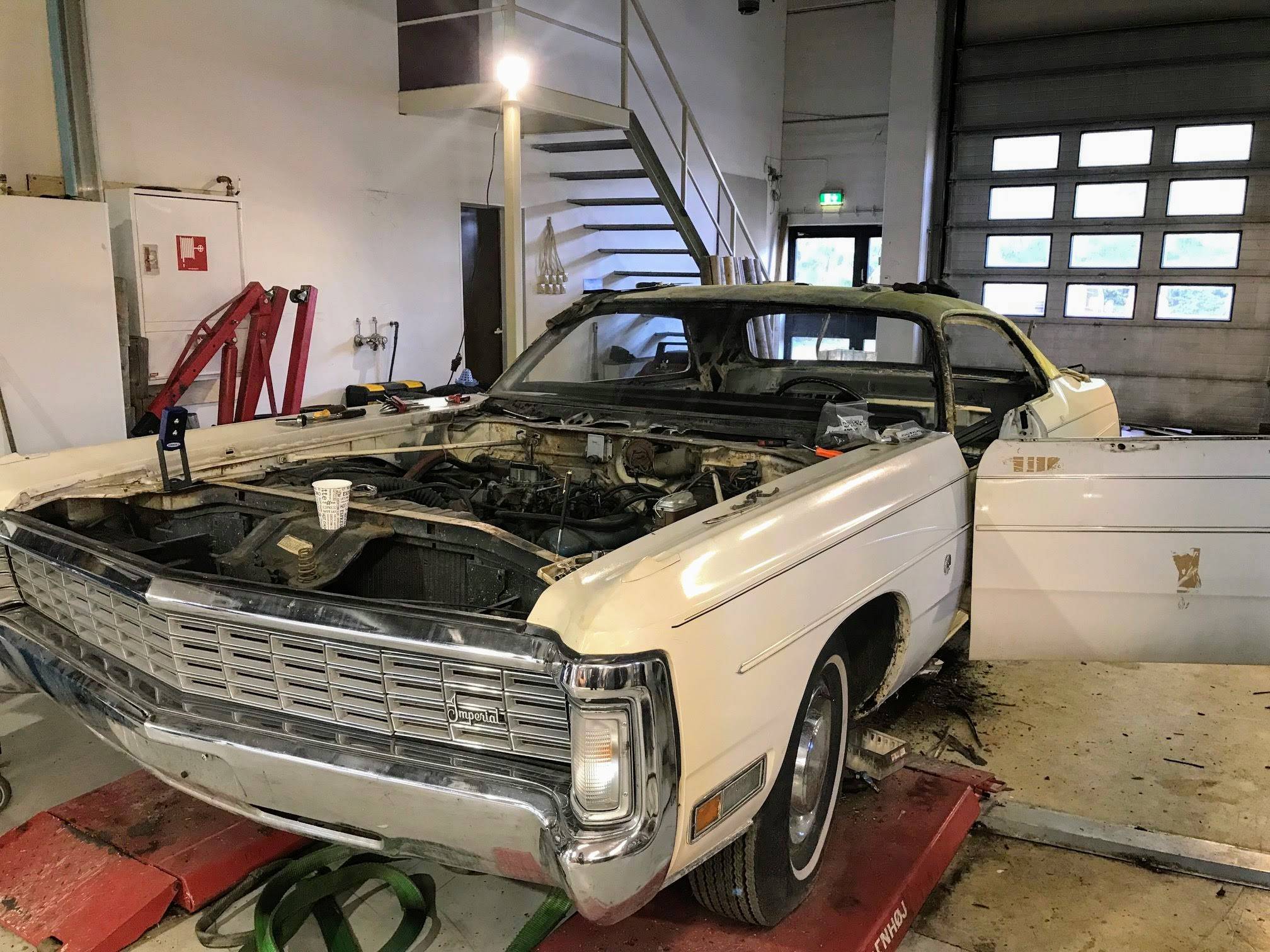

I bought the car from US and now it's in Finland in a Restoration Shop called Autobaja. The body was very rusty and is now being fully restored. Managed to get less rusty fenders and other stuff, but my welder is doing tons of work with the floors, trunk etc. Engine is pretty much done. Decided to go for EFI system, new cam, pistons and valves. Tranny is fully checked. Also, changed new brakes (wilwood) for front and rear. All powder coated and painted. Looks like that this project is not ready for this summer, but 2022 for sure. Will post more pics when restoration goes forward.
Latest updates

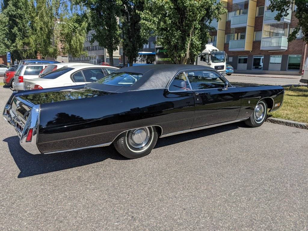

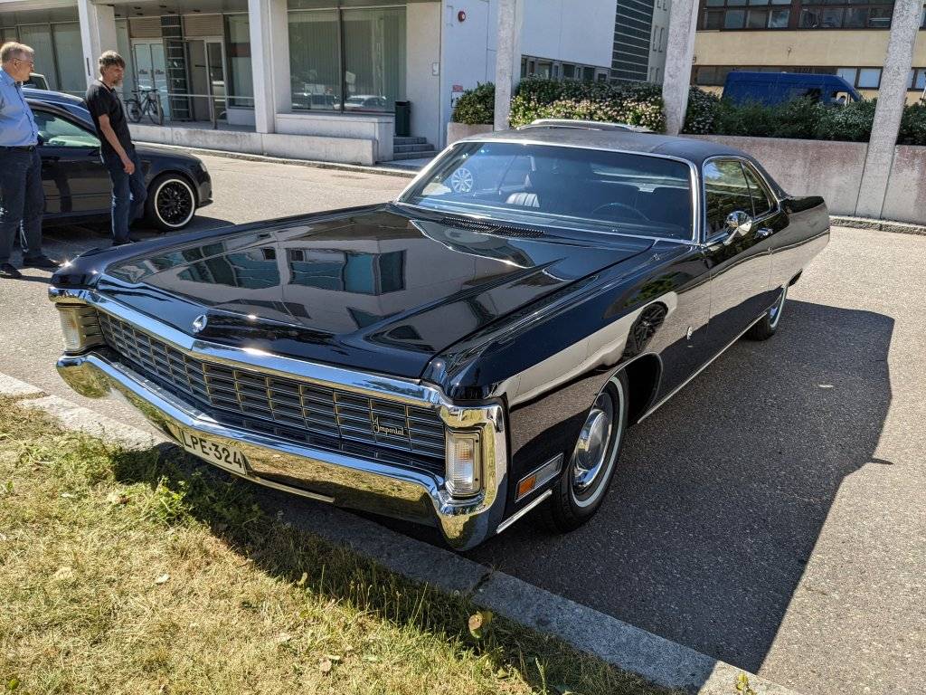

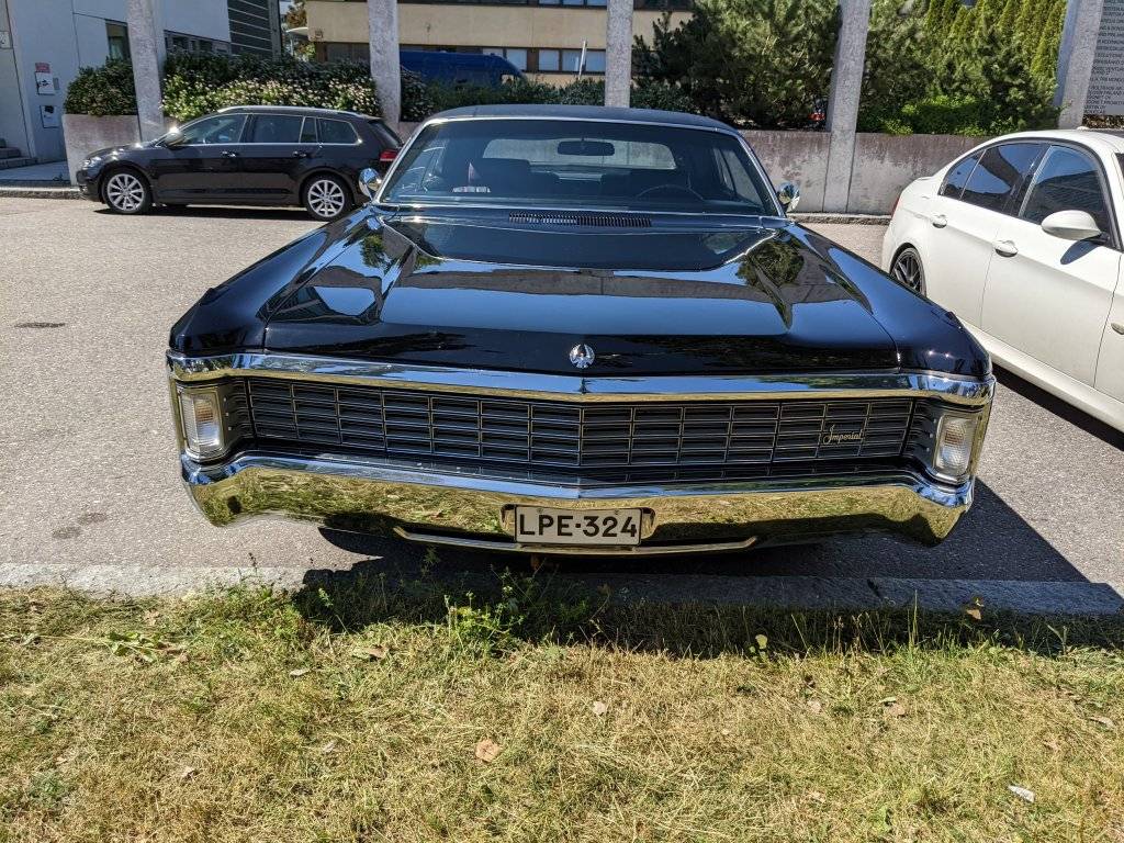

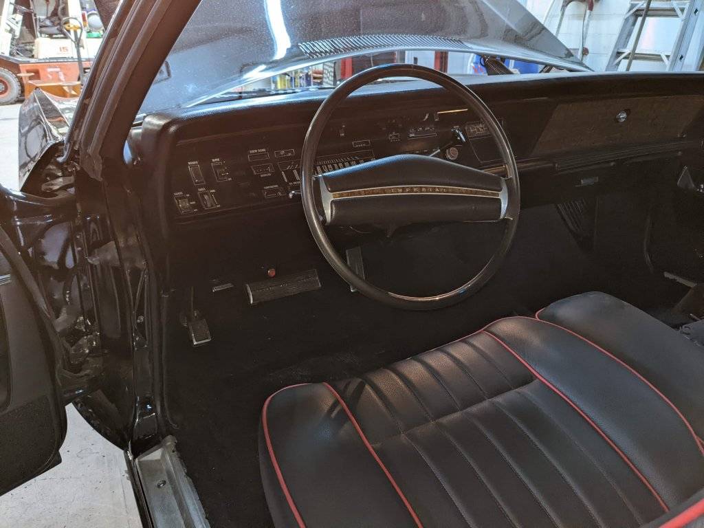

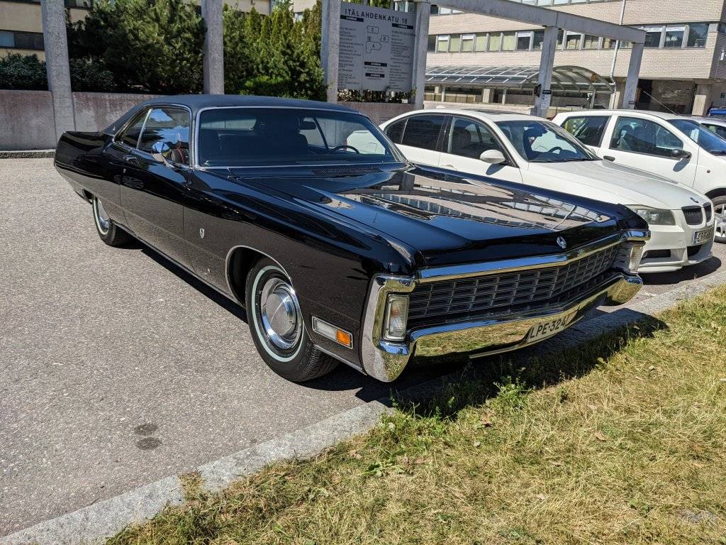

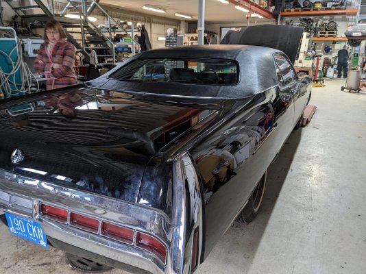

Hey all, Imperial 1970 LeBaron is now inspected, registered and ready to eat miles in Finland. Still some challenges with EFI system, but hopefully they are solved during next week. Happy and sunny summer for all of you.

Simply delicious! Hope we can meet some time to talk about fusie Imperials ...

Stunning.. very happy for you guys. Enjoy EVERY mile.

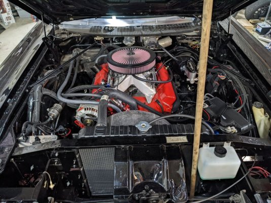

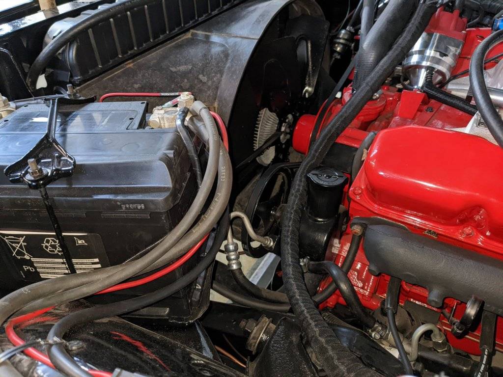

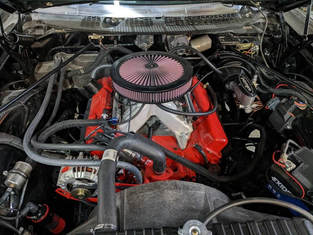

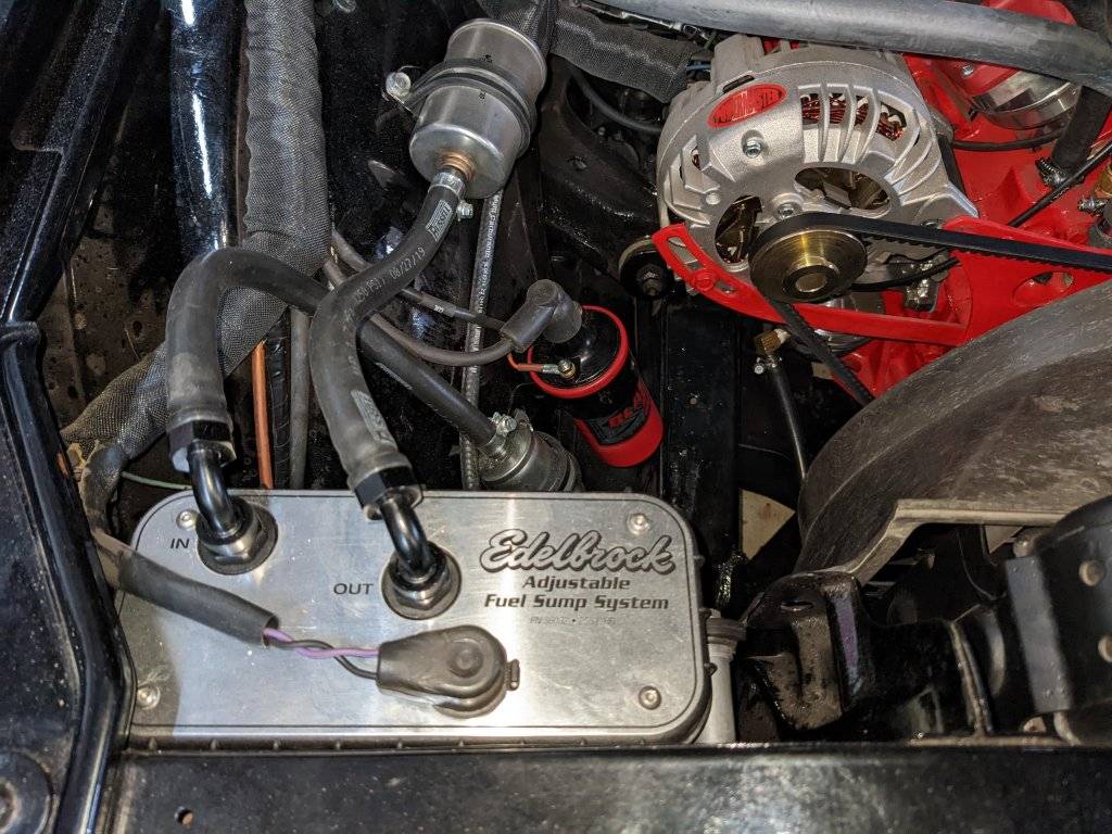

Stunning, I’m happy for you this she’s back on the road after all of your hard work. I am curious though. I think I see an Edelbrock Profli 4 system with an external fuel pump/sump. I’m strongly considering there for my 77 NYB. Would like to know your experience with that system.
Mr. Jari P. Ängeslevä
Hey, it is a good choice. This package came together with a tablet and Edelbrock app, where you can basically adjust and monitor via Bluetooth the whole system. Set up is easy, just manually adjust your timing and then let the software do the rest. It has a self-learning mode, with 3 different levels (slow-medium-fast) and it is recommended to to use first the fast and after mixed driving the medium and then slow. Preinstalled fuel maps works good, but you can also trim them yourselves if needed. Fuel economy is better than with carburator (15-20%) less fuel.

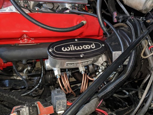

Looks good! Can you tell about those Wilwood brakes, they where just bolt on? And the original brakes was Budd or single piston type ?
Regards,
Mika
Regards,
Mika

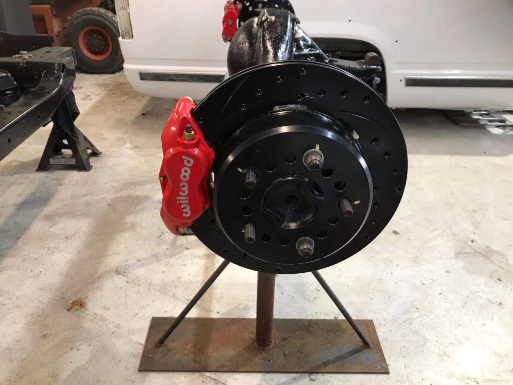

Yes, for the rear axle bolt on, no worries. For front, still the original discs. Currently in discussion with Wilwood guys can they make them. Not available off the shelve. Originals were drums on the back and discs at the front.
Holy Molly thats cool. Nice work. Thanks for saving her. Curious! where are you getting your parts from? That rear brake upgrade is unusual for sure. Details please. Where ya getting that floor metal from?
Keep us posted as your progressing.
Wilwood provides full, bolt-on disc sets, but for Imperials only for rear, not front. Front disc are originals. I use the Finnish wholesaler for the parts etusivu | US-Parts they have a good customer service and even sometime lower prices that directly from supplier. Floor metal is completely hand made. I got a world class guy who is doing that.
