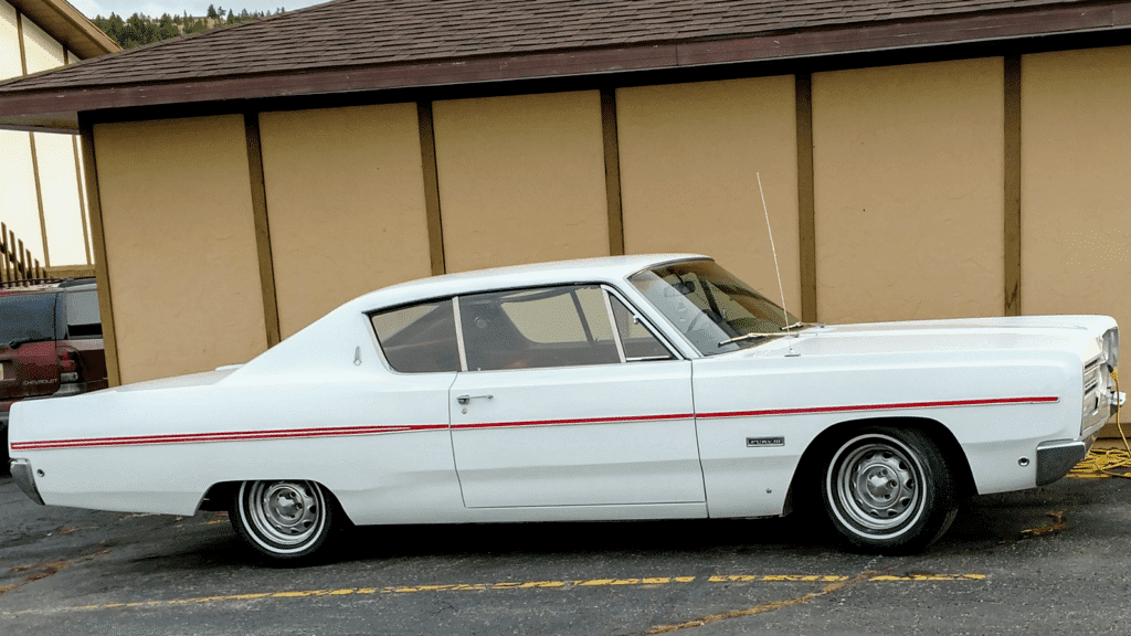

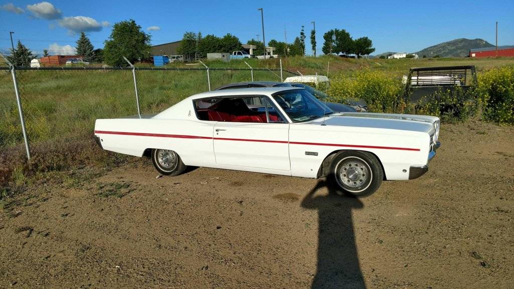

I just purchased a set of 14x6 rallies and was curious what size of tires I should run... I'm new to this so any information will be helpful.. there going on my 68 Plymouth fury iii .... Any help is appreciated Tia

I am REALLY liking this '68 Fury, the white w/red int. is real sharp. These fastop Furys seem to work a lot better without the vinyl top, but that's just me. If you do decide to switch to 15 inch. wheels, you might also consider a set of Magnum 500's, which came out in '67, they were optional on most C-bodies that year, and probably for '68, so you'd be ostensibly switching to something that was probably available from the factory when it was originally bought. Even if not, they have a good period correct look.
