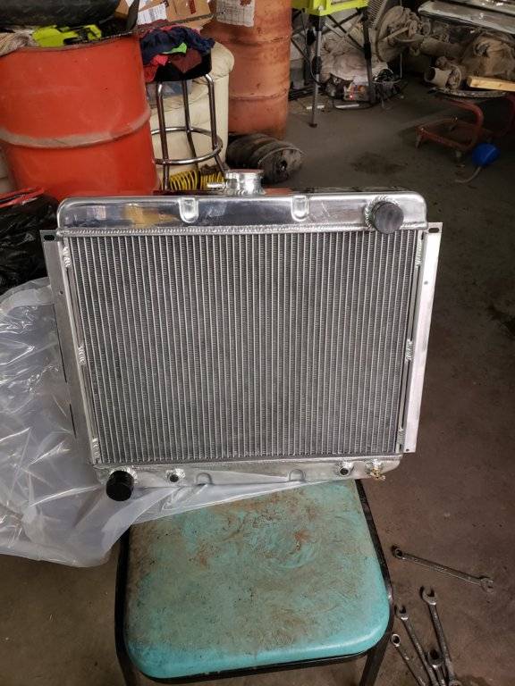

What/whose radiator did you use ?

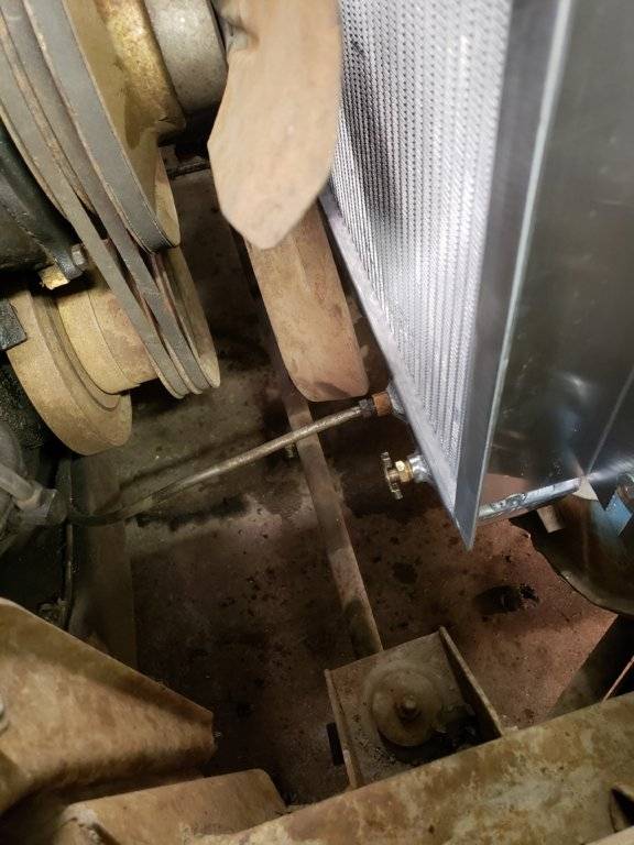

It's an eBay radiator for a big block B body 22" core. Had to modify the mounts a bit to get it to drop down. It is shorter than the original but still fit. I might go down with it a little bit more cause it's running pretty close to the trans line on the passenger side.
