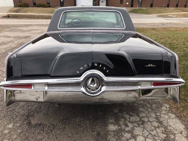

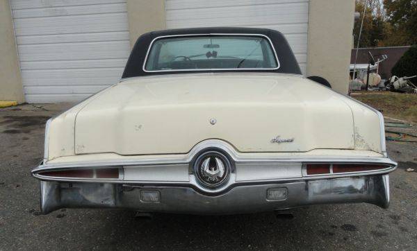

    Not all interchangeable.
    64-65 ...Same:
    66 Reverse lights moved down:
    And the inserts between the tail lights changed along the way...(also note the decklids changed).

    USA
    Fronts are same all three years.
    Rear uppers are same. The '64,'65 Lowers are same.'66 lower has Back up lights ('66 only).
