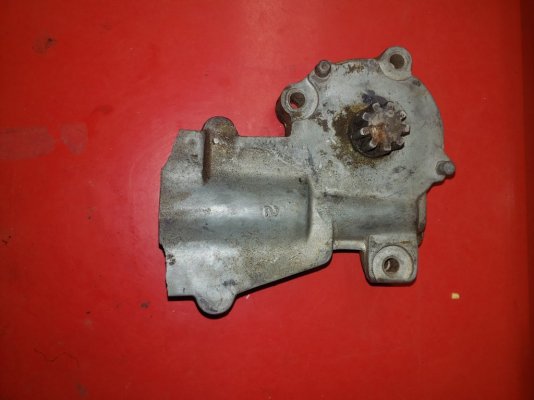

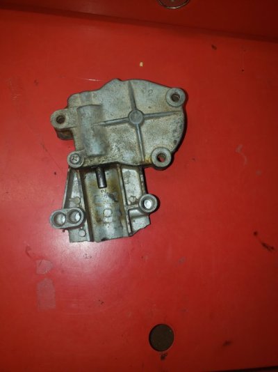

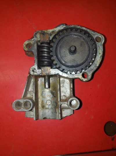

I have a 1964 Chrysler 300 Convertible with electric windows. I see some threads about 1965 and other years window motors. None will fit a 64. The issue is the Drivers side motor. The wheel inside the motor is broken. I have contacted Dorman and looked trough their website, but no replacement is available. Any other ideas? Where can I get a gear or replacement motor? See the pics attached.
Thanks, Chuck

Thanks. The motor maybe ok, and if not, I can have it rebuilt locally. It’s the broken gear I need to replace.

I have a head with broken mounting points but good gears. It looks like the small pinion gear is pressed into the big drive gear. Not sure if that will press out ok, to be able to remove the drive gear? If not, you need a whole head. $25.00 plus shipping. Send me a Pm if interested. Thanks
