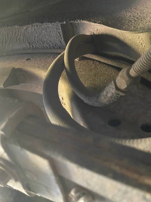

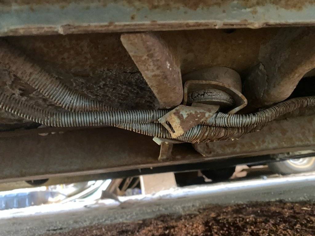

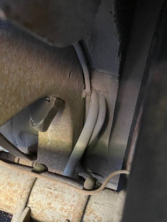

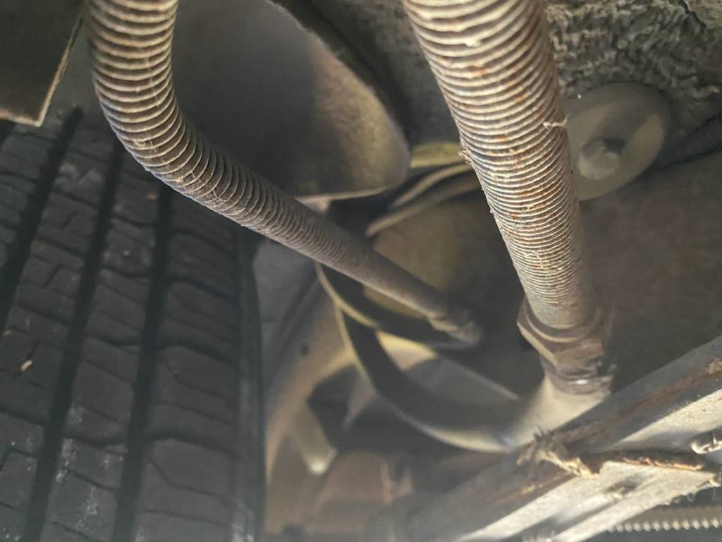

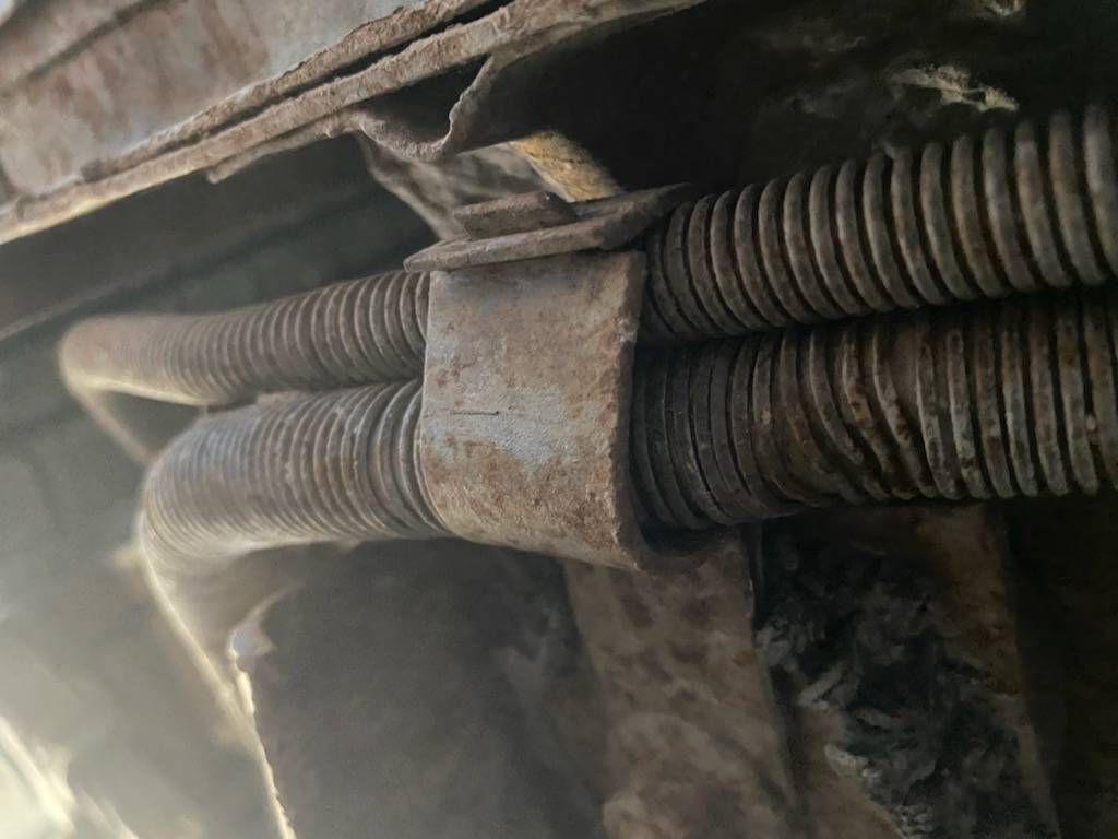

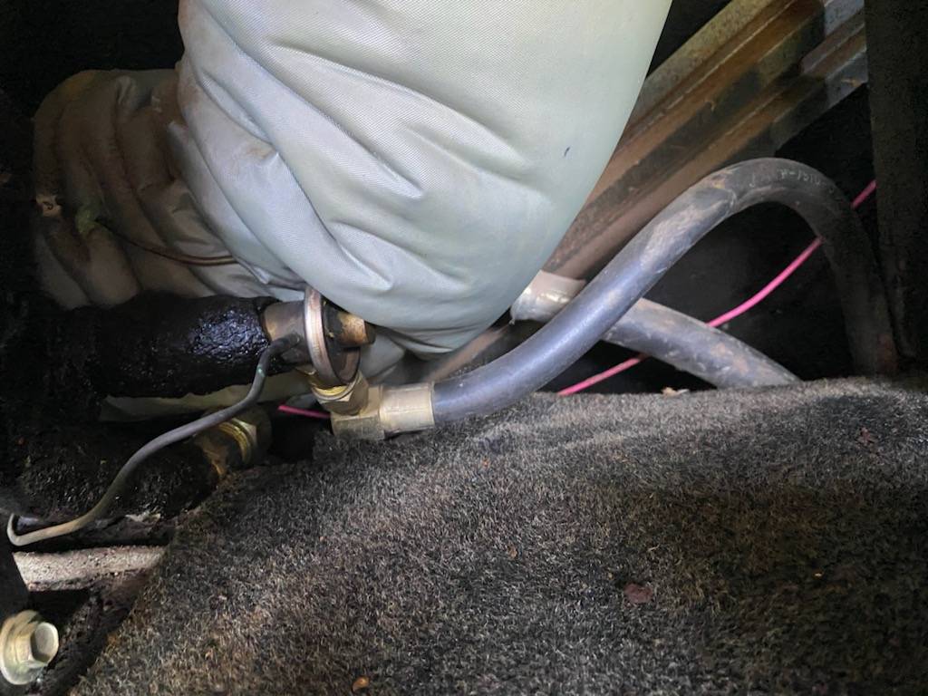

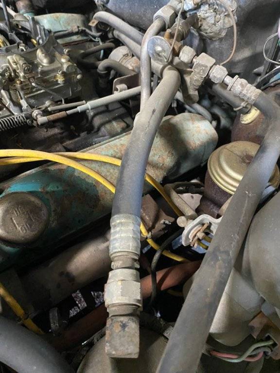

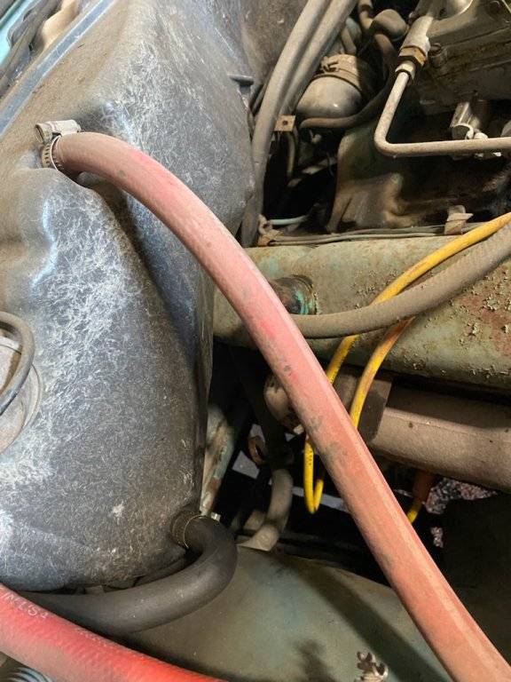

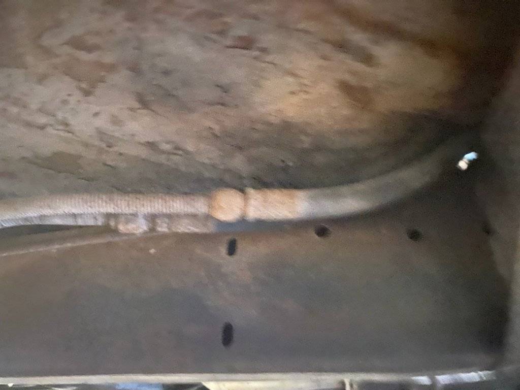

Here are some photos I took that I hope will help. Sorry about the quality of a few. The first 3 show the routing through the engine bay down to the passenger side frame rail. The next 3 show the position down the frame rail and the last 3 show the transition into the trunk and the attachment to the rear AC unit. Let me know if you have questions.

Thank you so much! This definitely helped me! That's exactly what I needed!
It will help me too as I've owned my 1965 LeBaron for decades (since 1972) before I noticed that one or maybe both of the lines are reversed. That is, the end that should go into the trunk appears to be under the hood and vise versa!
