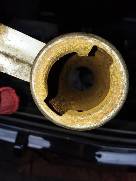

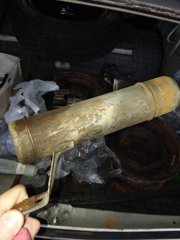

The filler tube question was another one I had on my mind as well, just hadn't asked. It's a mess with rust deposits on the inside. The outside is fine and I already cleaned it up. I can't really clean the inside well with a wire brush or die grinder because it's small circular dimensions. I had thought about maybe a Dremel with a long extension or something. Try and clean it up the best I can and hope it's good enough.

I suggest that you use electric tape and wrap up the outside real good
Then get some acid magic and dip it over night
That rust will be gone inside but may leak if it penetrates the tube
An alternative is to get it cleaned and dipped at the rad shop where they repair and seal tanks
Should not be much$$$
This is some wonderful advice and I appreciate it greatly. I've never used acid magic, but honestly considered the Bar Keepers Friend/Comet type of cleaner. I also thought about a bead blaster, but doubt it would get inside well enough. The radiator shop idea is the best I've heard anyone mention and I really think I'm going to try and go that route. Great idea! I truly appreciate the help.
