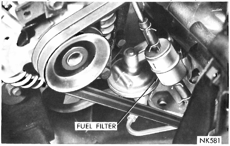

Fuel pump and all the lines finally finished this weekend. Any thoughts on adding a fuel filter between the fuel pump and carb? Really want to add a fuel filter somewhere. Don't think the tank filter sock is enough. Spent the time and money, and want to keep everything clean.
This is out of the '66 service manual, but '65 is the same.
This is "exactly" what I was looking for! Thank You so very much! I need to fabricate this 2 piece line from pump to carb to include the filter. Have to admit, I hate using rubber fuel hose anywhere on my cars but understand this is OEM.
