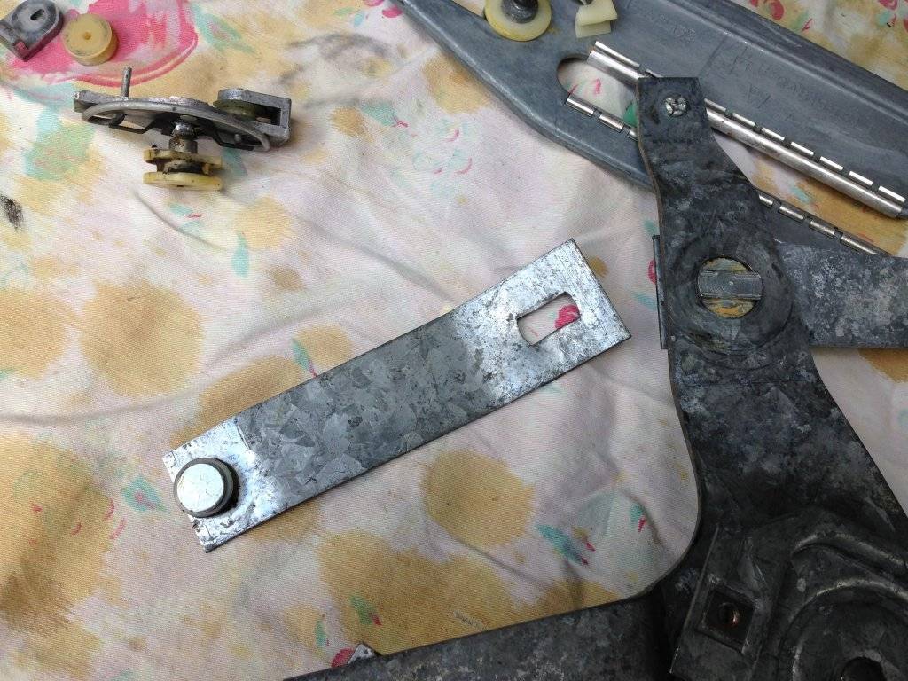

I have a 65 Monaco also. Read this thread just after i removed my driver side rear quarter glass and regulator. After cleaning up this what i have.
1. the arm came off of the regulator assembly. Its a press fit i think i can repair if i can't find a whole regulator.
2. The rear track roller square slide is broken. Need one of those.
3. The glass lower frame is bent towards the rear. Right where the roller is inserted. I think i can straighten this if i can't find a replacement.

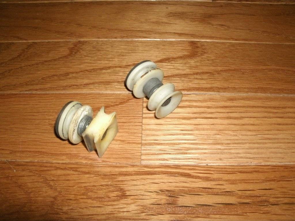

4. The mystery is the broken track roller guide i found laying in the bottom of body cavity with the other broken pieces. I can't figure out where this would go. It is not the same piece as the front guide roller.
So Fury-fan. Would you happen to have the rear roller-guide? The 2nd photo from the top.
Also a roller guide shown above if i can figger out where it goes.

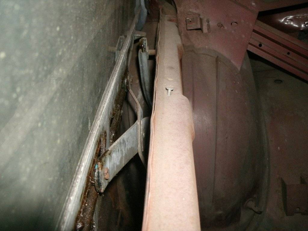

Those are the parts everyone asks about, the parts that always break. I'm depleted on them except for 2 sitting at my computer right here. I've been thinking about how to reproduce them, or create something to meet form-fit-function. These are the last loose ones I've got, and as you'll see in the following pics I just took from one of my cars, they are missing in this pic so apparently not spares. Can't sell them.
I've recently seen, on this site, a page from an FSM showing how those window parts go together. The rear roller will slide in the silver channel at the top of this pic, the channel has 2 threaded studs for adjustment.

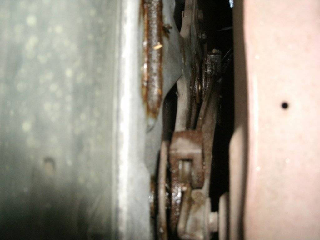

As for the roller-guide in your bottom pic, looks like there are 2 of them in this pic, the channel they slide on is not in your pictures. Channel is at the front of the window, view is looking down at the rockerpanel.

And here are my 2 little slides, not sure where the round-round version is used, but all the window stuff I have is from 65-68 C-body.
Thanks fury fan. I figured out where the second roller glide goes. The number of posts looking for these things seem like an item needs to be reproduced.
As for the roller-guide in your bottom pic, looks like there are 2 of them in this pic, the channel they slide on is not in your pictures. Channel is at the front of the window, view is looking down at the rockerpanel.View attachment 84837
Fury Fan,
The two in the bottom photo look like they may fit the same application. If the double roller one has a swivel it may replace the square guide version.
window-slides-rear-65-68-c-body-swivels-jpg.84838
The one with the 2 rollers is different. Putting them side-by-side it is about 3/16" taller than the one with the square slider. Don't know if that difference could be taken up in the4 adjustment of the guides? The dia/width of the grooves is the same for both, though.
