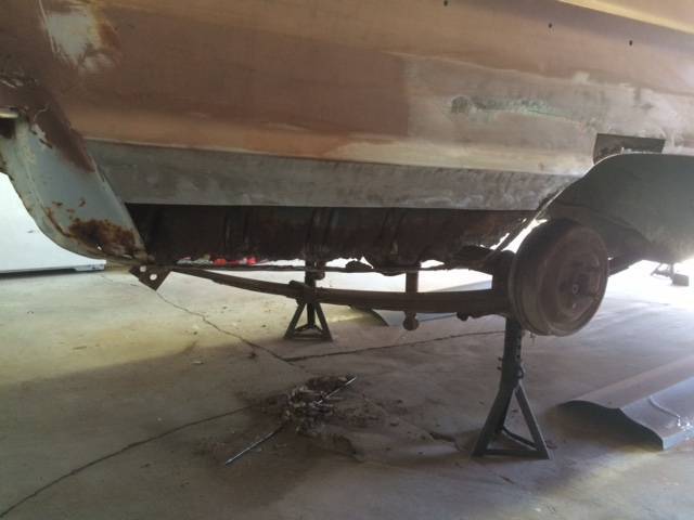

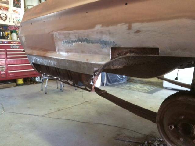

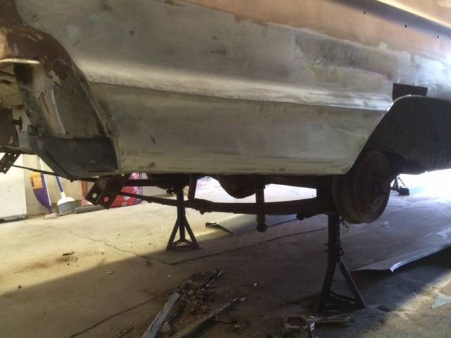

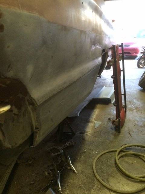

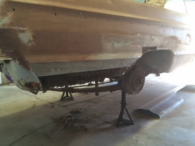

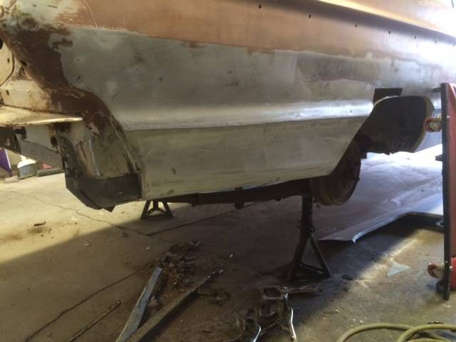

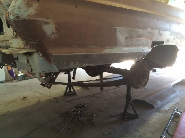

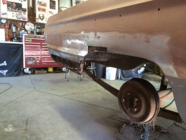

Just a little update for you all so you know i still working on her. Bought the patch panels for the quarters a week or so ago. been trying to get the passager side on and fit. As far as patch panels go they are not the best i've ever used or bought but think they are still better then a flat piece of metal. Here is some pics for ya!
Now for what i did... I had to replace the drop off in the trunk so i used some of the patch panel that i was not going to used as the patch. got it welded in and let it straight. i used the lower original lip as a guide to know were to make the lip at. Then i split the quarter at body line left about a 1/4" below to weld to. I like to split at body lines cause they don't warp when welding. Got it al welded in then made the very rear patch.
Thanks guys! i started on the passanger side because it wasn't as bad as the drivers side. I like to keep as much original metal there as i can.lol! Once i pull that crease i will patch the spot above the wheel well. And show you all how it turns out!

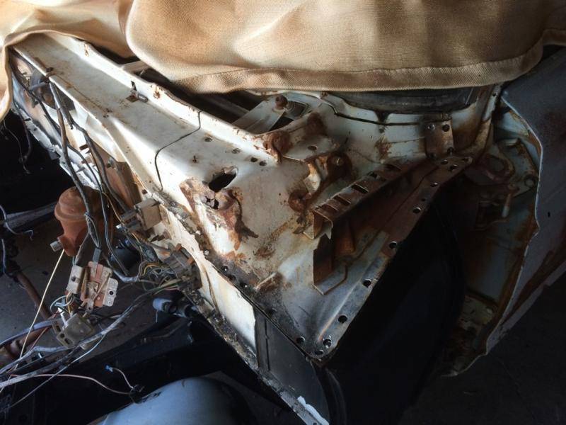

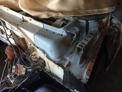

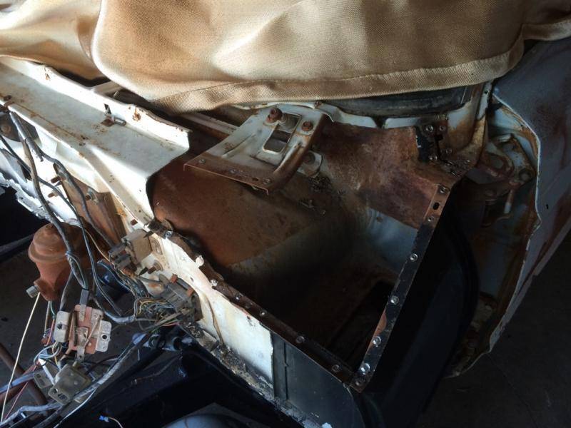

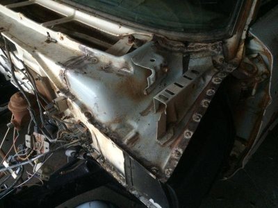

Done some more work to the 65 fury III after i was finaly able to get it back in the garage after all this rain.
I still have to grind welds down but thought it fit pretty good need to put the hood spring/bar braket on still. Next spot to get to work on will be Left quarter. But ill probably get front end put back on first. Make sure it well line up and fit right.
