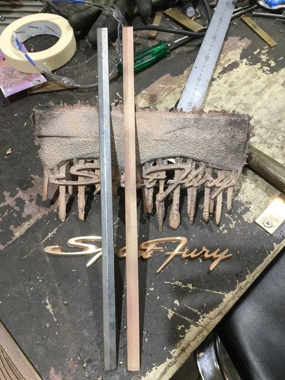

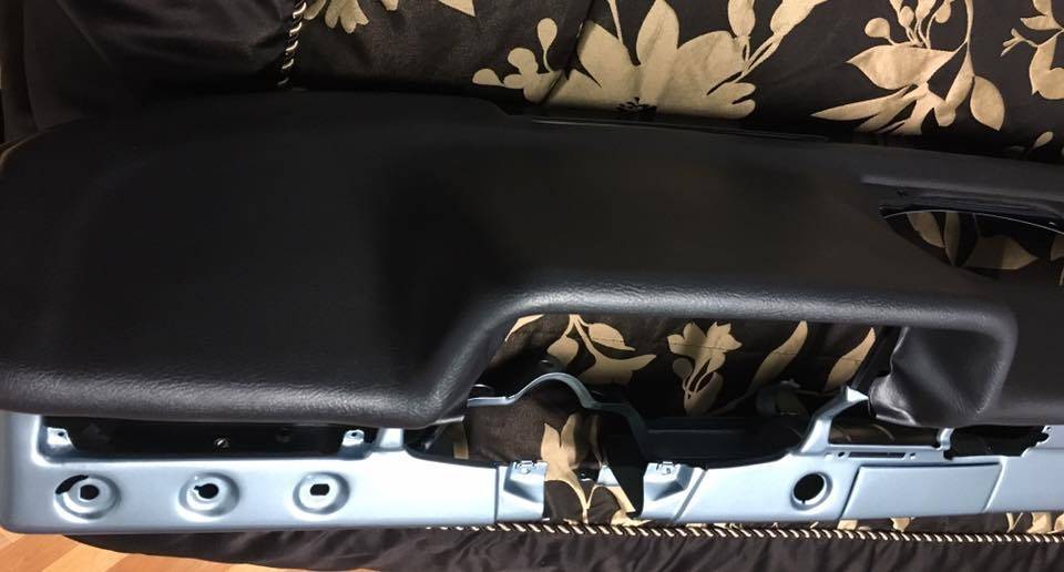

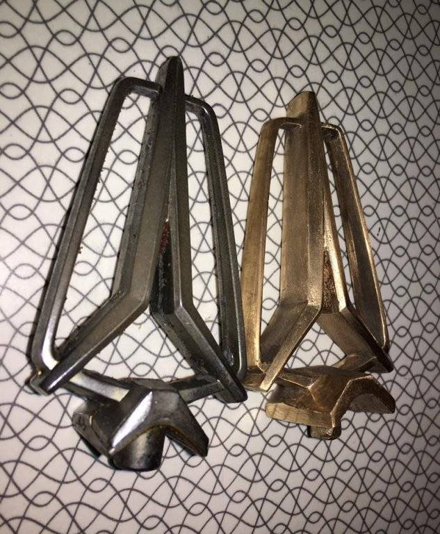

Little bit more progress. Received my new dash pad which looks stunning. Also finished my hood emblem, just need to send it to the platers.

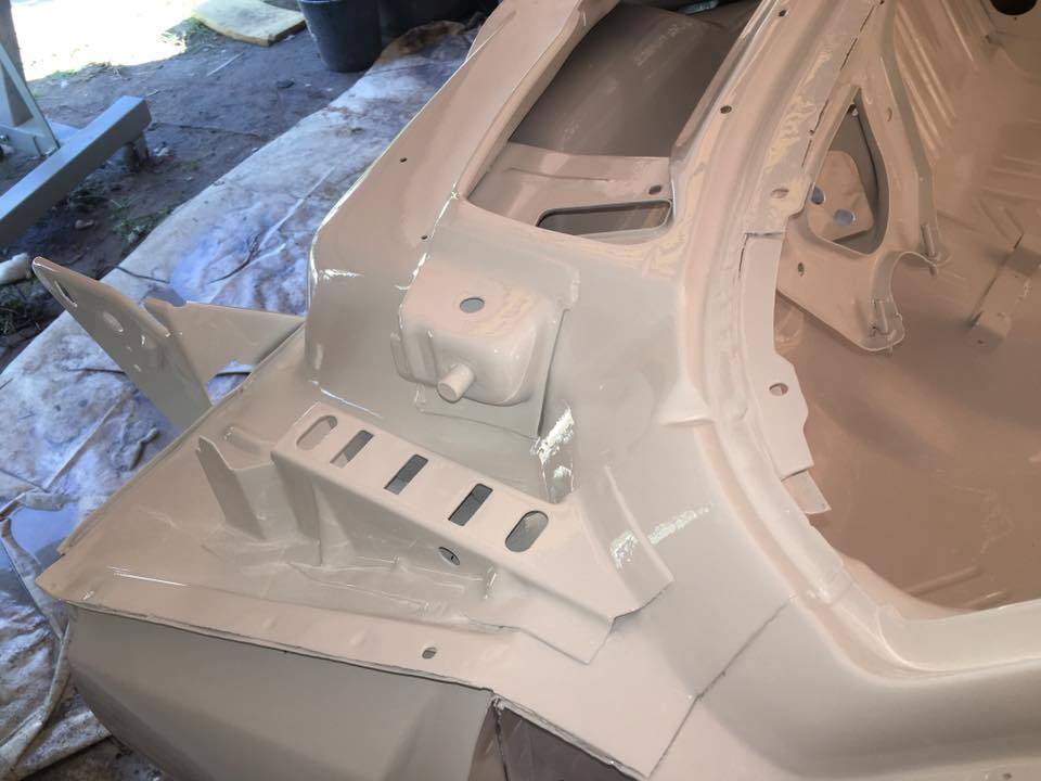

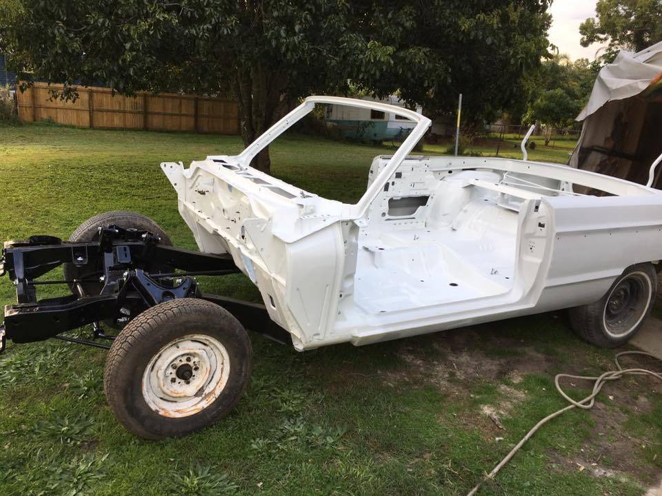

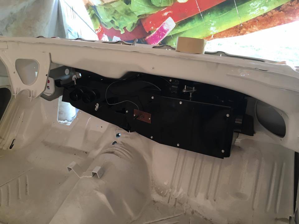

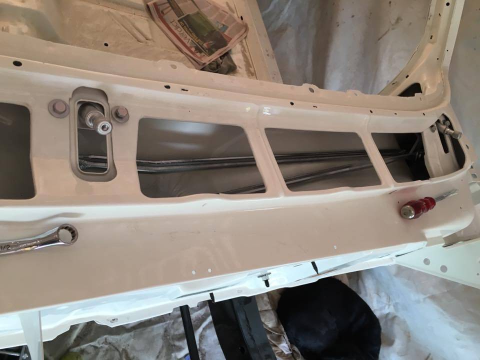

little bit of progress. finally have the front wheels on so I can roll it around. The heater took over 8 hours to disassemble and restore. Wiper mechanism was also stuffed and had to make a good one out of about 4 separate ones I had collected. The fuel tank I have just started. I have 3 good ones but all with dents. I decided to split the worst one and fix it.

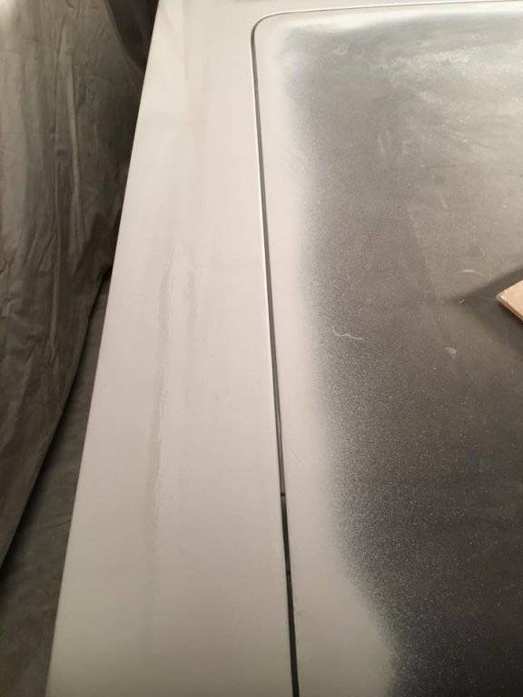

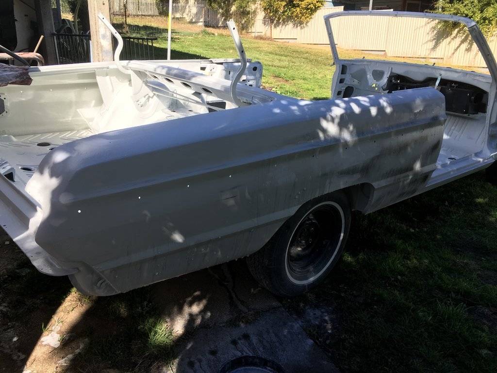

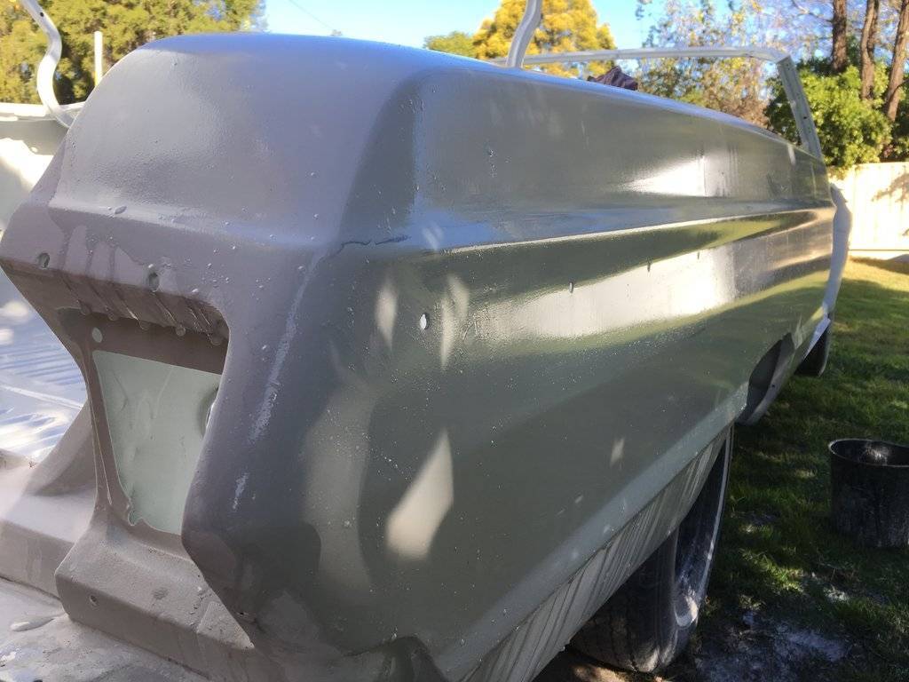

managed to get a couple of hours free to give the quarters a block sand this weekend. Slow progress but still moving forward.
Incredible work! Somehow I've missed this thread. Kudos to you and I hope everyone is doing better.
