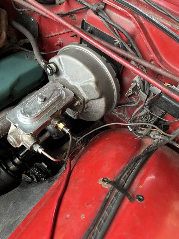

Think I figured out the issue! Turns out this isn’t the original booster and it’s actually for a 66 Chrysler with disc brakes! Just going to convert it back to a single line since it’s near impossible to find the correct booster.
No. That is not a disc brake booster. It looks just like the original on my ‘66 300, which was originally drum/drum and has been in the family since 1978.

Hmmm... you already have the correct master for the MUCH SAFER dual circuit system.
Look harder for a drum booster - but FIRST, correct the plumbing issues described with the routing, check the flex hoses front and rear (they can fail internally), check the shoe adjustments, and see if that booster doesn't work just fine before trying to replace it. You might find that you're brakes start working splendidly!
While I do not have any experience of using a disc booster on a drum system system, I have heard it works OK. There's no reason why it shouldn't work - it just might be a bit touchier, which is something you can get used to. On the other hand it just might be overboosted and call overboosted and cause other problems. It's worth a shot to find out... fix the other issues first.
I have put disc booster on drum system and what happens is that it works great, with further-reduced pedal effort.
