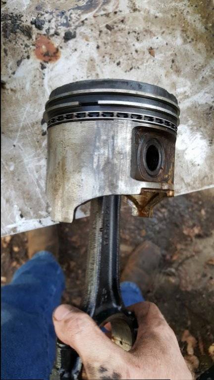

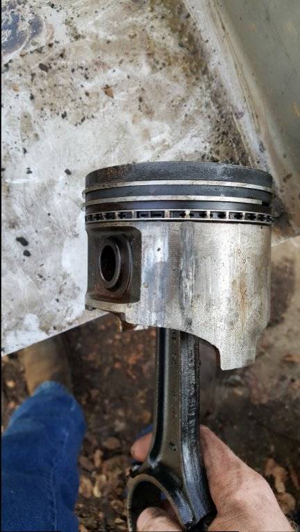

Its in the middle of the bore half way between tdc and bdc id say everything else moves a good 1/8" when you reverse the crank. The pistons are real sloppy in the bore too. Engine had serious blow by when it ran.
Two rod bearings were completely missing and heres the pistons on the other end of those rods.
Looks like someone ran the car with little or no oil in it. Also looks like yer gonna need a set of rods too. . . Aaaarrrgghh!
