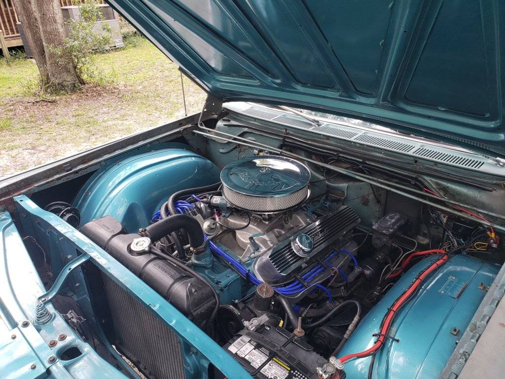

Looking for recommendations on a fan shroud. Car runs fine but tends to get hot in stop and go traffic. Currently has the original 4 blade fan. Also considering a pusher fan.
A shroud would help. A 5 or 6 blade clutch fan would also help. Make sure your radiator cap holds pressure. Nice looking engine. I like those valve covers!

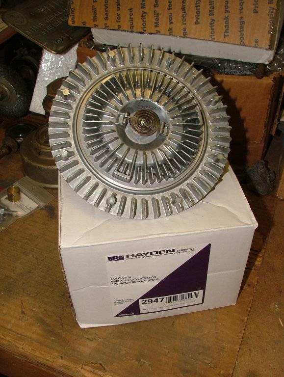

7 bladed fan largest diameter with a thermostatic controlled clutch and shroud. The fan should be no more than 1" away from the radiator core.

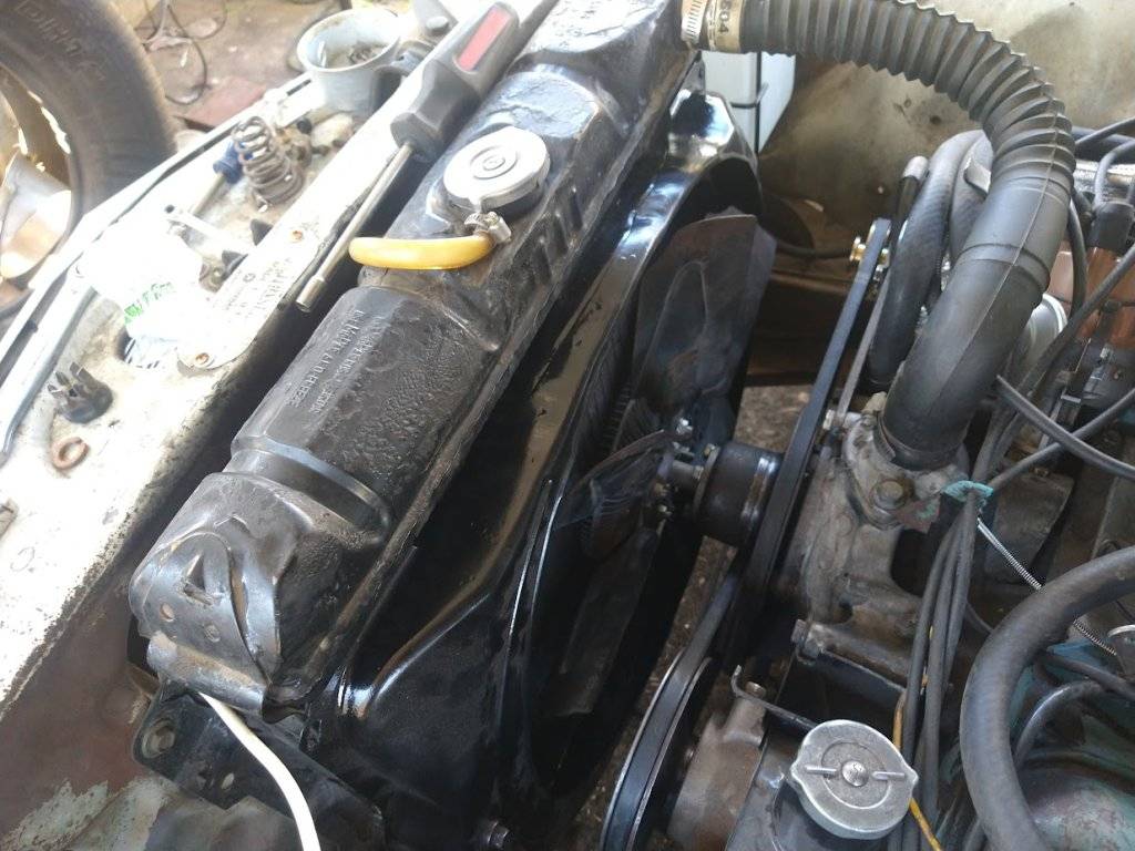

Here we go! I looked at the weather forecast for this week, and decided to go ahead and install my recently painted 1965 shroud on the 1965 radiator I'm using. Noted this morning that temperature stayed below 195 F, though in the morning cool, that's no big feat. Still, I expect the clutched 7 blade fan with the shroud meant for a 1965 Plymouth Fury and the 2524984 radiator should cool quite well, leaving the need for the 16" FFD fan for ONLY the hottest days in stalled traffic. It fit together nicely enough, though I plan to use aluminum duct tape to seal the gaps between the shroud and radiator, making for a REALLY effective shroud.
Feast your eyes on mid 1960s State of the Engine Cooling Art!

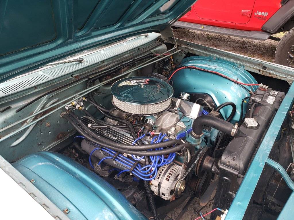

And from a side angle:
