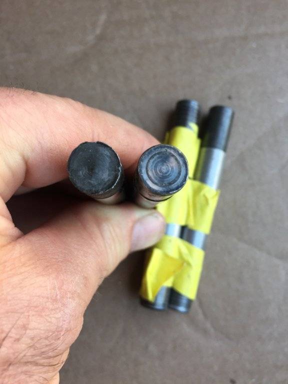

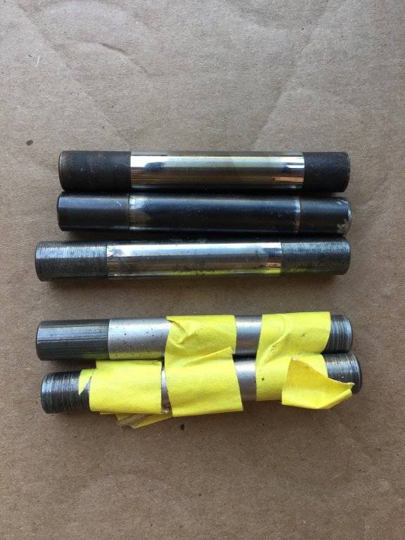

Two bad. Three good. Top was original to engine and did not like the cam swap. Second was a Comp replacement, didn't last 2 months.
The good ones are NOS pieces, that did not get installed to be wiped out. When a new cam goes in, so shall a new rod. For now I use electric pump.

Pump should br good to go, just change push rod if you see/ measure it is failing.
I just got the new pushrod for fuel pump and it measures exactly the same as the original one but I did discover that my 2 month old carter pumps shaft was loose so I bought another pump and that one is tight. Should I use the old rod or use the new one when I replace the pump?
Mystery solved it ended up being a bad brand new carter pump causing the clanking noise. There was no wear on the pushrod at all. Replaced the pump and used the original pushrod and back to cruising. Thanks for the input
