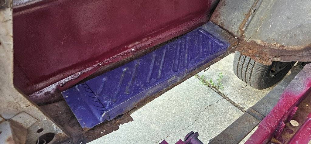

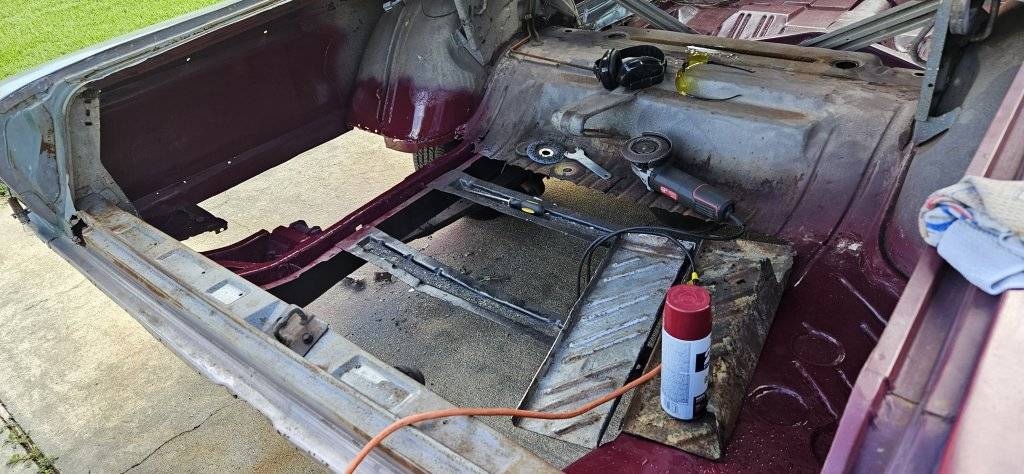

Got this panel shaped up pretty much correct now.
Ran out of time and energy today.
More removal than addition today, trying to get back to the original shape of the metal, after Bodyshop Buddy Boy made a dog's breakfast of it.
Found the original shape of the meeting face of the floor.
Made a bunch of mess. Got rained on. Need grinding and cutting wheels now.
Just needs a couple small pieces letting in. Most of the missing metal is from the bodyshop grinding, cutting and welding.

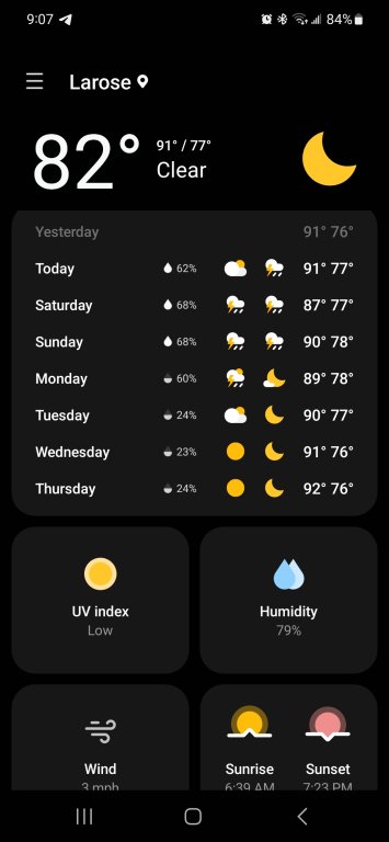

There's the rain we were forecast.
Wait. Quarter mile down the road there's no sign of any rain at all.
Needless to say that all blew north and ended up over the house here so I think I'm done for now.

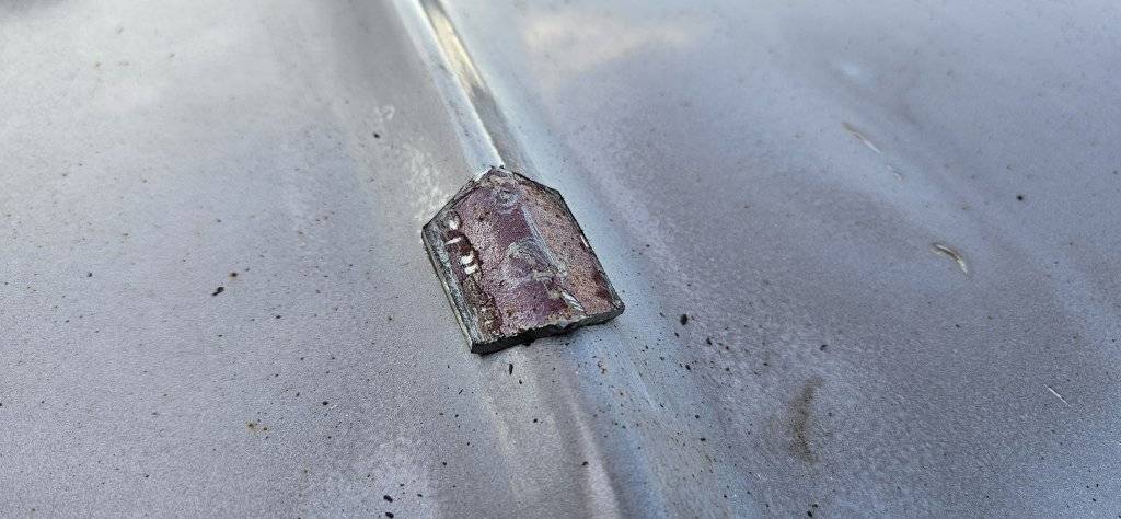

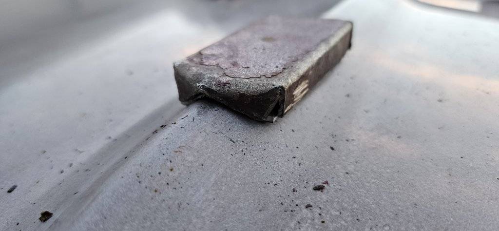

The original emblem seems to have some impurities in the metal because it all broke up and fell apart the first time I shut the hood.
Back to square one.
Not sure I understand - were you attempting to braize/weld the emblem to the new plinth? Emblem is pot metal, so incompatible that way as far as I know.

No, drilling up the center of the emblem, inserting a metal rod for strength then the same into an old bolt to give it a leg.
The emblem fractured like shortcrust pastry, it's not very pure. Thinking that's probably the reason for it breaking to begin with.

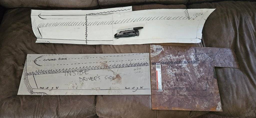

More CAD in action.
Amusingly, the factory body line stamping is about ½" longer on the driver's side than the passenger side.

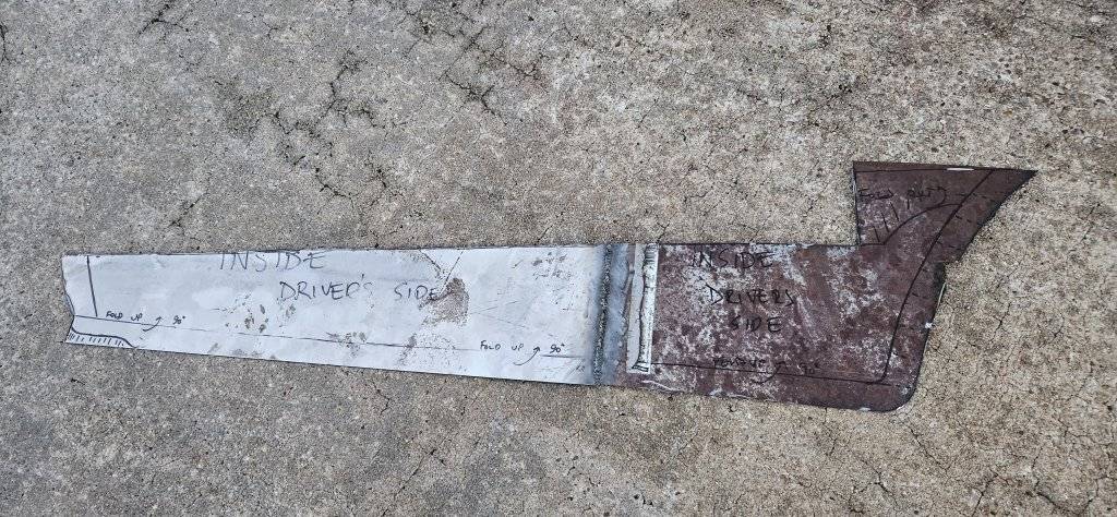

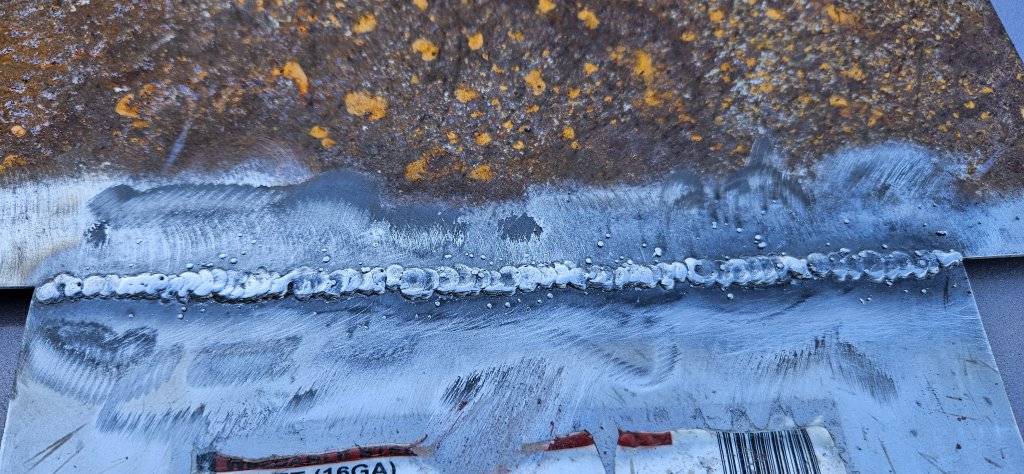

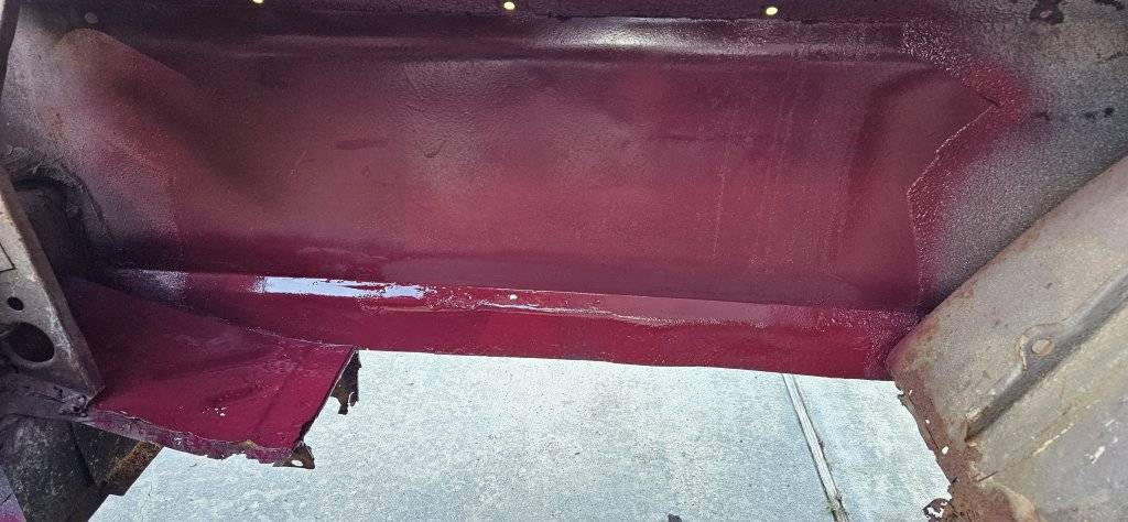

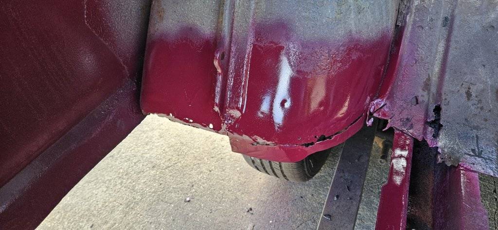

Found a few spare minutes of daylight.
Cut the panel out.
Folded the lower lip return. Now it just needs profiling correctly; once that's done I can add the arch lip return. Getting somewhere now.
Phil
