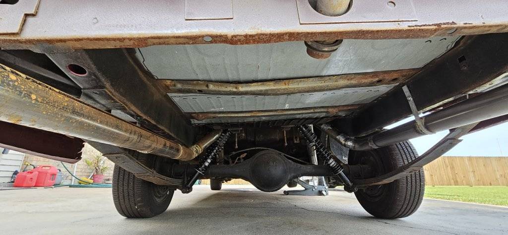

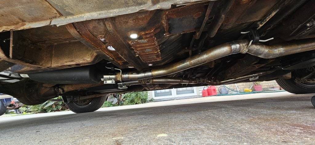

Finished the passenger side pipe up.
Not too bad overall.
Sits up underneath tidily enough.
Sounds okay, also

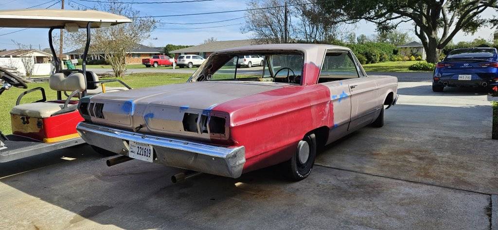

Put the rear bumper on to check the fit of the pipes. They're in the right place so that's good. I think I'll just leave them like that for now.

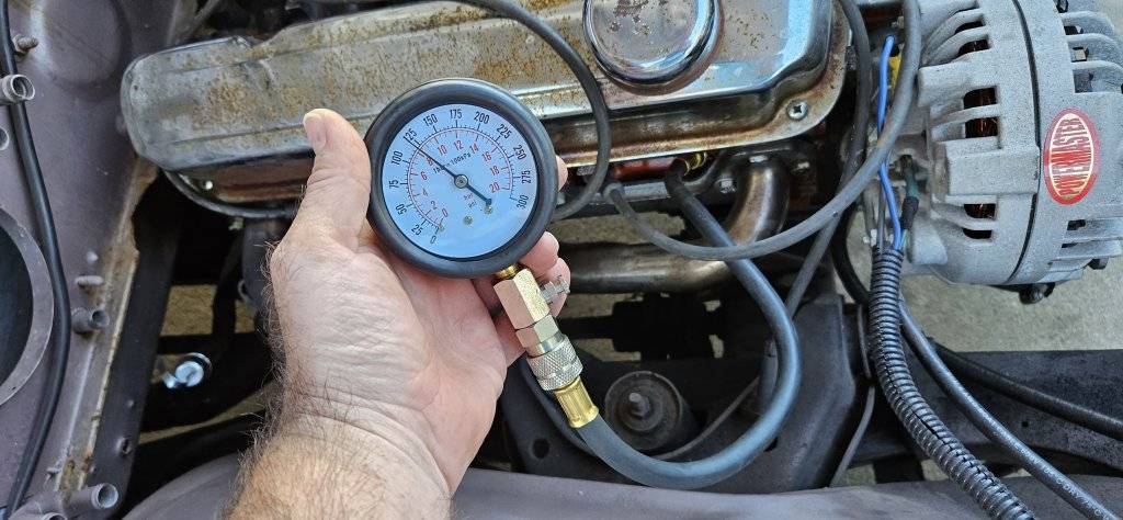

No. 2 cylinder wasn't firing well, particularly at idle.
Checked the compression. Well, not too much wrong there, nearly 125psi. Certainly enough to get it to fire at low RPM.

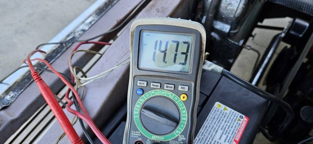

Tightened the alternator belt up, changes nicely now. That's good too.

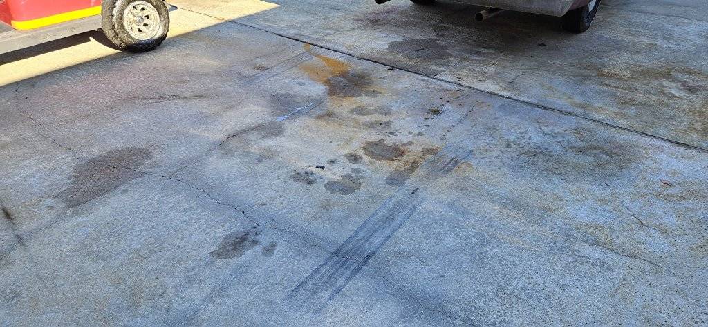

Net result, it will peel out.

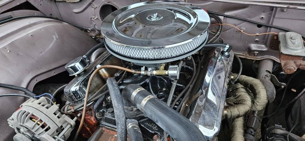

A shiny, yet functional piece.
Going to hook up a pcv system because this engine breathes a little heavily to have open top oil fillers.
