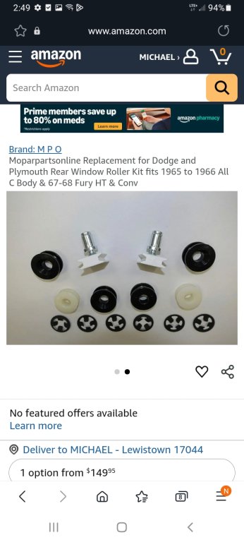

I found the kit for the back windows. I haven't had any luck with the front. Somebody was making them. I bought a kit for my 65 Monaco 3-4 years ago. I don't know if the B body kits are the same. Both Van's and Classic Industries have the B body kits available.

If you head over to Mymopar.com and look for the '66 parts book .ZIP, you will within the 1700 page download find the schematic for your car...there are many and are different for each body style and car line, but the expl;oded pix are there. I was just there looking at the Belvedere/Coronet 2D hardtops..... Don't worry, it's way easier to search those books than it sounds.
