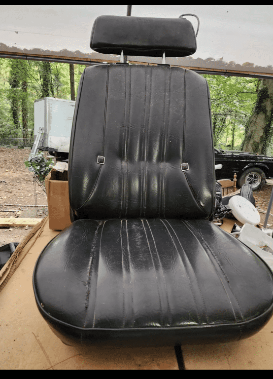

Body looks nice, but some questions on this one. Only bucket is blue, the interior is black. No console, lower class level buckets in place of the good stuff. Mismatched wheels, what else is this car not telling us? Looks close to being a fun car to cruise around in.

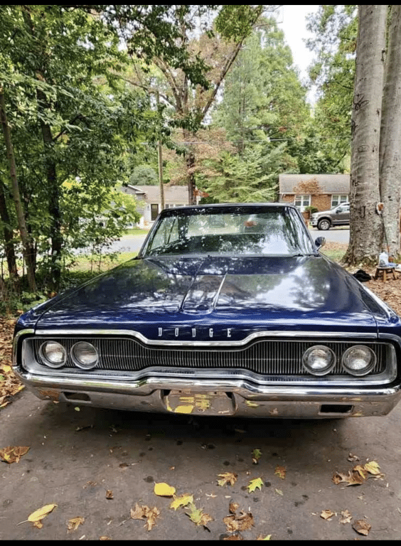

I think when you look through the steering wheel between the 2 Clocks you can see the PRND21 indicator.....??

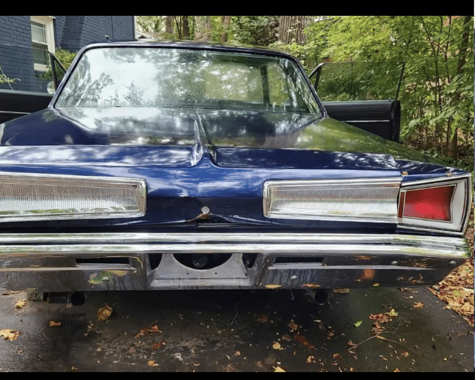

One rear marker light added only to the right quarter, none on the left, and it appears one of those large universal keys was used to open the trunk.
I think we discussed that in the 4 speed thread. I believe what you see actually says D O D G E, but can't really make it out.

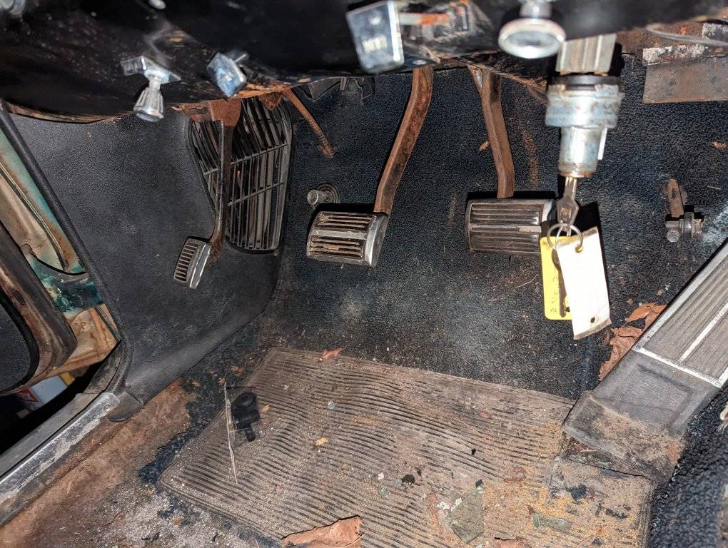

Okay, have to see the FT , but looking at the pedals ; there,s too much space between clutch and brake pedal than original........

You can see the shine where the metal of the clutch pedal has been foot-polished because it is missing the pad.
And this car has a brake booster, and IIRC the clutch pedal on those will be further from the brake pedal.

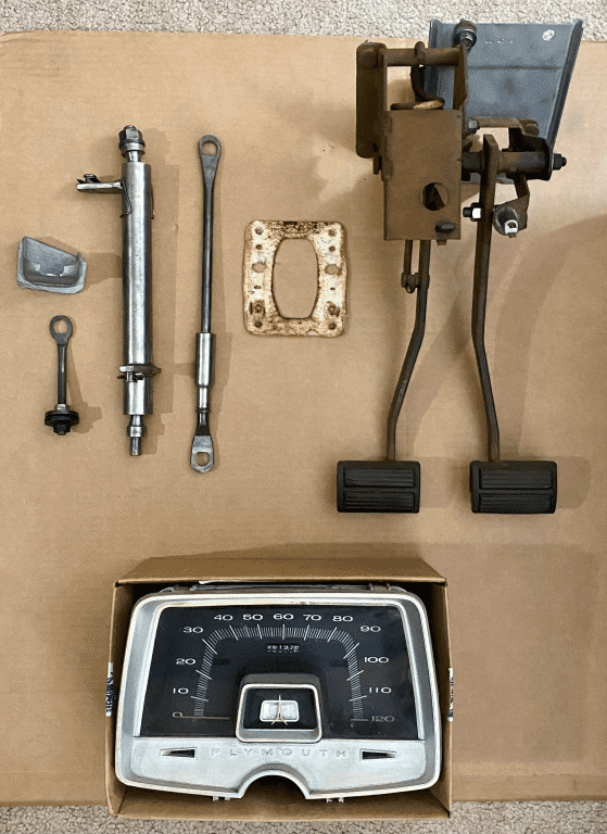

The pedals you have pictured are from a manual-brake car, and those pedals are the same length and sit beside each other when installed.
The P-brake cars have the brake pedal mounted a bit higher and IIRC that makes it look higher and/or closer to the floor.

And the bondo'd-over C-pillar and missing rear window trim is a big red flag for sure.

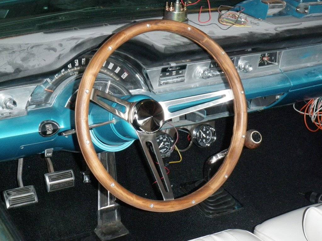

Here's my pedals in my Monaco. Brake pedal is level with clutch pedal when in its correct position.
You have manual brakes, correct?
I cannot show my car's pedals for reference, as I have a booster attached to MB pedals, and don't remember if that skewed their relationship to each other.
I have power brakes. I'll try to grab a better picture.
Here's a few shots. But some pedal is not on the floor, it's where it should be. Clutch pedal is out more, to wards the drivers seat. Factory '66 Canadian Monaco.
