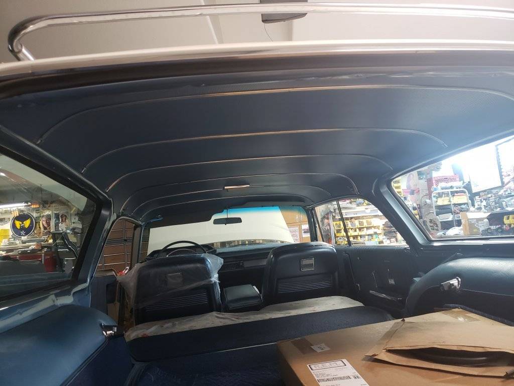

Yes, Ross, I did have 2 cloth headliners custom made by an expert upholstery guy in CA.
One was on my 1969 Chrysler Town & Country wagon and the other was for my 1973 Dodge Coronet Crestwood station wagon.
I hate the original perforated pressed cardboard headliners and although I am usually a strict original guy, not so in these two cases since I truly can't stand the original cheap stuff Chrysler used - it just won't last and I don't even like the look.
For my T&C, I used Murray Park to provide me with the front and rear compartment dome light and mounts from a 1972 or 73 C body wagon that used a cloth headliner in those models and then I mounted them both in my T&C wagon which wasn't hard to improvise. Then I had my body/paint guy make a sawtooth mounting strip at the rear of the roof inside so that the cloth headliner would attach securely at the rear, just like they all have present (even on my 69) for the front window. Then I removed the front mounting strips (and threw them out) for the hardboard headliner on both sides of the inside roof rails but left the mounting strips in the rear roof rails so the headliner could be glued on the sides to that strip and then the interior moldings would cover that area. Now my wagon looks exactly like a 1972-3 model wagon and I couldn't be more pleased. The upholstery guy I used just made up the headliner from scratch and he did a great job.
For my coronet wagon, I just used the circular dome light from my wagon and mounted it in the front on the existing crossover and made up a mount for the one from my wagon for the rear out of sheet steel (my body/paint guy just made one up that would work) plus also a sawtooth steel strip for mounting the headliner at the rear of the interior roof (use the finish molding to determine where to place that strip should go so it won't be seen when done). I also, just like for the Chrysler, removed the roof rail strips that are used to mount the ends of the hardboard - but left the rear in place to which the cloth headliner could be glued just as in the Chrysler). Then the upholstery guy made up a complete headliner and installed that one too from scratch. I have personally never seen a B body wagon of that era or even earlier with a cloth headliner. I chose a perforated off white vinyl headliner material that looks very much like the original hardboard when installed and at first glance no one would even think about the headliner when first getting inside that wagon until one realizes it had been modified to cloth. I used the original sun visors too, which were also off white to somewhat match the light gray hardboard headliners in those models.
Not having to ever deal with a hardboard headliner again was a big relief. It was one of the worst cost decisions Chrysler ever made and they carried that junk over for decades beginning with the 50s.
Just make sure the guy you use to do this work has some experience in doing headliners - the guy I used has over 30 years, but it isn't rocket science either.
Each install including the cost of the headliner and bow kits and installation was $600 each.

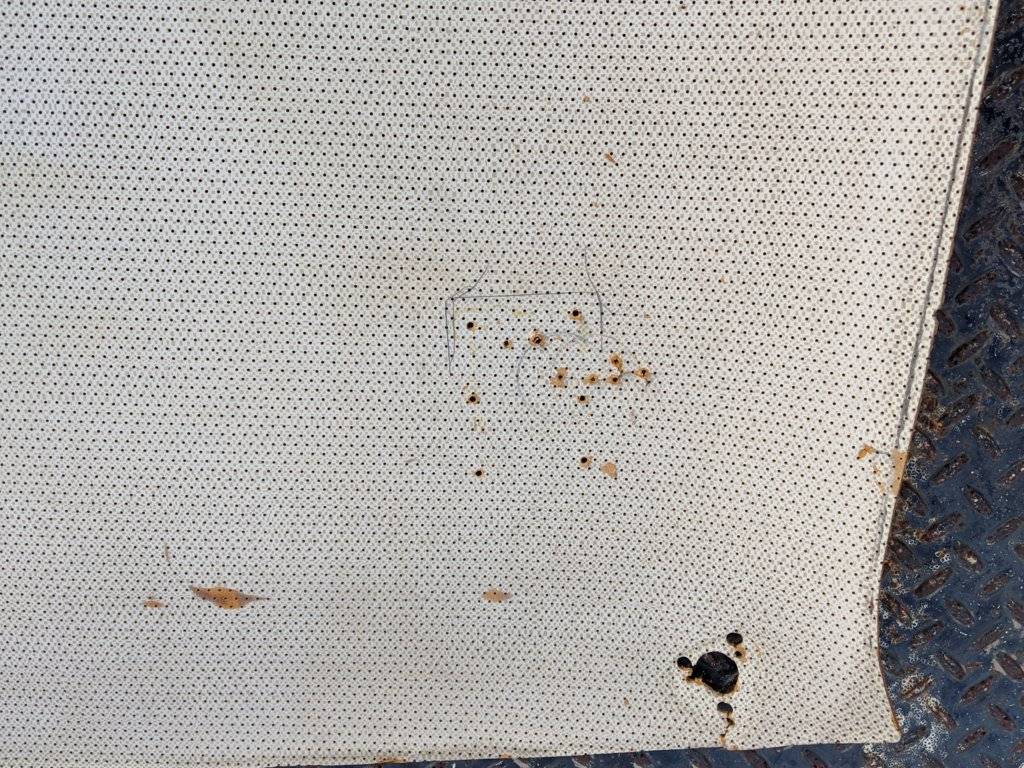

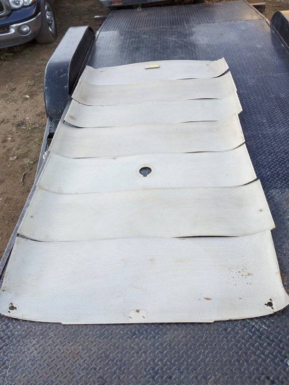

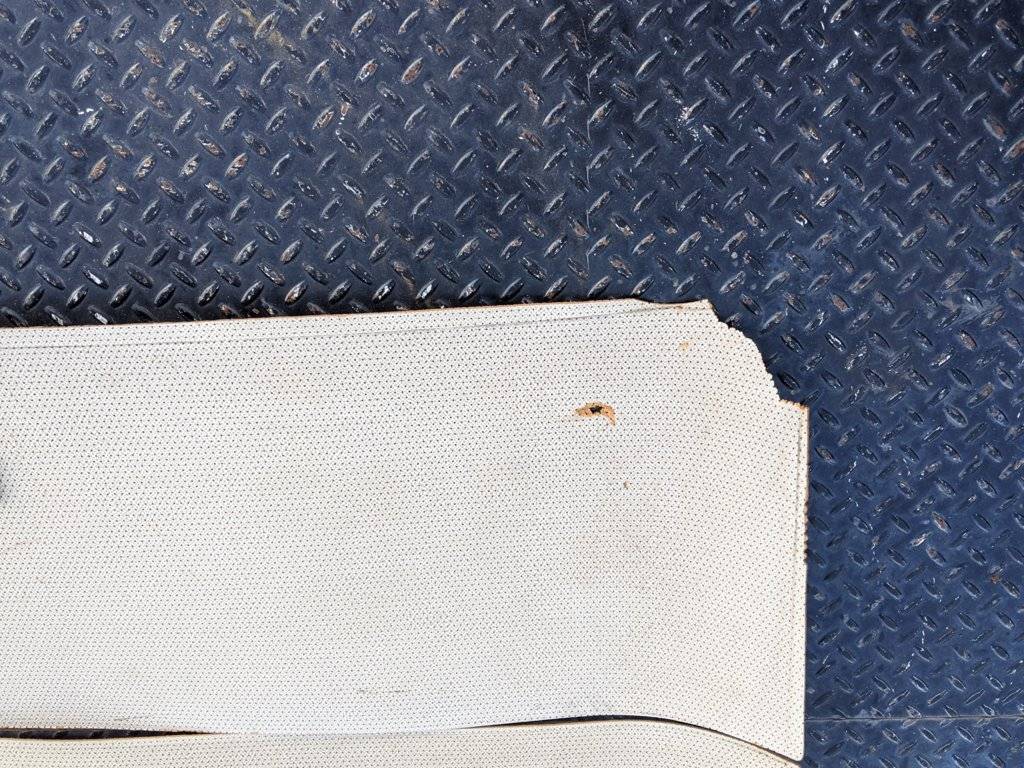

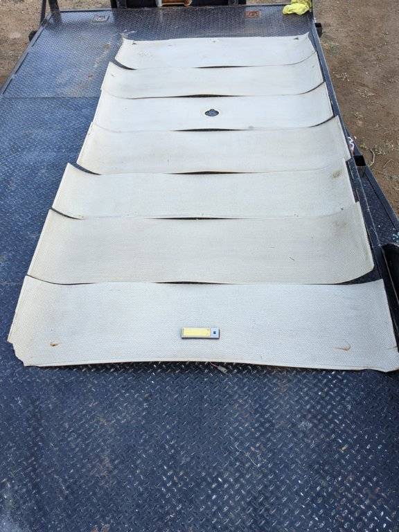

Rem has the raw material already available. They just need patterns to make the correct panels
@QQE - are you asking for individuals to supply the headliner boards so REM can reproduce them ?
I have a complete set from a 1960 Dodge station wagon that would be open to loaning in order to have new ones made available for everyone.

They already have these , I sent the set from my 64 880 to them.
