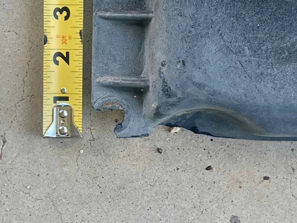

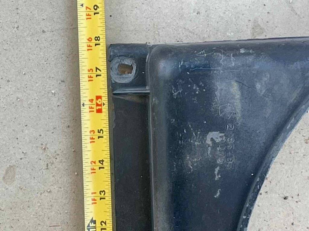

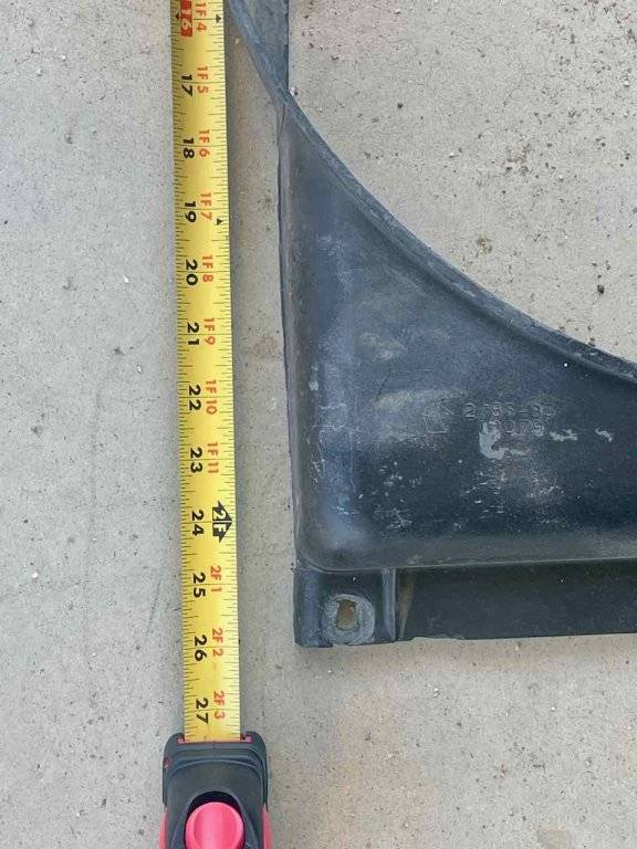

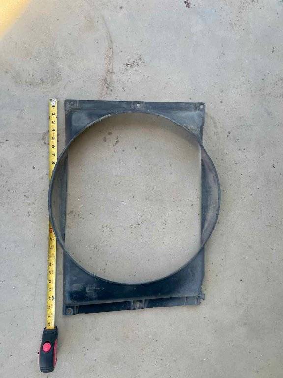

If its the same OE shroud I have on my 66 fury I have an extra one in good shape. I can send pics with measurements if interested, and you can have for whatever the cost of shipping and a box is.
a little dirty from sitting in storage and one of the corner mount locations is split but will still mount fine with a washer under the nut.
I'm in Glendale which is the northwest metro phoenix area. That would be fine just PM me and I will give directions.
