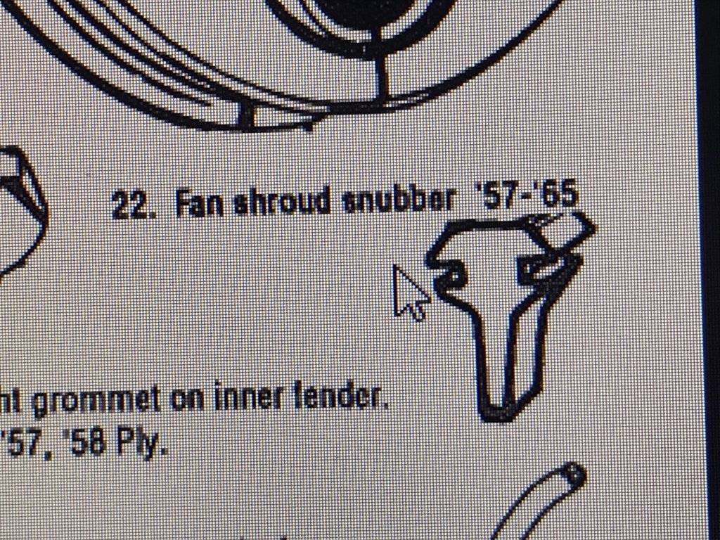

Does anyone know if the small corner bushings on the shroud are still reproduced? Or how a seal is supposed to mount? Looks like it could use one but I can’t find an image of the part #
What I came up with was this....
with the understanding my rad is 063, think this shroud was for the 053 (B body?)

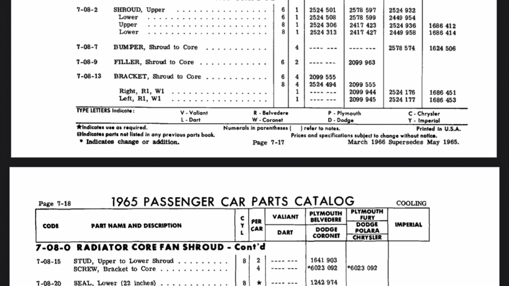

1624506 only avail from QQE as the #22 snubber bushing
Sill not sure what 2099962 and 2099963 are..... "Filler - Fan Shroud to Core, w/Air Cond., Upper .Lower"
this is from the 1965 manual. 1968 manual only shows the lower PN
anyway...there may not be seals.

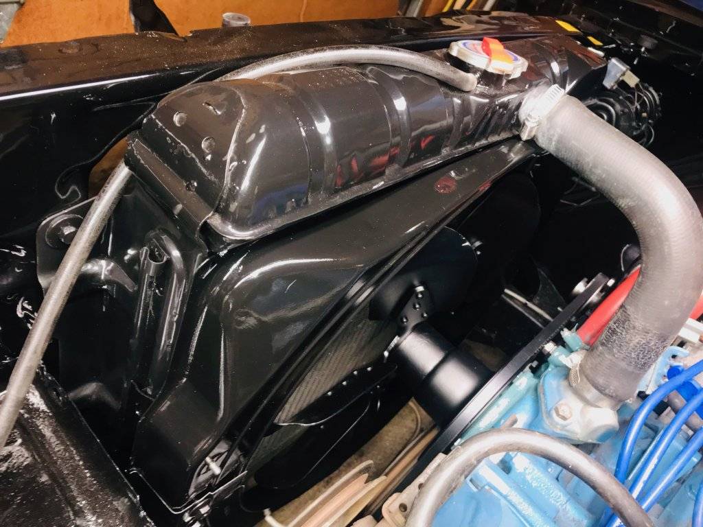

Also FYI...I've only personally seen one image in the public realm of this shroud mounted on a rad.....My experience has been ......that image
shows this shroud mounted upside down. (as in, has to be flipped or fan will hit).

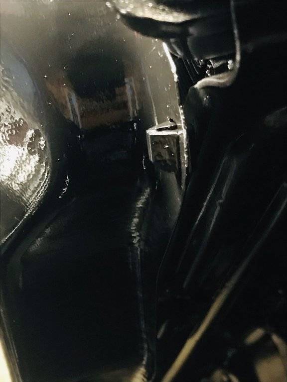

***Definitely did need the brackets shortened 0.4 inches for clearance, and bottom hole slotted for Rad bolts to fit thru brackets.
