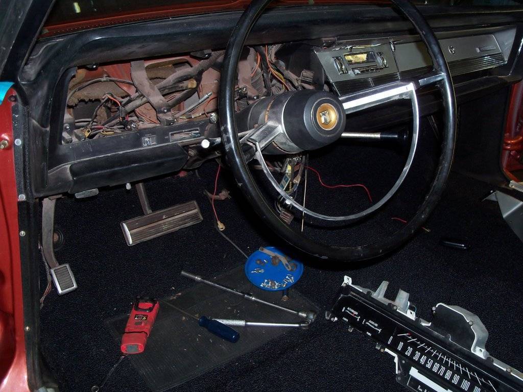

As for the dash, yes it has to come out to acsess the bulbs unless you are a contortionist or circus monkey.
You have to drop the steering column, remove upper light bar, dash bezel, undo the gear selector indicator and then the cluster.

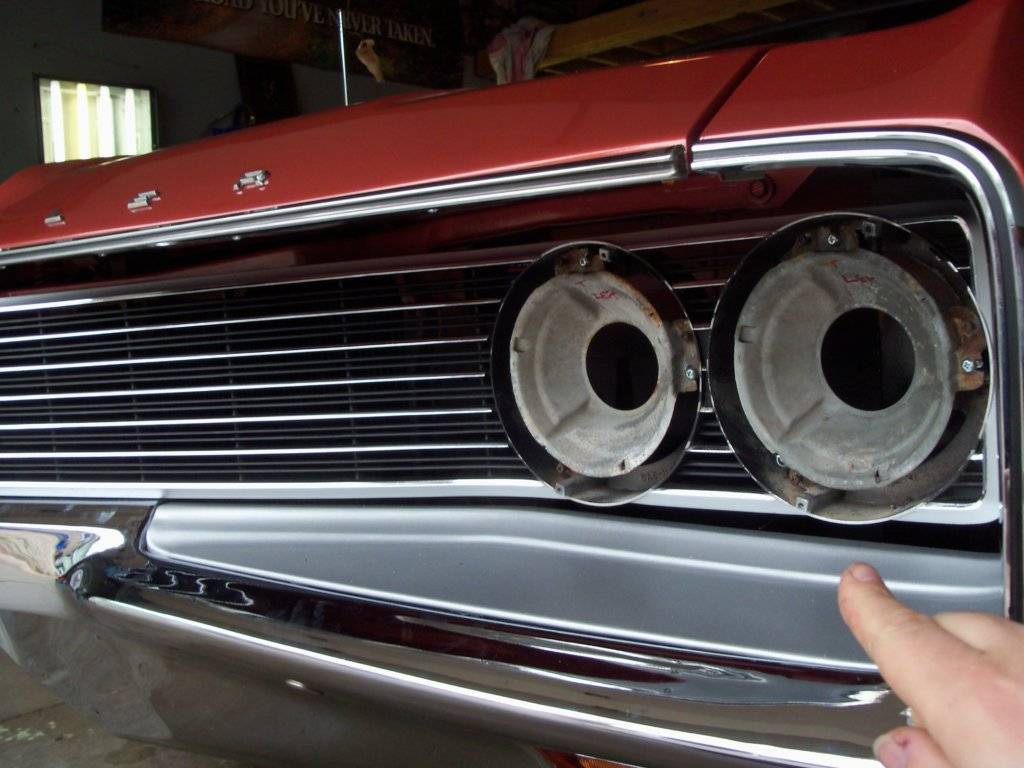

Screws are on the outside/ front of the bezels countersunk.
Please look closely at the last pic of my grille where I am pointing with my finger.
You can see the screw mounting holes at 1 o'clock and 7 o'clock.
