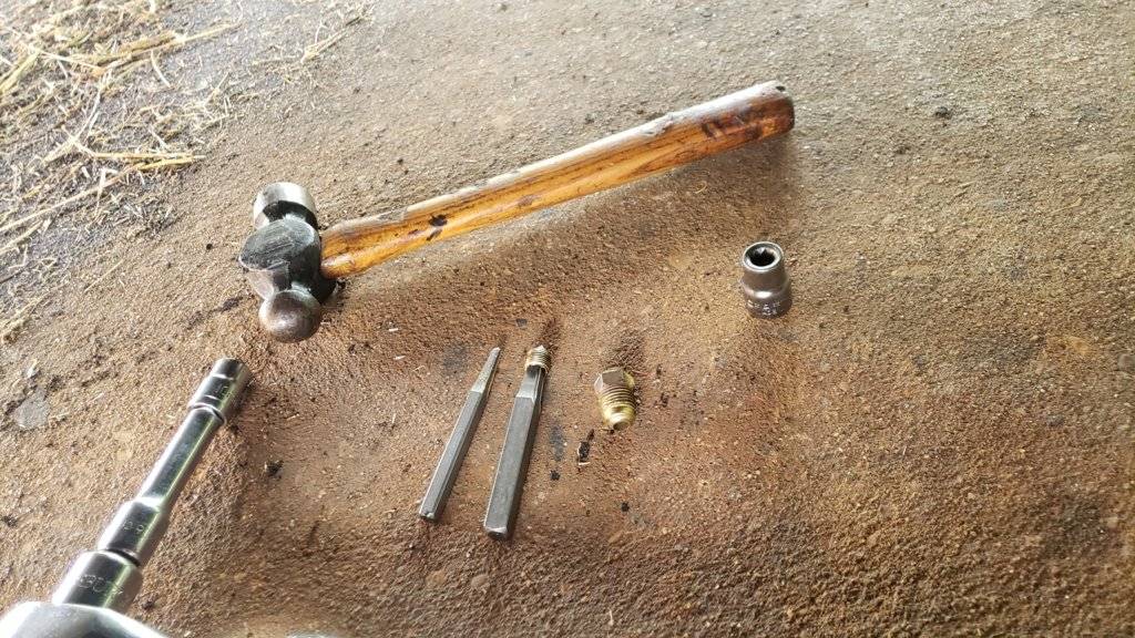

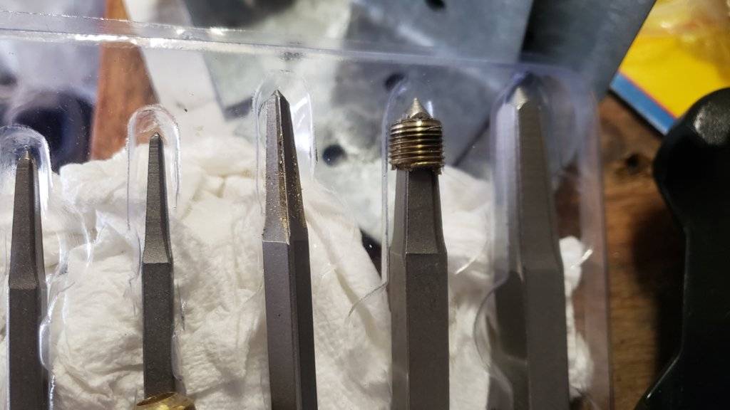

so all i have left is connect the driveshaft, and the broken transmission line fitting. then i get to try to start this thing.

what do ya think about all the brass dust and shavings? the threads look clean, but i can see some brass dust up in there. im gonna hit it with a vaccuum cleaner....
can i put compressor air thru the whole system? does that work or nah?
put fluid in it and run it for an hour then change the filter?
im headed over to summit racing to get a oiler primer stick, this stupid fitting, and the rest of the fluids i need. then i maybe will have this thing together today. maybe.

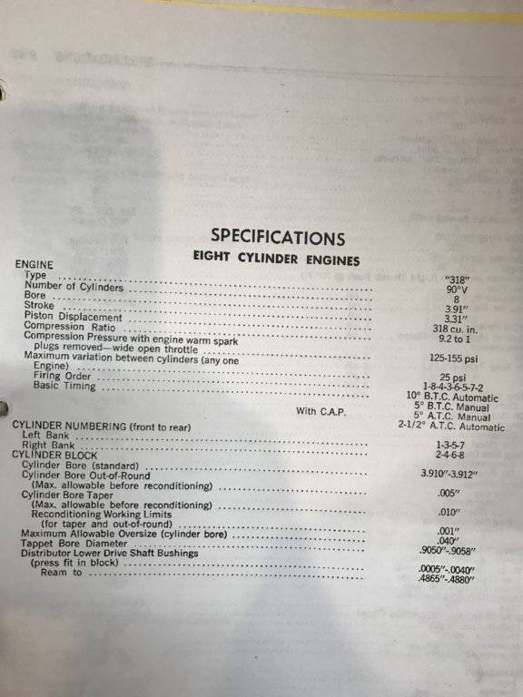

I want to reindex my distributor and timing just to triple check. is the following steps the way?
find TDC on #1cyl.
put scribed timing mark on balancer right at "0" at the timing window arrow point
stab distributor drive gear so the notch is || vertical 12/6 position.
rotor should be directly over/ pointing right at #1spark plug on rotor cap at this point.
let er rip.
is good?

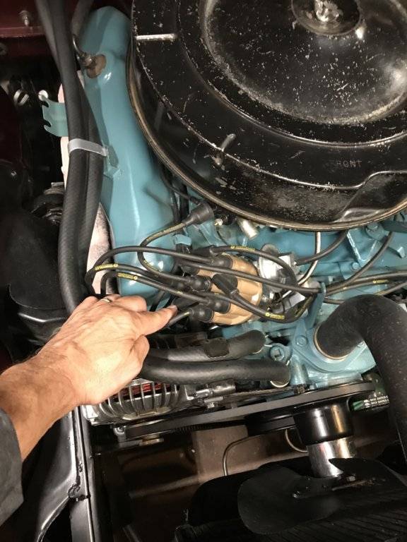

Find TDC on number 1 cylinder (left front of engine): pull spark plug from number 1. Make sure car is in park or neutral. If you are the only person you will need to jump the starter using the relay by the battery. A remote starter switch is a good inexpensive tool. Hold your finger over the plug hole creating a seal with your finger. Turn starter over until you start to feel air leak by your finger. Stop immediately. Remove your jump wire. Take a look at your harmonic balancer. You should see a scribe mark on it. If you stopped fast enough it should see it to to the left of the TDC mark on the timing chain cover. If you were too slow releasing the starter you will need to do it again or turn it by hand almost two full revolutions. Use a deep well socket and breaker bar and turn the harmonic balancer clockwise (righty tighty)so that the factory scribe line is up to your timing marks. If you think the factory scribe mark is off. Take a wire coat hanger and stick it in the hole until you feel the piston. Using your breaker bar slowly turn the engine until the wire stops moving as the piston hits TDC. Your Factory scribe mark should line up with TDC on your timing chain cover.
If not your harmonic balancer is most likely damaged, scribing a new line could be an option, but your engine will be out of balance.
Once TDC has been found check that your rotor is lined up with the number one plug wire. Remember on a big block, the distributor turns counter clockwise one revolution for every two of the engine.
Showing just after TDC. I used chalk or a paint pen to hi light the factory scribe mark.
Position of number one plug wire. Mine is timed around 7-1/2 BTC wires go counter clockwise from that point. 1-8-4-3-6-5-7–2
As far as aligning the distributor slot. It will only go two ways. Right on or 180 degrees off. Once you have it in “right” the rotor electrode should be around the 7:30 -8:00 position and aligning up with the #1 plug wire (standing directly in front. Once you think you are very close take a small marker and draw a line from your distributor to the block. This will give you a return / reference point if you over correct.
Double check your wire are in the correct order and too the correct plug hole. I even screwed this up the first time.
From the manual for reference. Take note: left bank(drivers side) odd numbers starting from front. Right side even (just like the Mopar part numbers)
