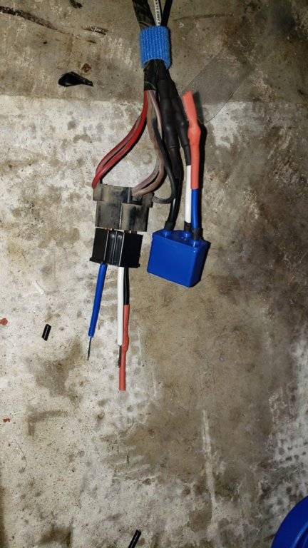

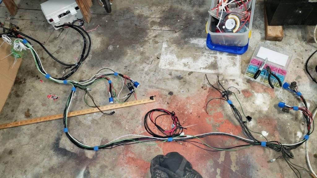

this is the male plug fitted into the original socket getting ready to terminate those ends.
even though the tails i got were 16AWG and silver wire
ground is capped off in red - ground comes from a ring terminal on down the line, even stock.
i still forged ahead. i thought about repinning them and said screw it. the male side is only trigger wires. the lousy part is 2 of my headlight sockets are 14AWG and 2 are 16AWG. unplanned. if i build more of these ill avoid this.
up near the battery / starter relay area i ended up with 6 wires. This will all tie into their respective relays:
passenger side hi lamp +
passenger side lo lamp +
driver side hi lamp +
driver side lo lamp +
lo beam trigger +
hi beam trigger +
OH DAMN I FORGOT A WIRE!!!1
no really, here it is loose, removed from mock up, held with piece electrical tape. at every T or Y in the wire, i hit it with mucho electrical tape so it wont let water in, and is super flexy. and sexy.
all the T and Y and splits are at the factory locations.
so then you get jiggy wif it. grab yo roll of badass tesa tape and wrap til your wrist pops
i dunno how to do it correctly im self taught, but i like hitting the extremities / the ones that feed off the main trunk first, work from end to trunk. at the tip ends start about 1" inwards and wrap OUT to where you want the finished edge of the tape. make a couple of loops there at the edge it makes a good stout end and clean edge, and the start of the tape is hidden under what you just wrapped. At the splits i cut about 2" over and keep going up one of the legs. then with a new piece of tape do the other leg and wrap the Y or T and keep going.
sooner or later you will run out of tape, or run out of wire, and you will be done for the evening.

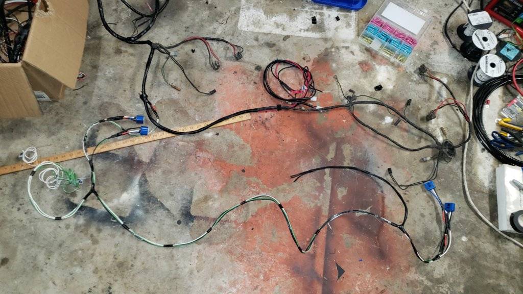

next up will be dealing with that pile of grn / wht wire in the top left corner all those relay connectos.
but pretty fly for a white guy.

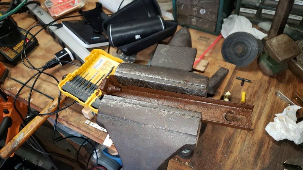

TIL a b body battery tray is not the same as a c body battery tray, but its close
but it does not fit - without modification. the underneath brackets are totally different too. its not really a good substitute.
the stock underneath bracket. rust/acid'ed solid. i have it soaking but i think its history tbh.

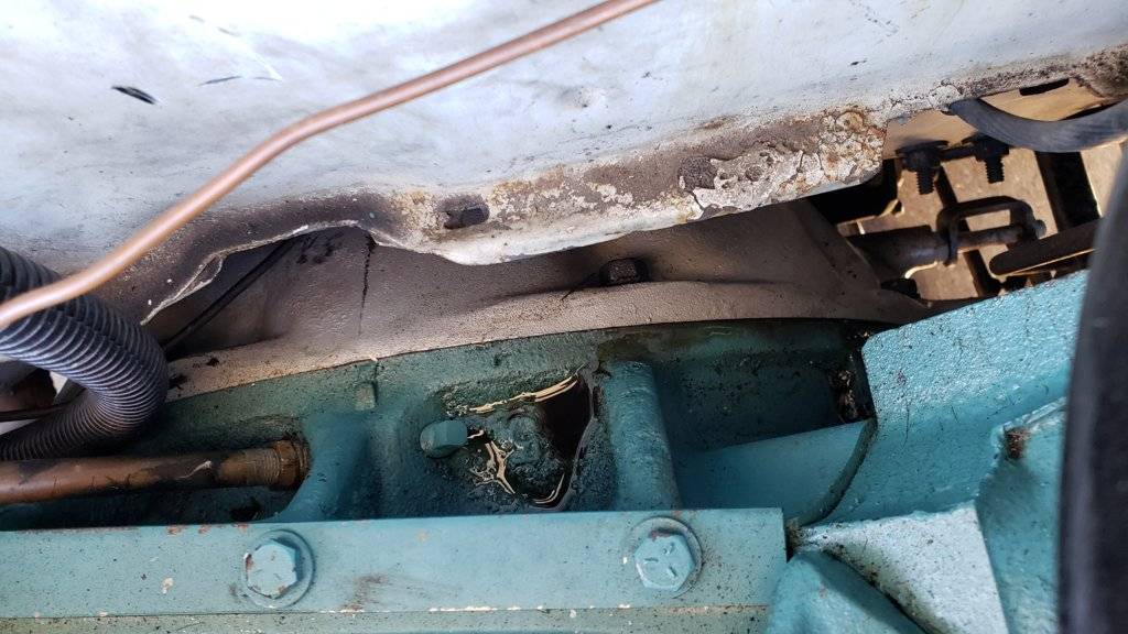

found muh oil leak
the little pipe plug at the very back of the motor where the transmission bolts up. it was hand tight :/
put some blue on it and put it back. 9mm canadian fits it.

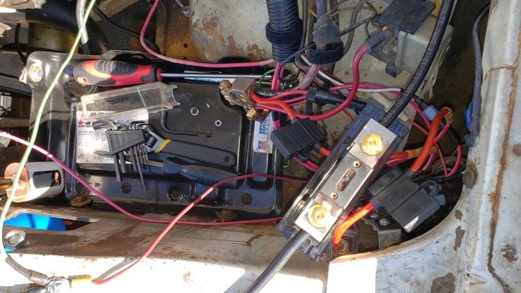

got a better handle on all the wiring
made a brace for all muh relays to ride on, mounted power distribution block, 100a fuse is under there somewhere.
