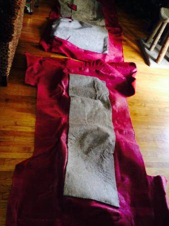

My rock auto carpet for my 69 fury just arrived. I'll post some pix when I open it up. What do you guys use for floor insulation. I'd like to save some money on this by cutting it myself since I have to replace two floor pan$. :0 Is there any inexpensive websites anyone?

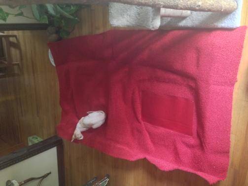

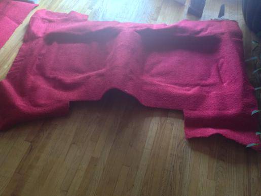

Heres my new carpet i ordered from rock auto, it was a nice surprise that it had some insulation on the back
My only comment is to not be in a hurry to trim it. Install it and walk on it poke it push on it for a few days at least. On my Barracuda I had it in for a few weeks while I did other stuff on the interior, trimming was one of the last thinks I did.
I have seen where people trimmed when they installed just to have it pull out from the sill plates.
Anther tip was to use an old solder iron from the bottom to locate the seat and belts. makes a nice clean hole that doesn't want to frey over time.
