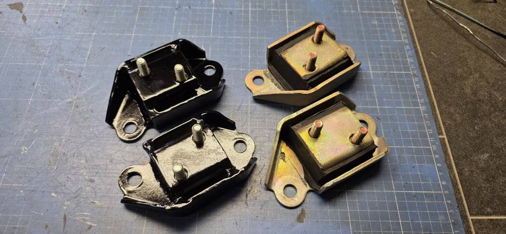

Before fitting the engine, I replaced the original suspension parts with modified parts that I had made myself.
First, I replaced the brand new rubber mounts with welded ones I made myself to prevent distortion caused by the thicker new torsion bars.
I designed new side plates, which I had laser cut from 8 mm thick steel. I then welded new bolts to the top plate and welded everything together.
I hope this finally solves the problem I had with the torsion bars touching the crossmember due to excessive distortion of the rubber.

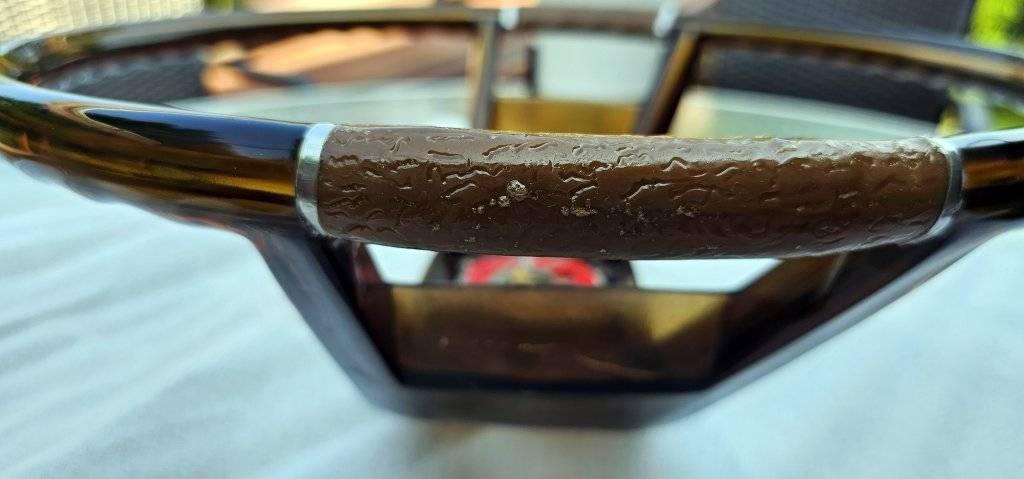

Not only were the fake wood pieces very messy, but they also did not look like wood at all.
The original for comparison:

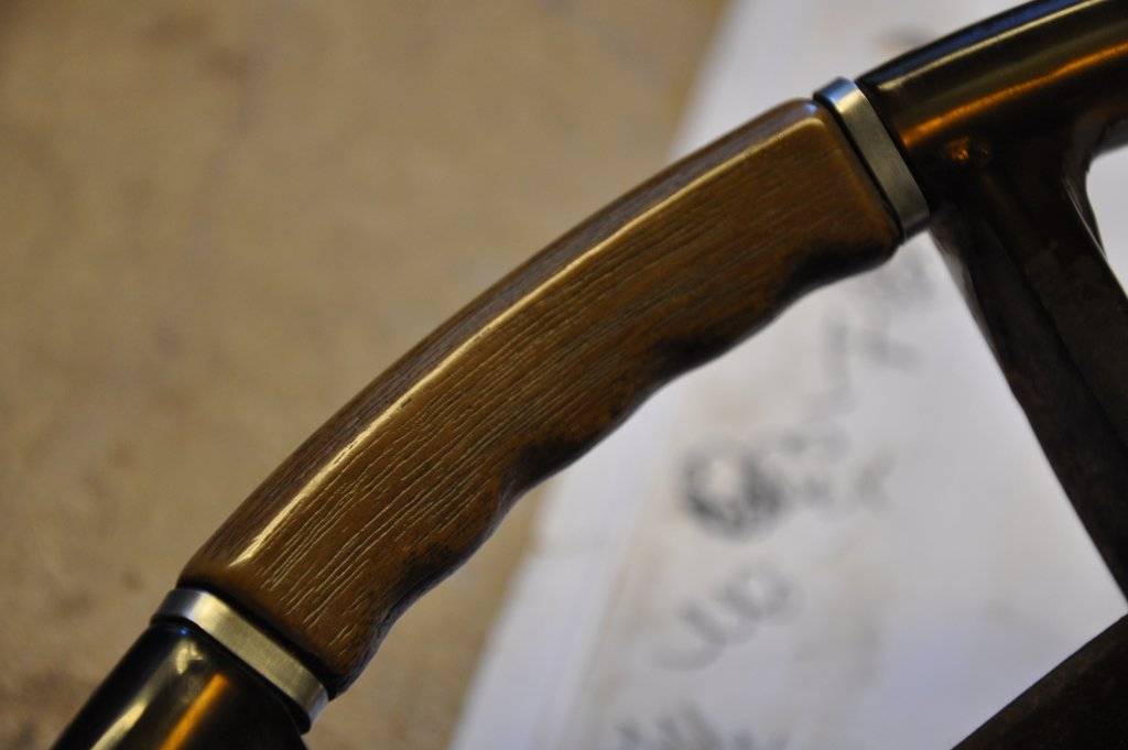

The steering wheel is still a mess — the 'wood' grips, at least, are — but I'm glad to have it back.
Thanks @tallzag for stockpiling all my packages including the steering wheel! :thankyou:
Now, I'm looking into replacing these ugly grips with real wood. Perhaps I can find someone to carve them from teak or a similar wood...

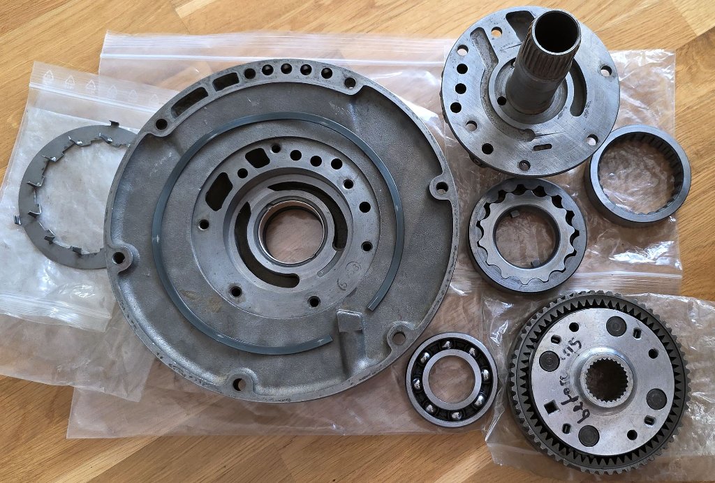

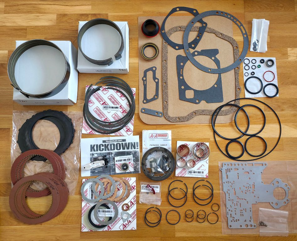

I've been collecting parts over the past month. The rust-damaged internals were the first priority. Fortunately, I found a pump, sprag race, planetary, and tailshaft bearing in excellent condition here in Germany.
All of the other parts were brand new and came from A&A Transmission, except for the valve body separator plate. My original check ball seats were worn out, so Nick reconditioned a used valve body separator plate for me.

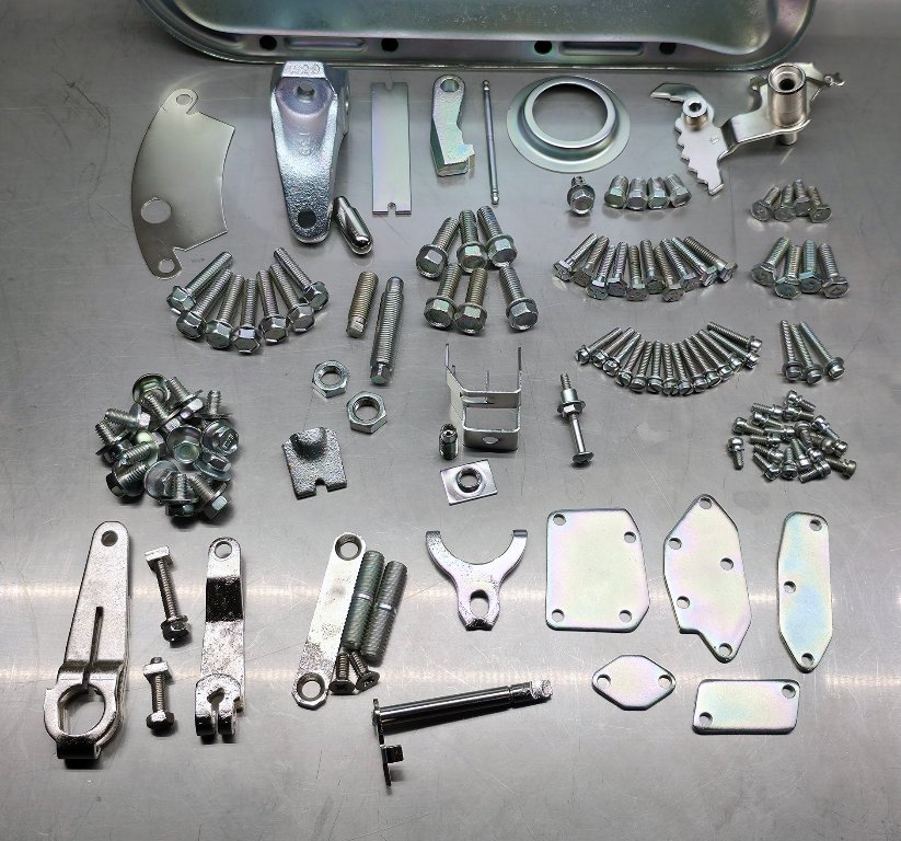

As usual, I took all the hardware and smaller parts, media blasted them, and then plated them with zinc or nickel.

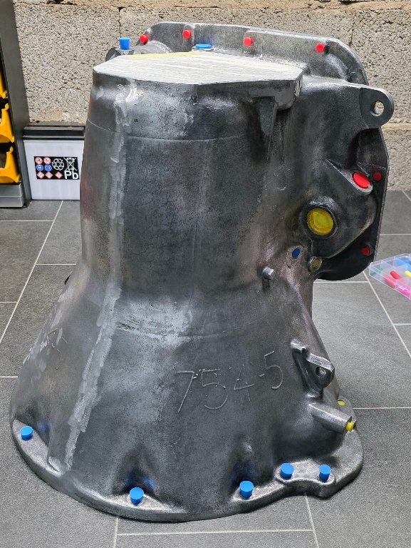

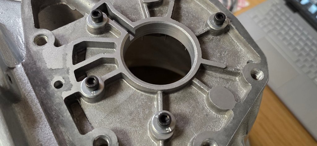

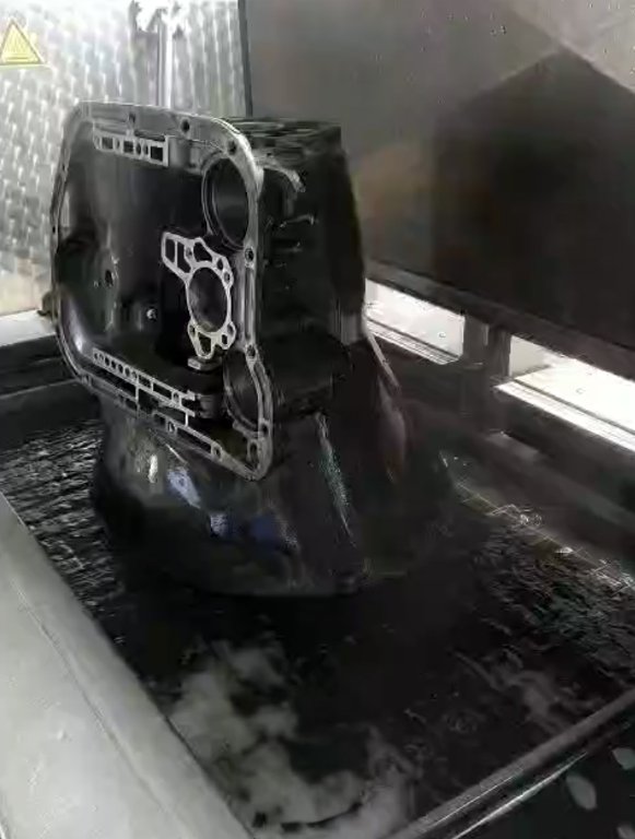

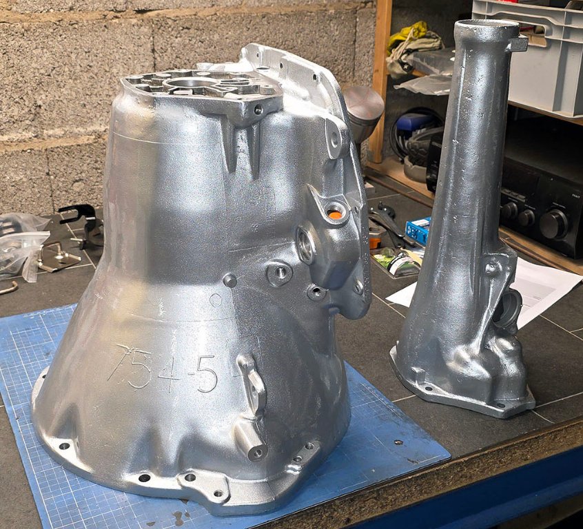

As attentive readers will recall, the case was very dirty. So I shipped it to my engine builder because he has an ultrasonic cleaner large enough to fit the entire case.
The next step was to clean all the casting flashes off the case and prepare it for painting.
Once the paint had dried, I got everything ready to start assembling the transmission.

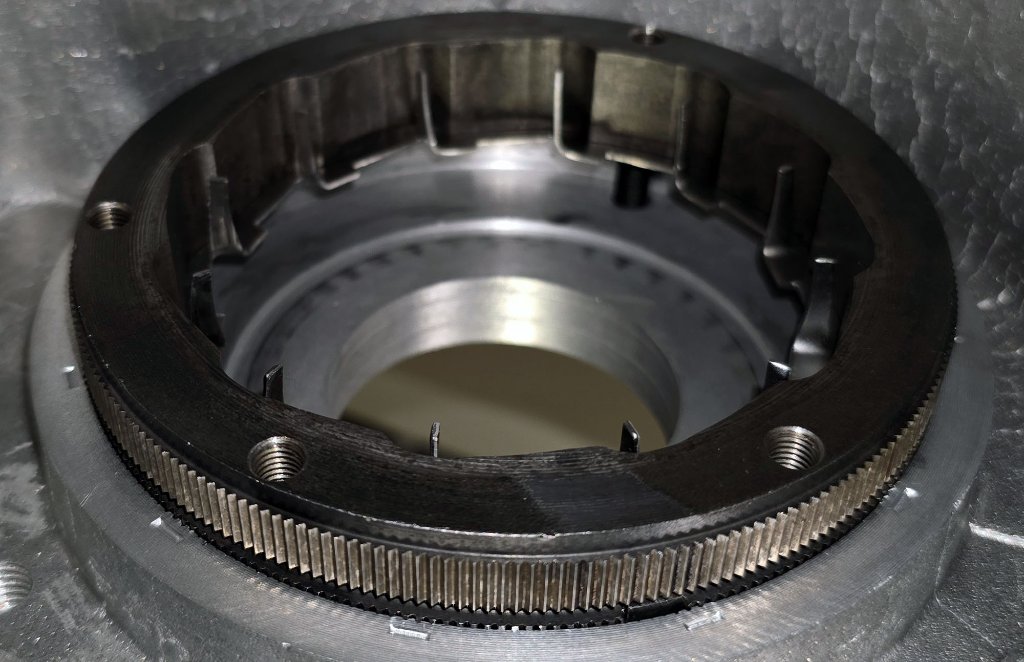

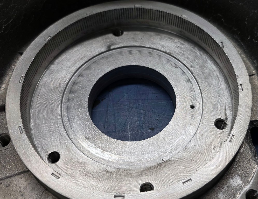

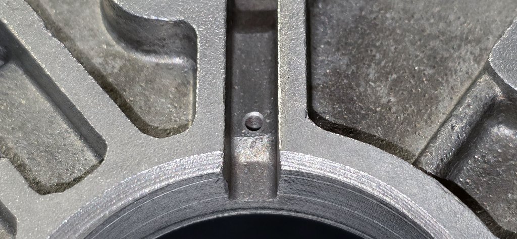

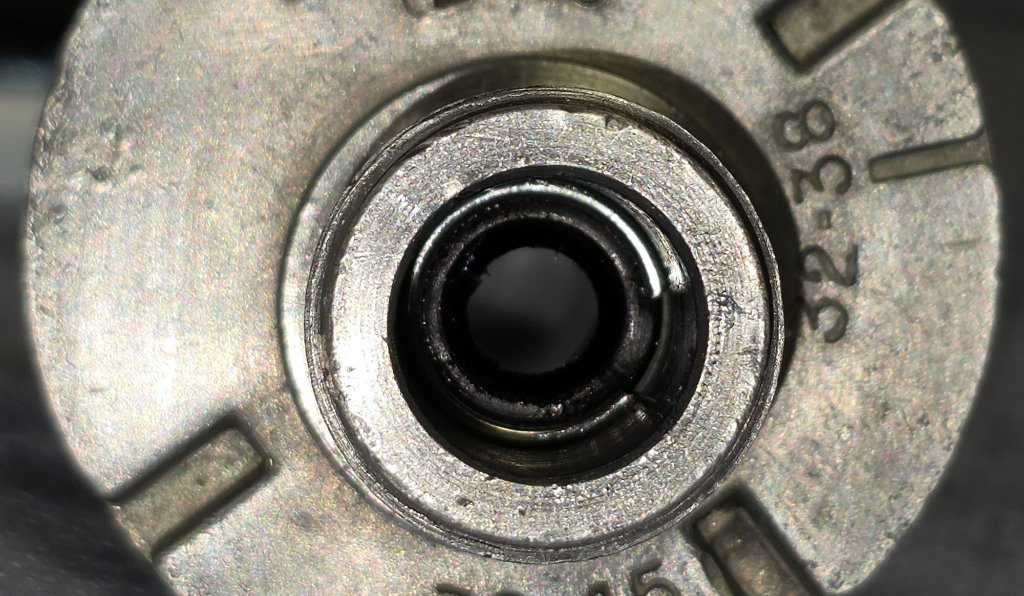

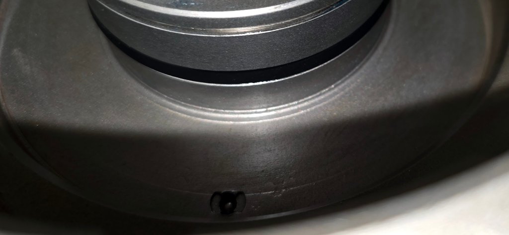

I saw a video in which John Cope recommended drilling a 1/16" hole in one of the oil passages to improve lubrication of the inner sprag race, which is only splash lubricated from the factory.

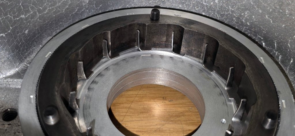

I did that, and then I installed the new bolt-in sprag.
Aaand fully seated! :)

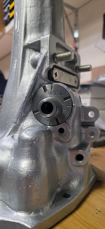

I began assembling the tailshaft first.

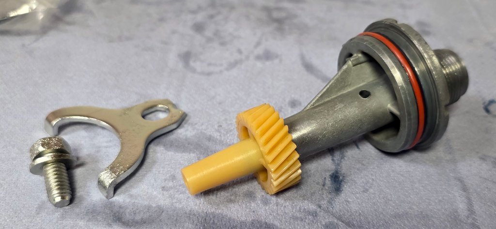

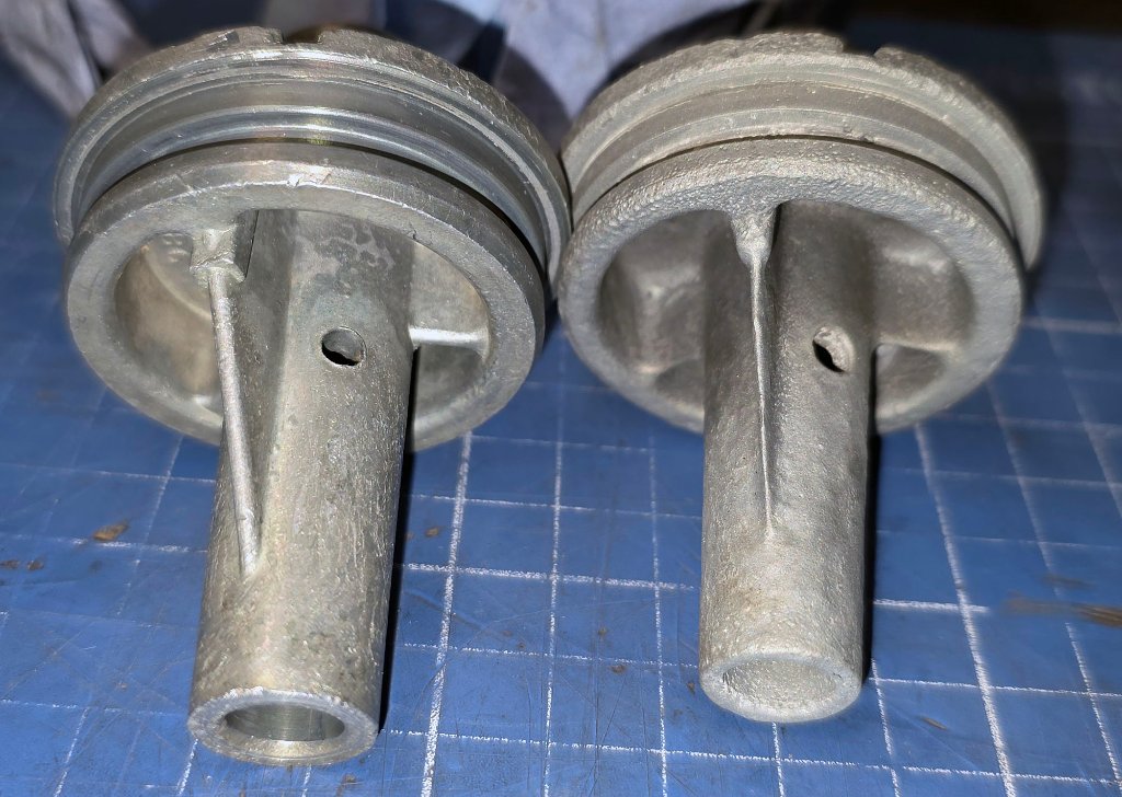

For some reason, my original speedometer pinion gear adapter was badly worn.
Luckily, I acquired a nice used one from Wildcat Auto Wrecking while I was on vacation in the US.
Check out how thin the casting is in places compared to the new-to-me one.
New seals inside and out

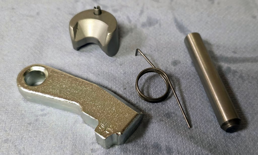

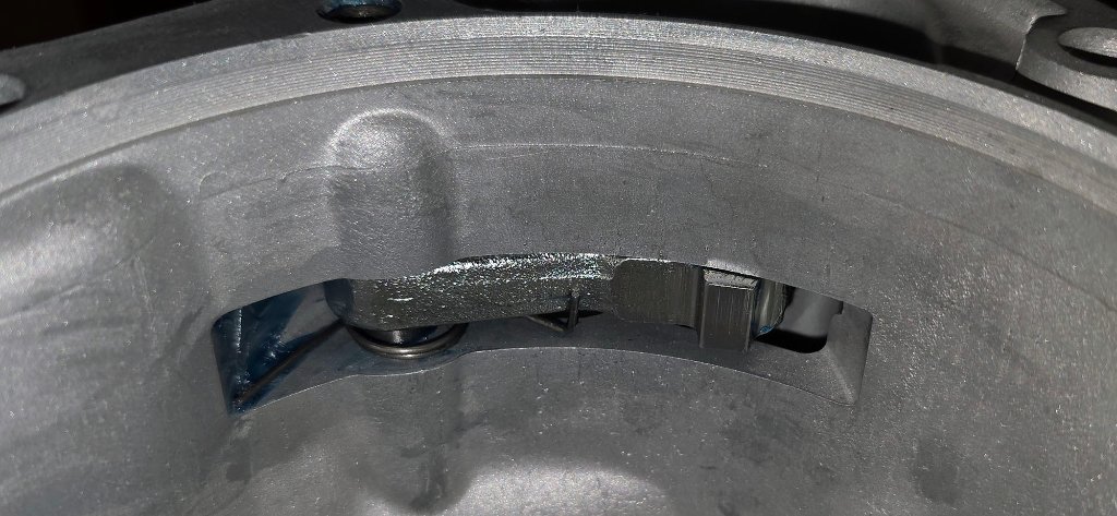

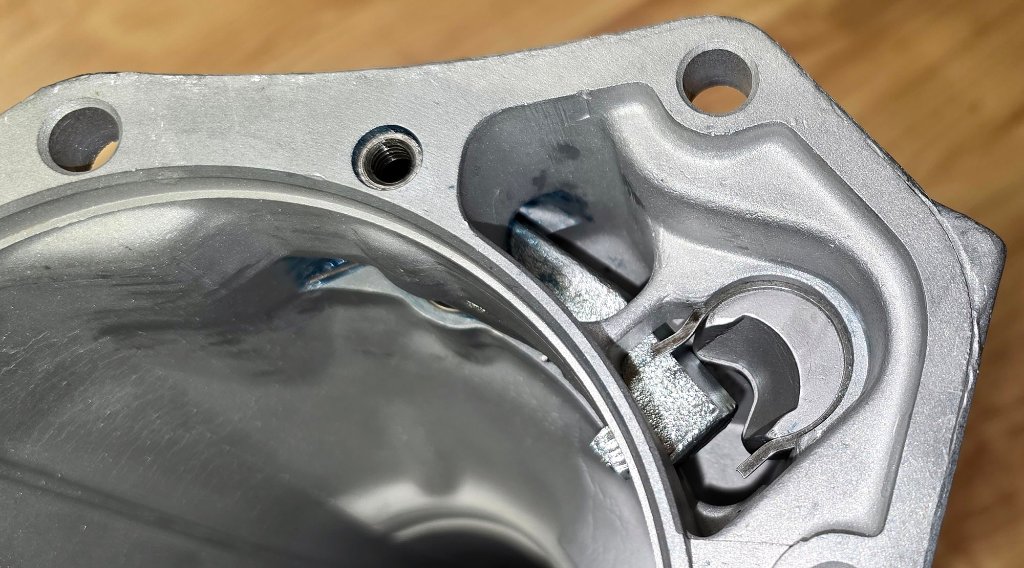

The only other thing to install into the tailshaft was the parking hook.

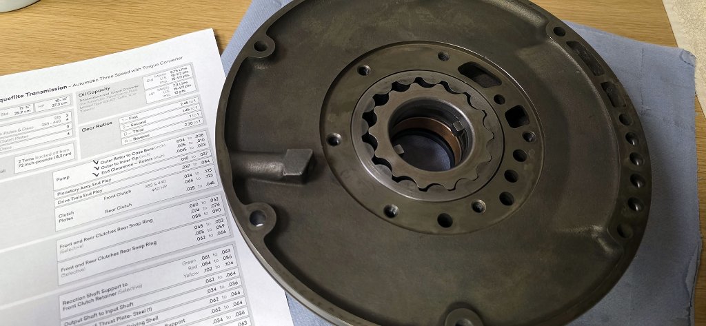

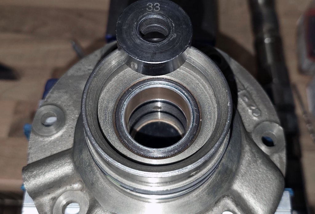

Next was the pump. Fortunately, the guy I bought it from had already installed the bushing and seal in the housing.
I checked everything for the desired clearances, and they were perfect!

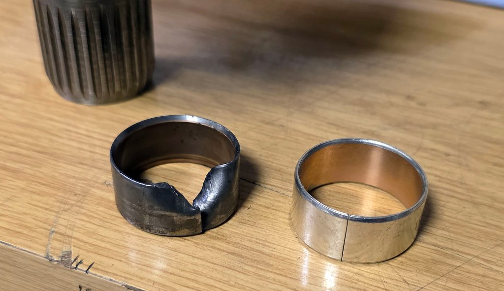

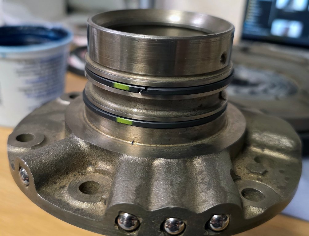

I installed a new bushing and new sealing rings into the reaction shaft. Then, I bolted everything together and put it into the shelf until the final assembly.

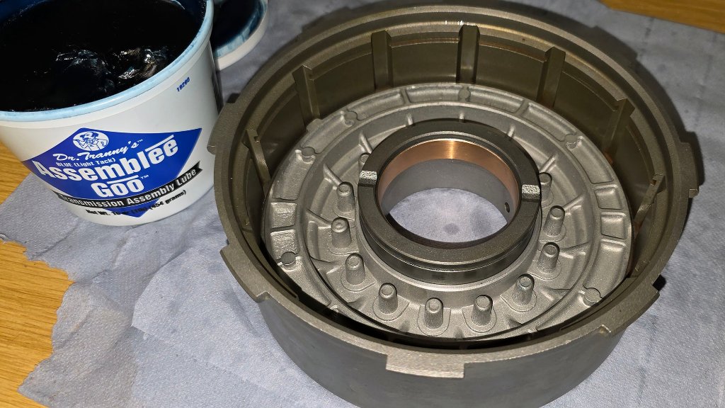

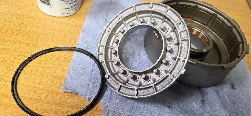

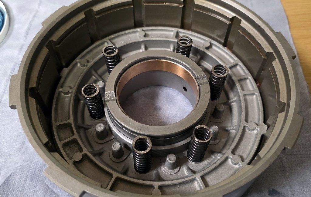

A new bearing and seal went into the forward clutch shell and the piston got a new seal as well.
So far, so good!

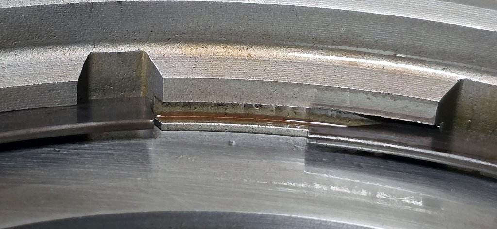

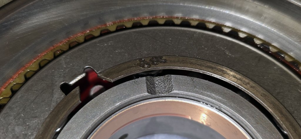

I installed new Colene steels and red clutches in the drum, but unfortunately, I found too much clearance after installing the upper snap ring.
I have .125" clearance, which is the absolute maximum.
I talked to Nick from A&A, and he recommended using thicker steels to solve the problem.

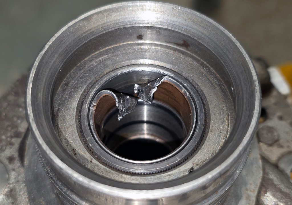

The original snap ring for the piston is badly rusted. Unfortunately, it is not included in the snap ring kit I bought.
I have put assembling the front clutch on hold until the new parts from A&A arrive.

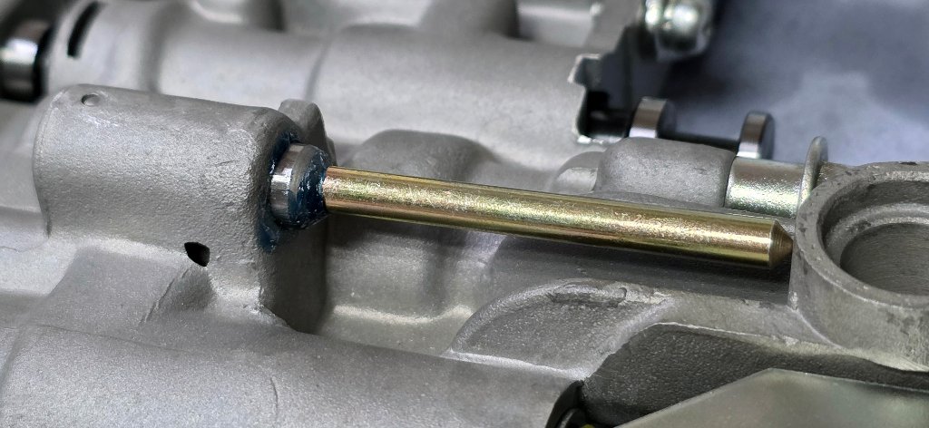

Since I have to wait for parts, I moved on with the valve body.

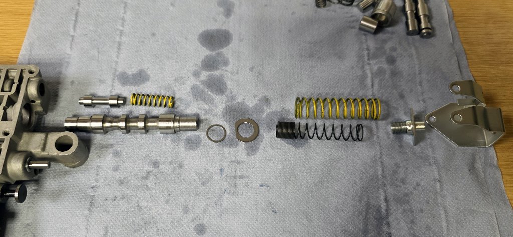

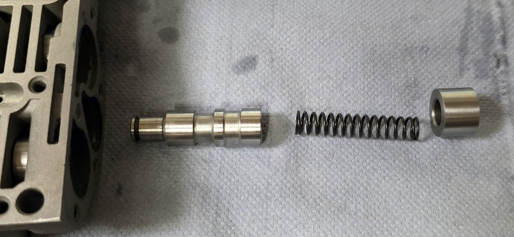

I decided to install a shift kit, mainly to solve the issue of the pump not pumping in park.
TransGo's smallest kit, the TFSC, resolves this problem.

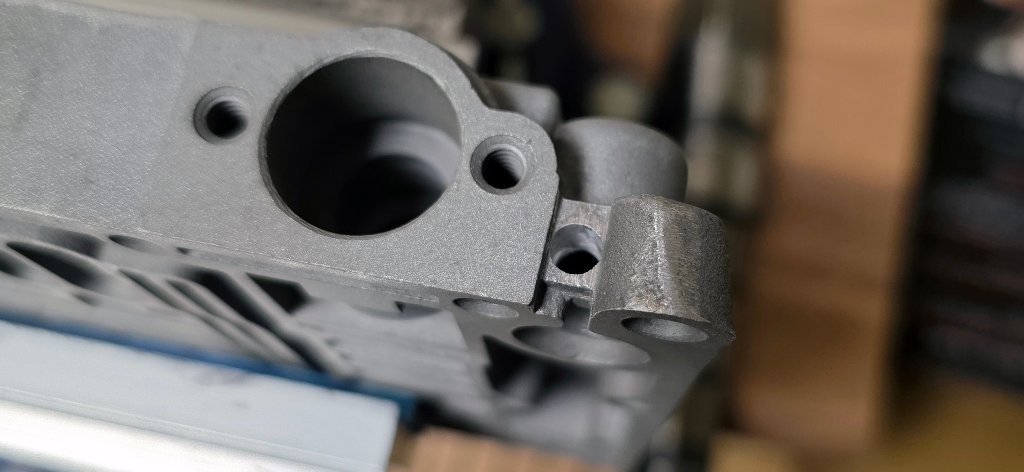

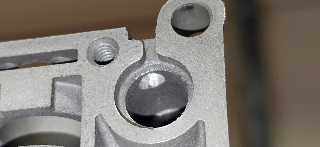

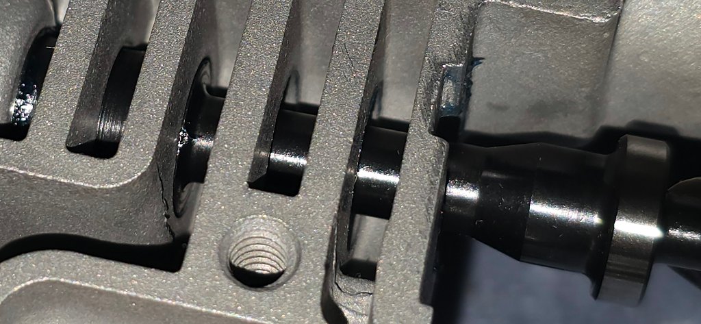

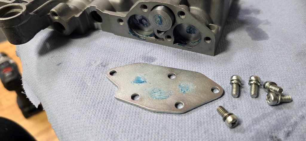

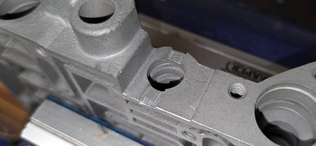

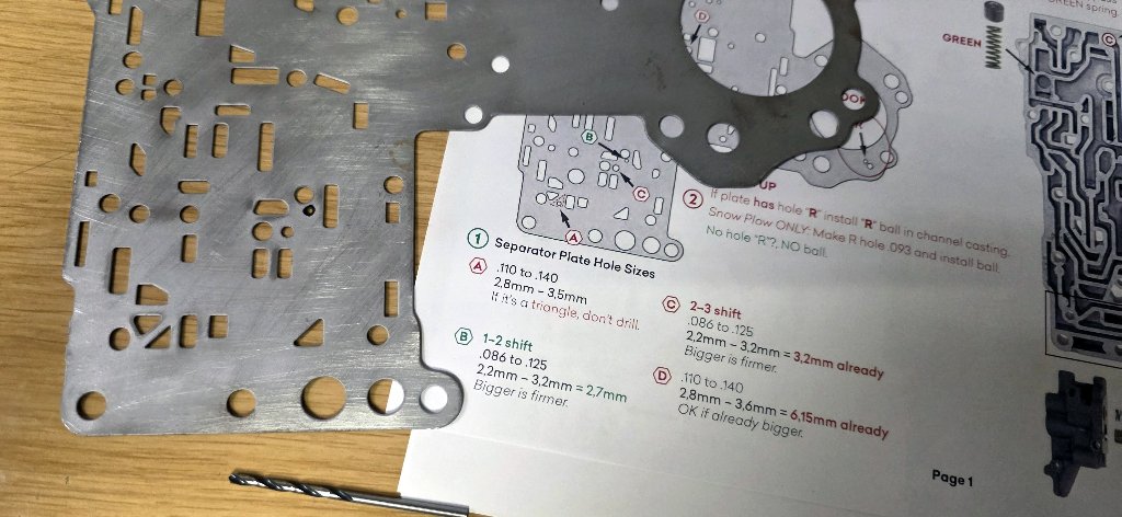

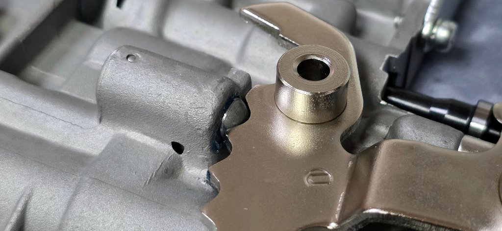

A few modifications must be made to the separator plate and the upper casting of the valve body.
One of them is filing a slot into the seat of the manual valve:
Another one is to drill a passage hole into the line bypass spring seat:

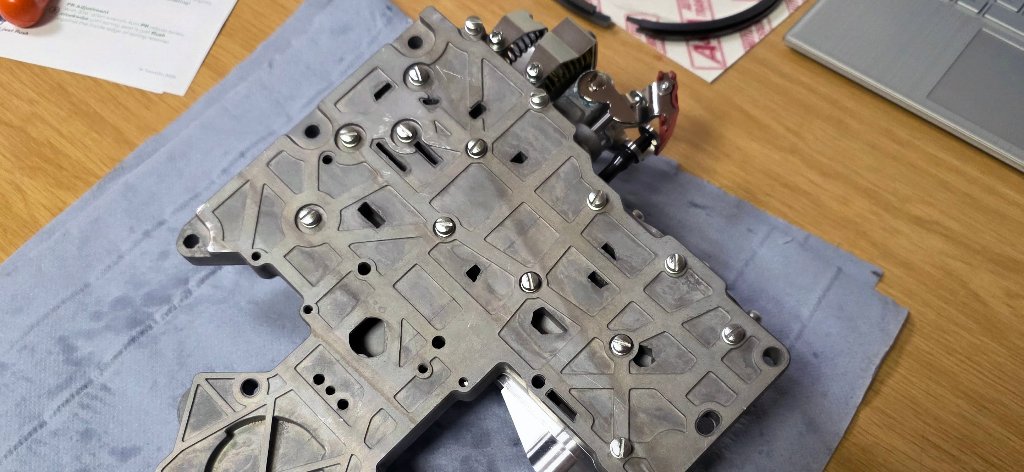

The '68 separator plate doesn't require significant adjustments to slightly stiffen the shifts.
I only had to enlarge one hole, and I chose to open it up to 2.7 mm, which is in the middle of the range stated in the instructions.

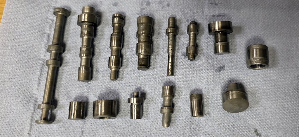

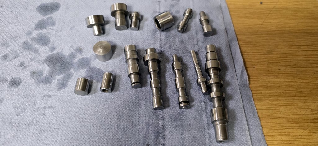

Once all the modifications were finished, I polished all the valves because they were quite tarnished.
That was taken care of with a drill, some WD-40, and a Scotch-Brite pad.

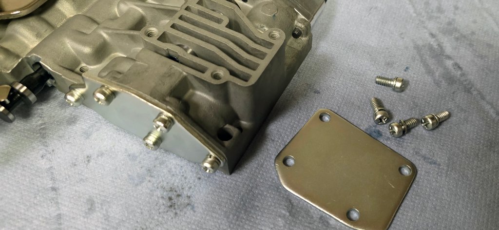

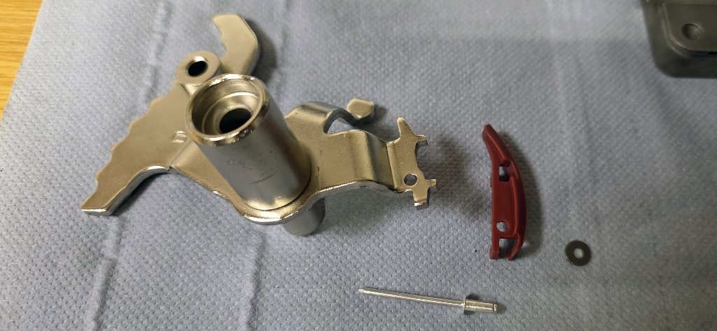

The rooster comb received a new isolator and was ready to go!

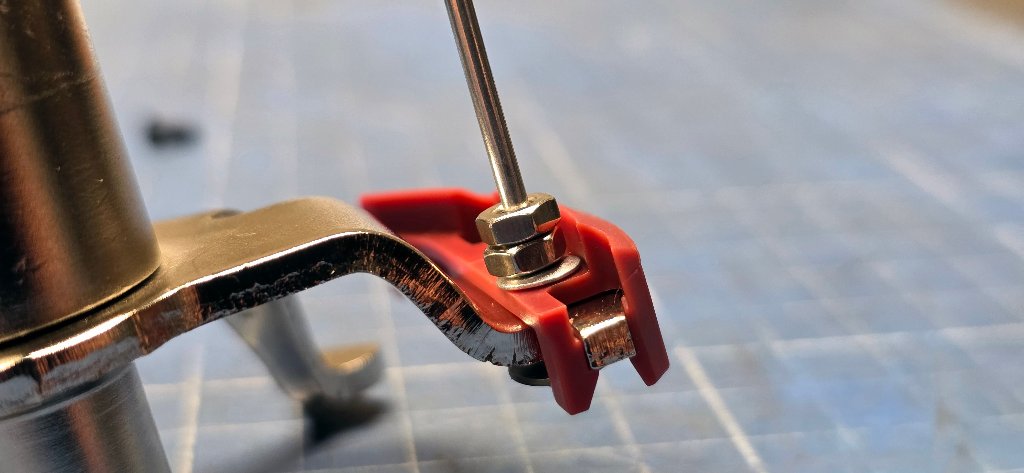

It needs to be riveted in place, but the tip of my rivet gun was too big. Here is a tip for anyone who runs into the same issue:
The rivet gun just needs a solid surface to press against. Two nuts did the trick.

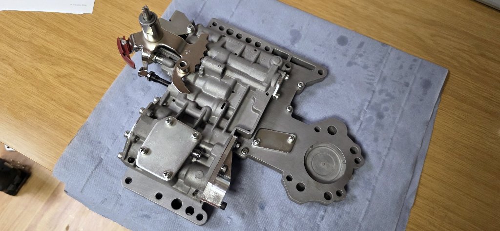

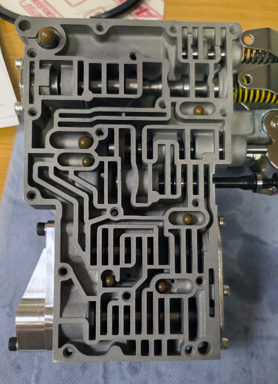

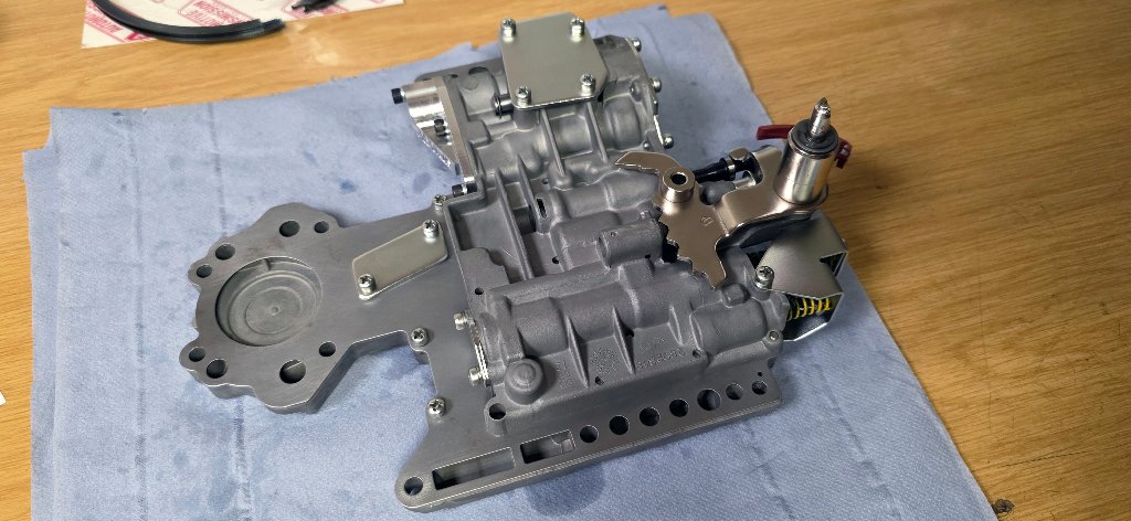

One valve after another went into the body.

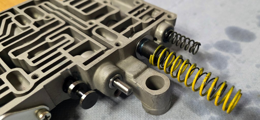

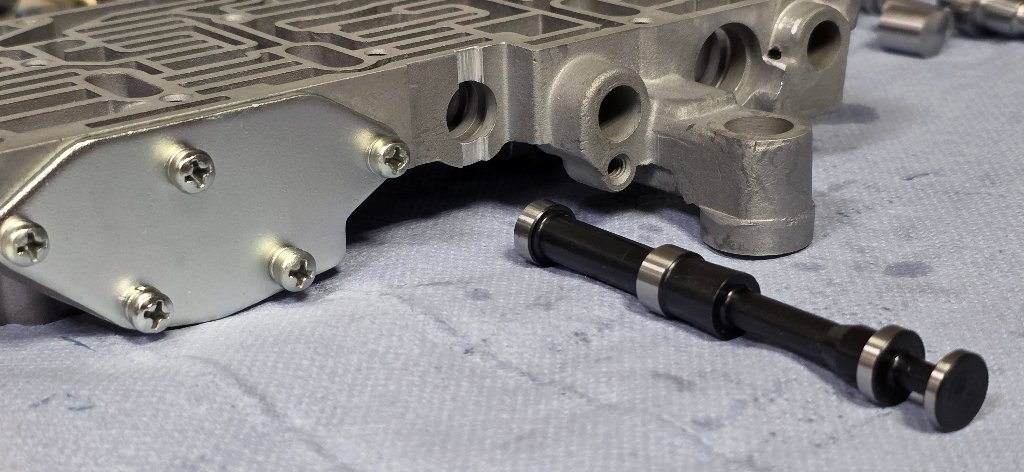

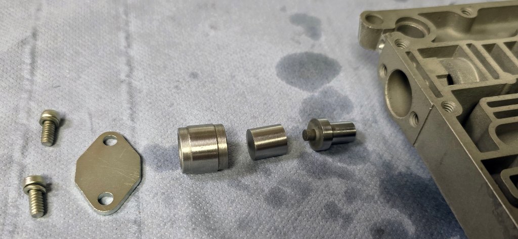

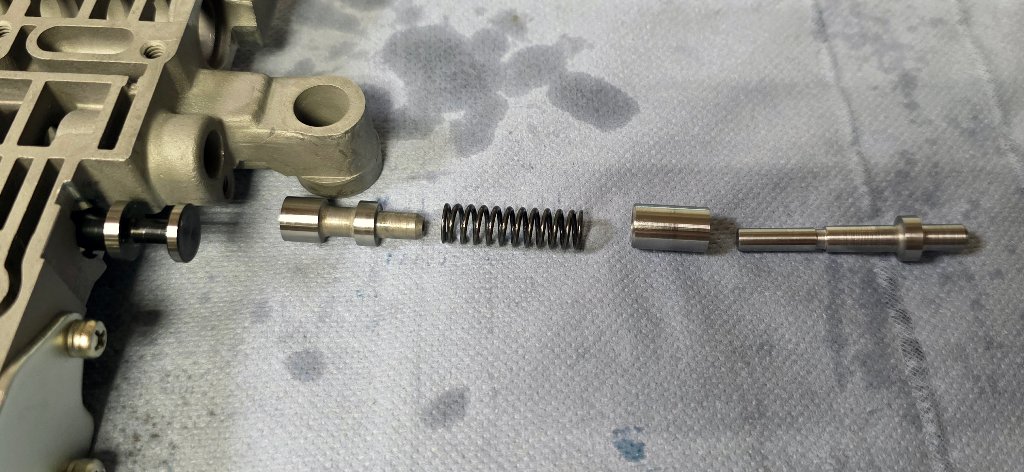

The TransGo kit includes a new manual valve and parts for the pressure regulator valve.

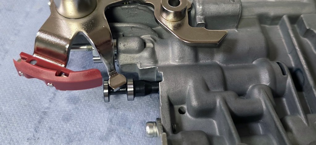

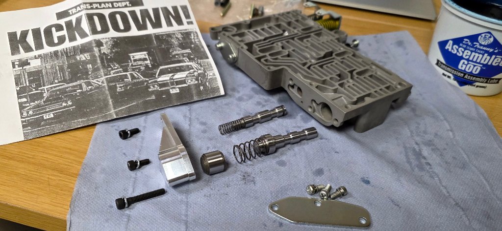

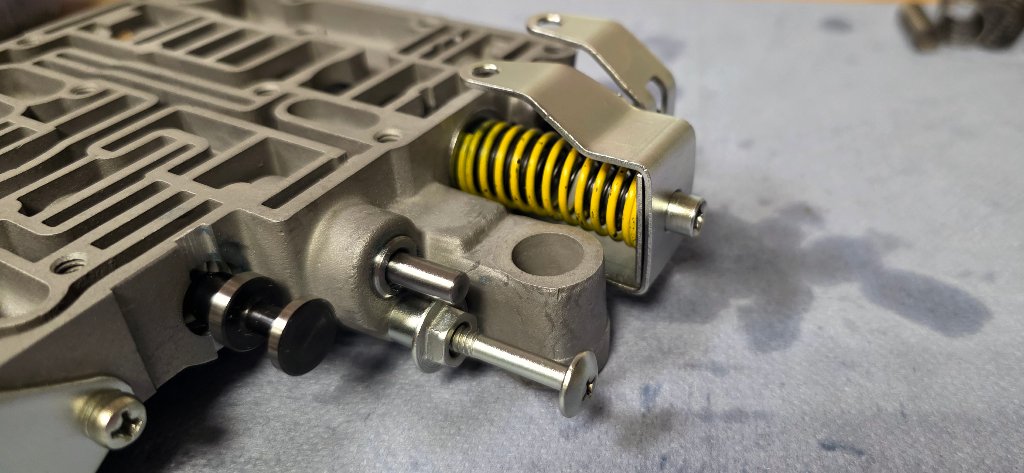

Another upgrade to the valve body was the addition of a part throttle kickdown module for the 3-2 shift. A&A provides a brand new unit, so there's no need to gut a later model 727 anymore.
The TransGo instructions recommend checking the position of the new manual valve, which is perfect here!

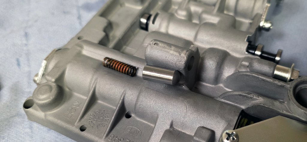

The detend ball for the shifter got replaced with a "bullet", which is apparently more secure.

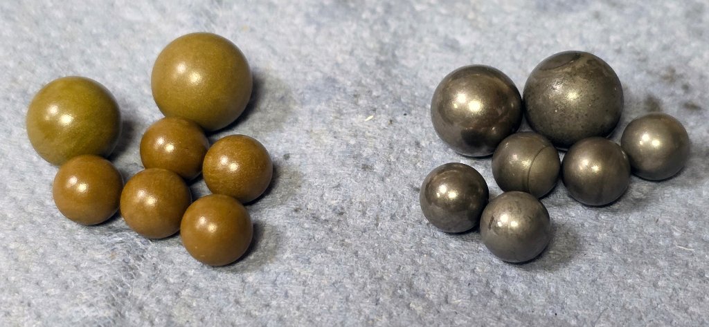

A few years back, @detmatt mentioned that it's good practice to replace the steel check balls with "Tarlon" ones from a later model 46RE.
Given the damage to my separator plate, I agree!
I've finished one more part, and I think it looks quite beautiful! :)
