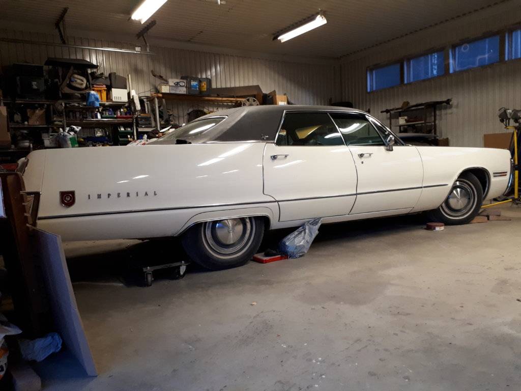

Is there a need for 1969 wheel lip moldings out there? Can anyone tell me if 1969 wheel lip trims will fit 1970 and 1971 models? Thanks!
The front should be the same. The rear is different. 69 hab fender skirts, 70 and later not.
Marty - is there a typo on the first ones listed for 69 and 71?? The numbers are so similar it makes a fella wonder.wheel opening moldings
1969
2932276-7 R/L front
2933458-9 R/L rear
1970
3419852-3 R/L front
3419012-3 R/L rear
1971
2933276-7 R/L front
3620220-1 R/L rear
