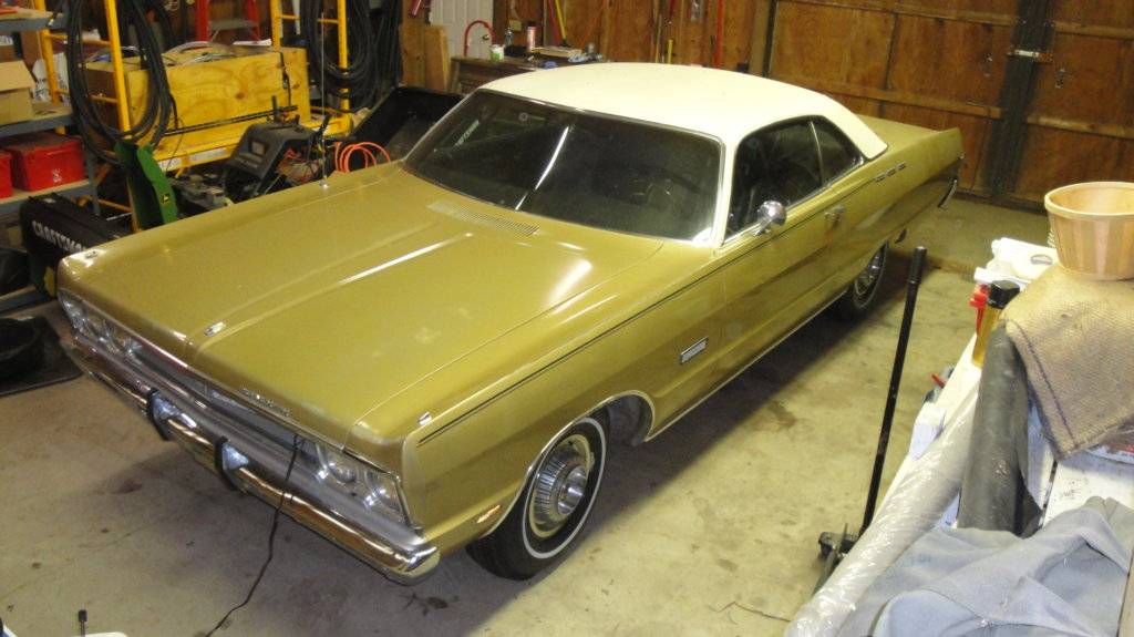

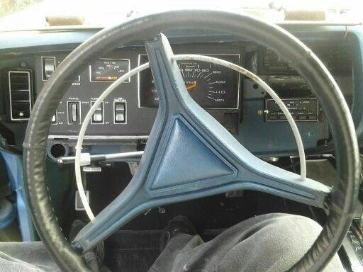

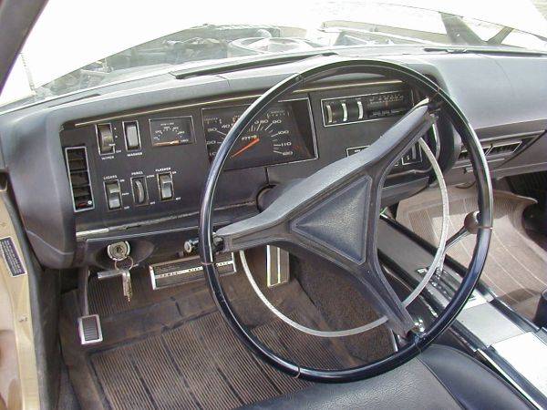

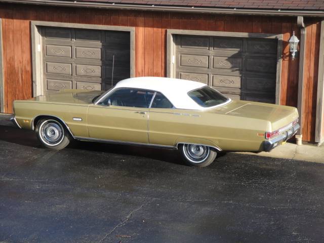

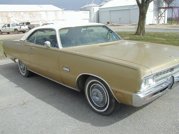

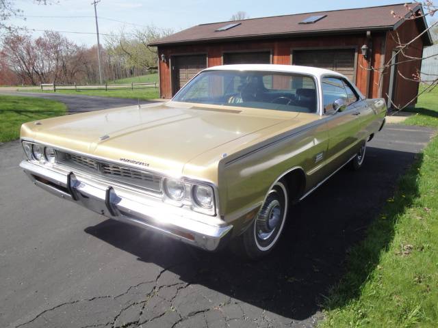

    Here are some before pictures. It is in very good shape except for the desert baked interior and vinyl top. It also has the ubiquitous rust at the bottom of the rear windshield and trunk pan.
    I kept waffling on getting it road worthy or doing a restoration and finally my OCD won out.
    This is from the CL ad, this was the second owner, titled but never registered for the road. I bought the car in Missouri from the niece of the original owner.
    Here's a few of the car after I got it home.

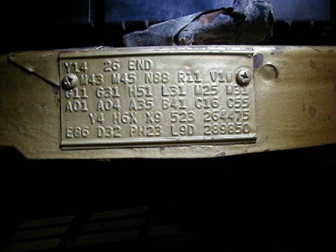

    What engine is in your Sport Fury? Do you have a body code plate photo you can share with us.

    It's all numbers matching 59k mile car with L code E86 440 Super Commando. The pic that sold the car for me was the interior shot showing the factory tachometer and power front disc brakes.

    Thank you, no Sir, the E86 is the Super Commando HP 440 with the 4bbl. 375HP, 480 torque. 69 and earlier that was the L code, 70 and later it was the U code.

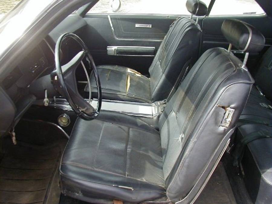

    Thanks, but the interior looks better than it is in that shot. The headliner and door cards are nice but the carpet, seat upholstery and dash pad are incredibly brittle. When I stepped in the back seat, the carpet ripped under my feet and you can hear the vinyl cracking when you sit down. I have a prefect used dash pad and I bought the carpet and seat upholstery from Legendary this winter.
    I believe I can save the rear floor mats but the front mats broke into several pieces when I lifted them up to take them out.

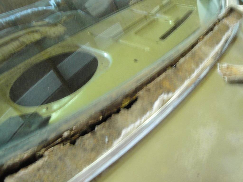

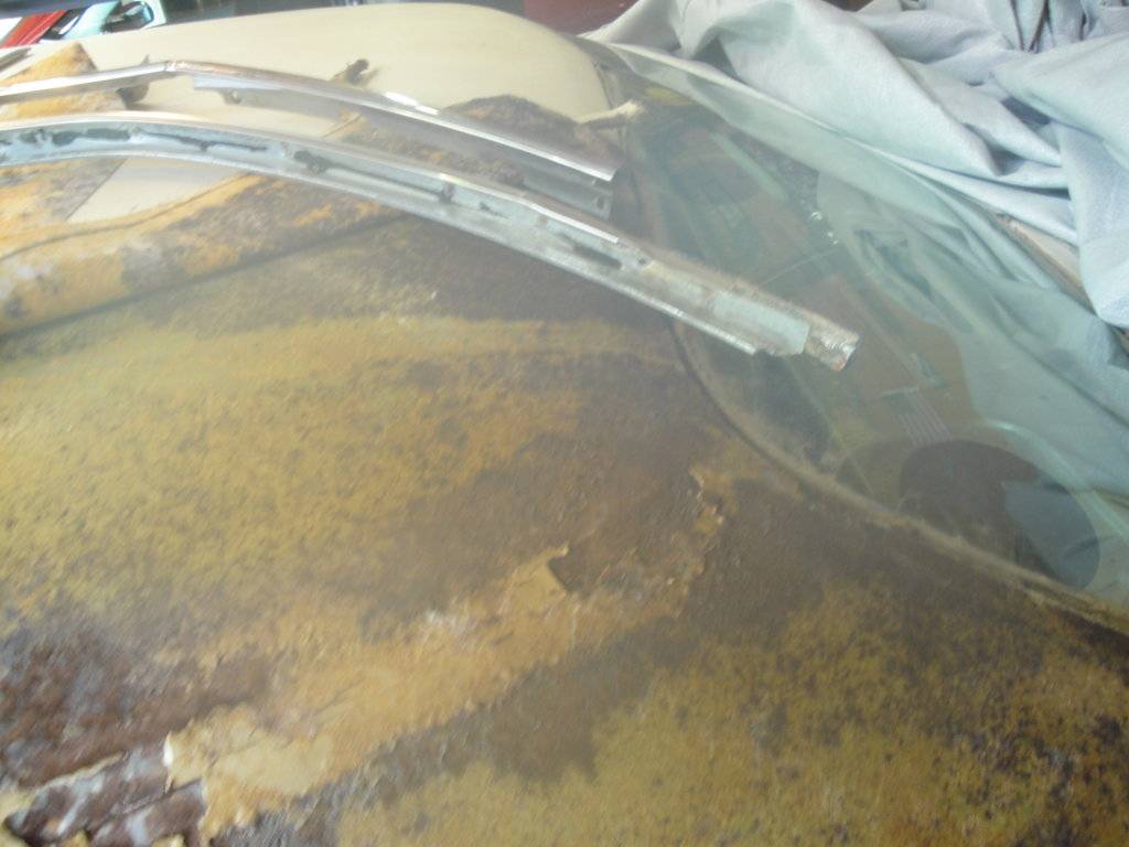

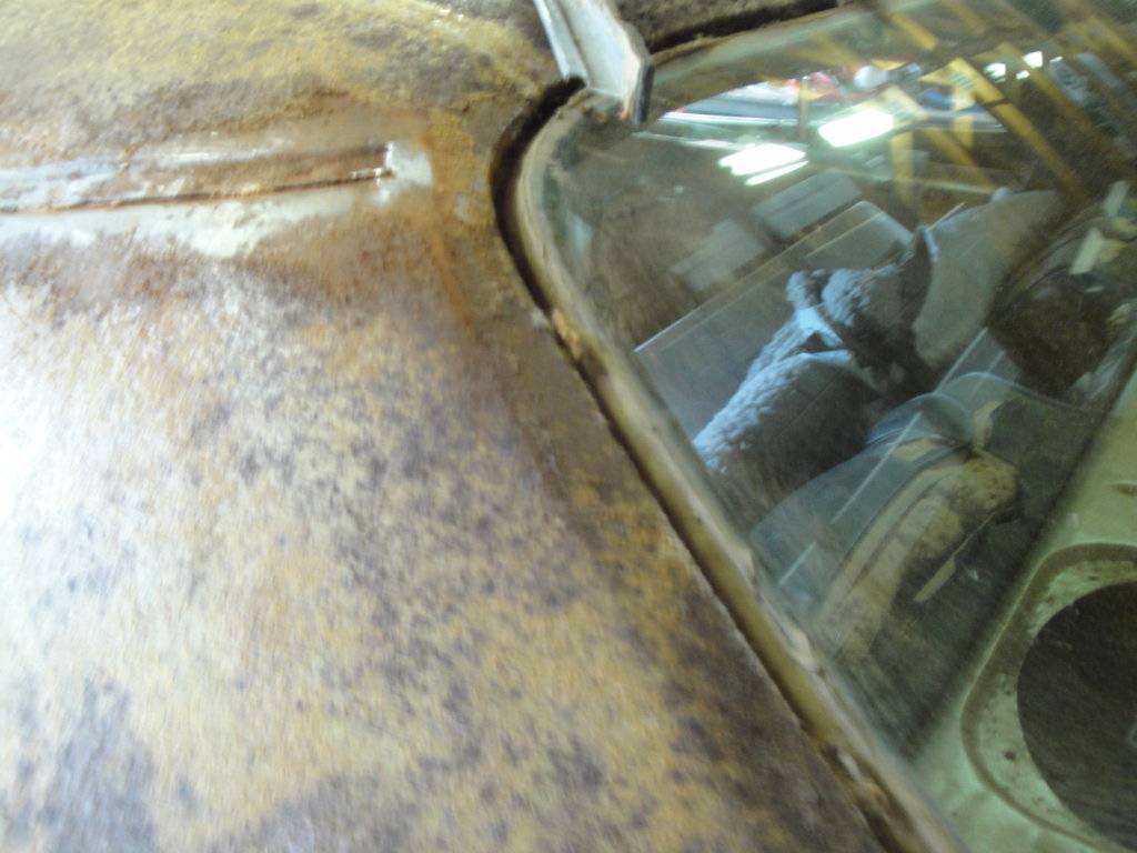

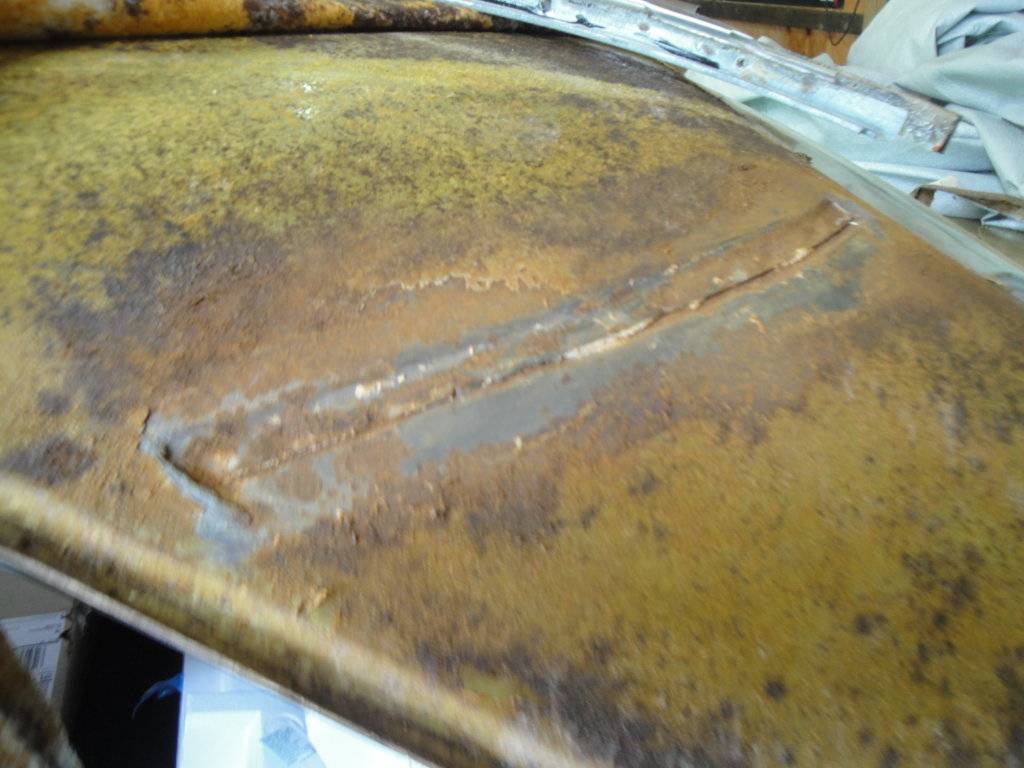

    Sorry it's been a while since I posted any update but life has a way of getting in the way.
    Here is what I found today while continuing the vinyl top remove....or, "The Good, The Bad, and the Ugly"
    The Good...
    The quarter panel / roof seems are far better than I expected. I posted earlier that there was just some surface rust but after digging out the body filler, it's far better then I thought. Both sides were about the same so I tried to take a pic of the right side which I haven't stripped off yet for reference of what the bubbling looked like before I started. I cast my own bullets so I'm flirting with the idea of filling the seam with lead. Pardon some of the pics, the humidity was super high today so I had to keep wiping the condensation off the lens.
    The Ugly
    The Dutchman panel is, as I expected, in terrible shape.
    The Bad
    I found what appears to be a good Dutchman panel but it's going to cost me $500 to get it home. Oh well, since they're extreamly rare to find one that isn't in the same condition as mine, I guess I have to bite the bullet.
    Hopefully my next update will be sooner.

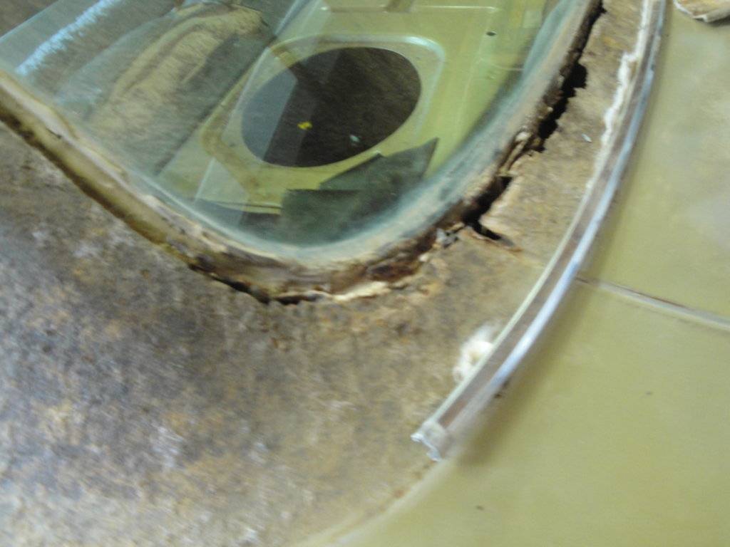

    So I bought a shrinker/stretcher to make the repair panels below the rear window. My question is how to remake the tabs for the rear window to sit on and the tabs for the chrome windows trim surround.
