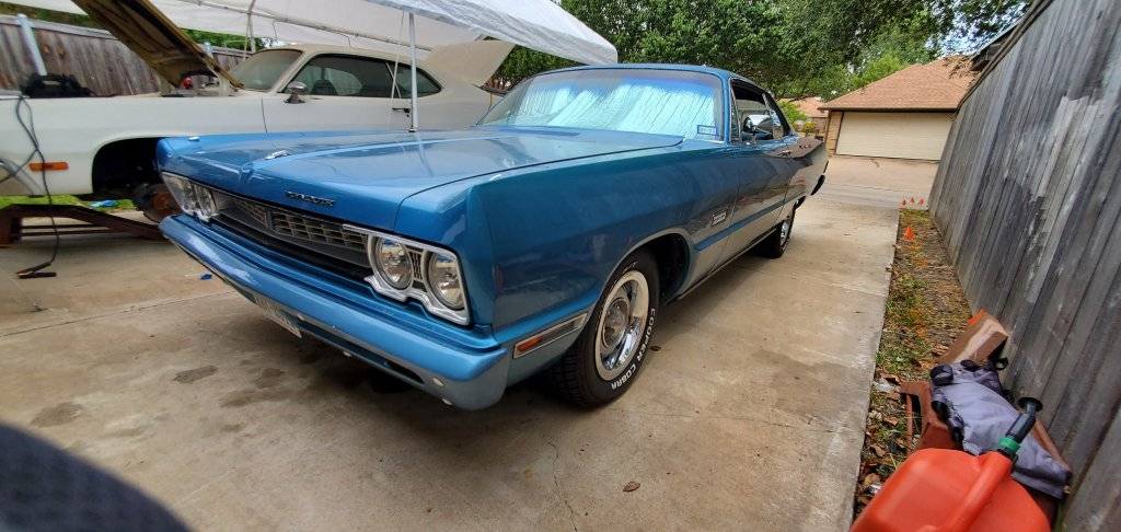

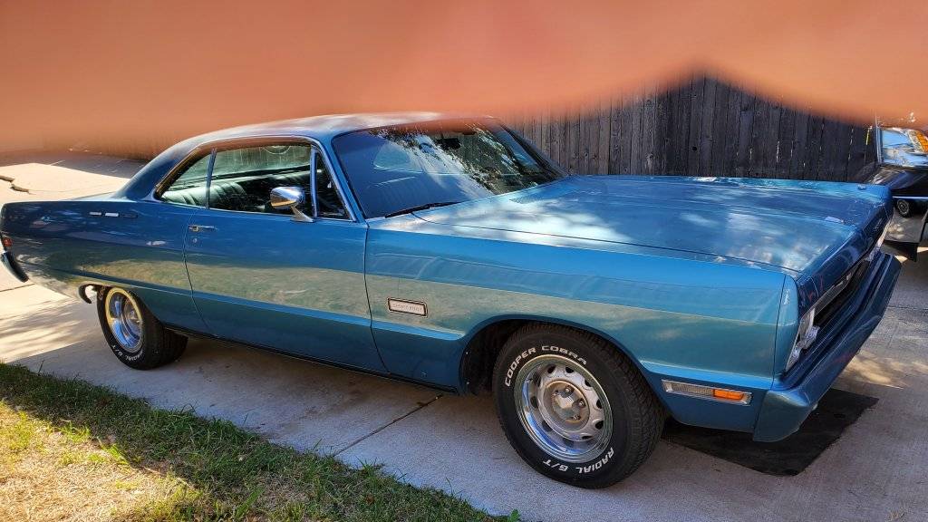

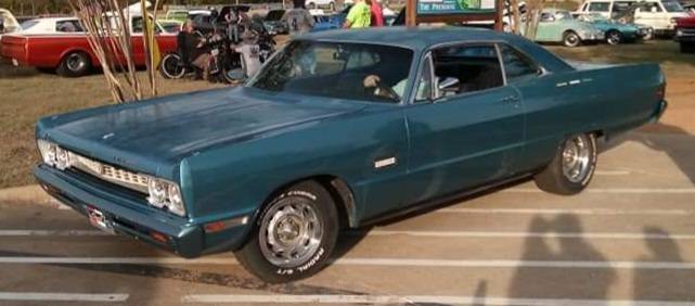

I have had my 69 Sport Fury for a year now. I driver her almost weekly and love it. However, my plan all along has been to make her a reliable cruiser with most modern comforts.
The plan is to install a 6.4 Hemi with an 8 speed automatic. I already have the complete setup from a 2017 donor.
I am looking for information if anyone has done one before. I have a DIYhemi.com computer and harness to control everything. I am a little more concerned with finding out information on transmission clarence and how much the transmission tunnel will have to be modified.
I'll post pictures when I get started.
