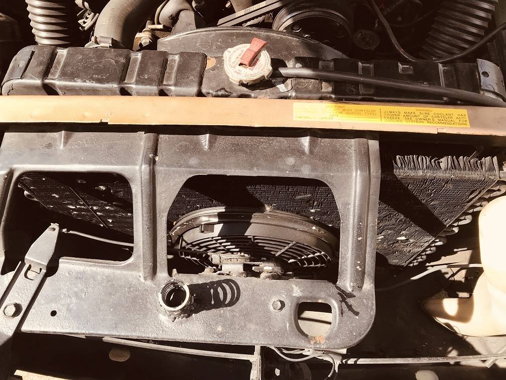

When I got it from the junkyard 20yrs ago, one of the many first things I did was add a temp gauge. It would get up to 240 when it was about 85 degrees with A/C off. So I had the radiator recored, replaced the water pump, did a back flush on the system, and changed the thermostat and hoses. There was a bunch of crap that came out of it. After that, it ran around 235 which was disappointing. So I just didn't drive it more than 10 miles when it was above 85 degrees....Solved.

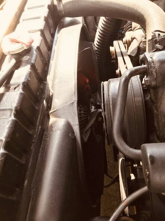

Since then, I changed out fan clutch, sealed the fan shroud, replaced the ratty old rubber mat under the car so air would be directed to the radiator, did another back flush, replaced with 50% distilled water, 50% prestone, replaced the radiator spring cap and checked the cowl to see if there was anything blocking the exit air flow. It would get up to 230....which again was disappointing.
A couple months ago, I added a 10" electric fan, but noticed about half the airflow doesn't make it past the A/C condenser, however I notice temps don't go up when stopped in traffic. I also tried that expensive ceramic coating paint for exhaust manifolds to lower underhood temps.....worked a little, I guess? Ran at 225.
Last week, I tried that Super Coolant which dropped it by only 5 degrees. Now it runs at 220.
Anyone have any better ideas? Is there a larger radiator I can put in this car without cutting it up? Is 220 too hot when its only 85 degrees outside with A/C off....or am I just being a wimpy guy?

FWIW - your condenser seems to have some mushed spots that will block airflow.
Do you have an 18" 7-blade fan? Looks like might be 7-blade, but confirm that for us.

Your top tank indicates the radiator in your car is an aftermarket one and those typically are manufactured for low price - and that means minimum fin density in the cores. These cars even from the factory had poor cooling capability in an effort to save money, so in high temperatures , they run too hot.
I typically use original radiator top tanks but install high fin density "high efficiency" cores to help keep these cars cool in hotter weather conditions, and especially in traffic with the a/c on. High fin density 26" cores typically run about $600 these days but doing anything else just won't cut it. Also, make sure your fluid fan drive is working well and not too loose viscosity wise. Under normal conditions even up to 100F degrees outside under steady state conditions such as on highways, the coolant should not go above about 190F with a stock 180F thermostat and about 215F in stop and go traffic with the a/c on.
This is not someplace where saving money will ever take care of the problem.

Comb-out and wash that condenser's fins to minimize the airflow blockage.
FWIW - elec fans like that help in traffic but block airflow when not in use.
