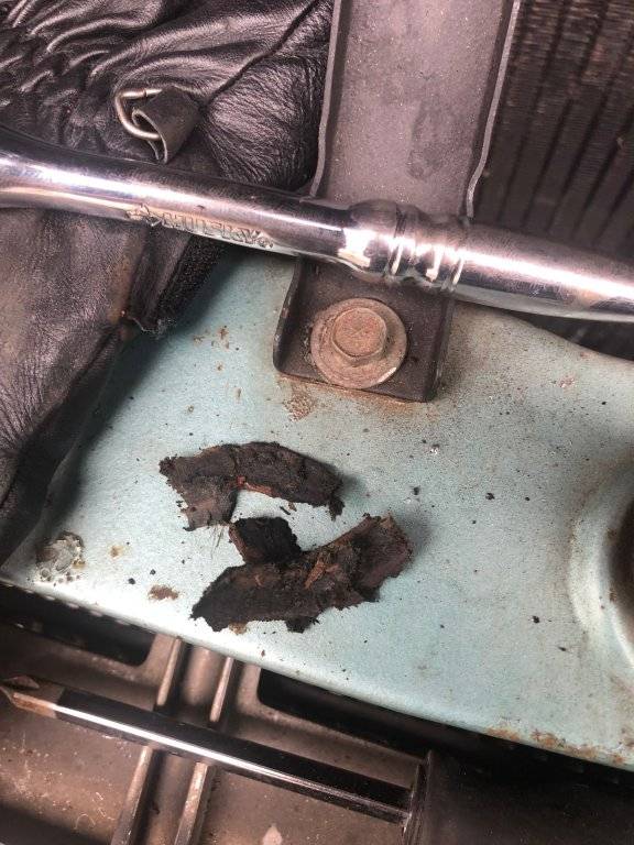

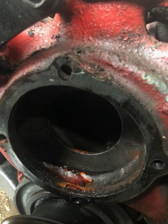

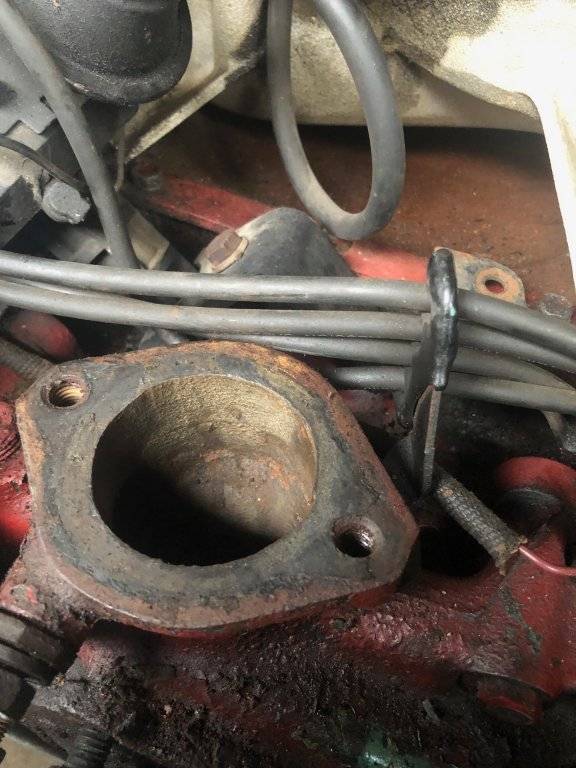

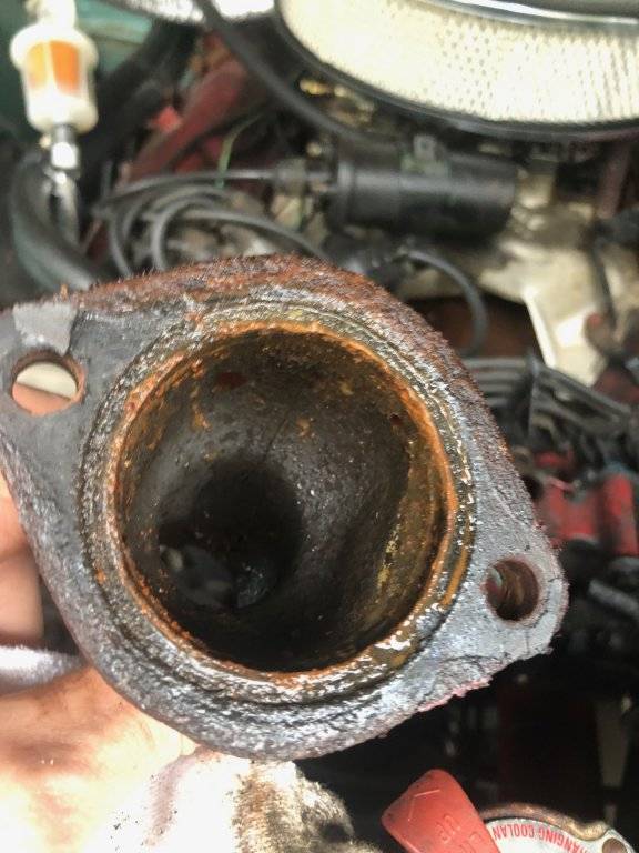

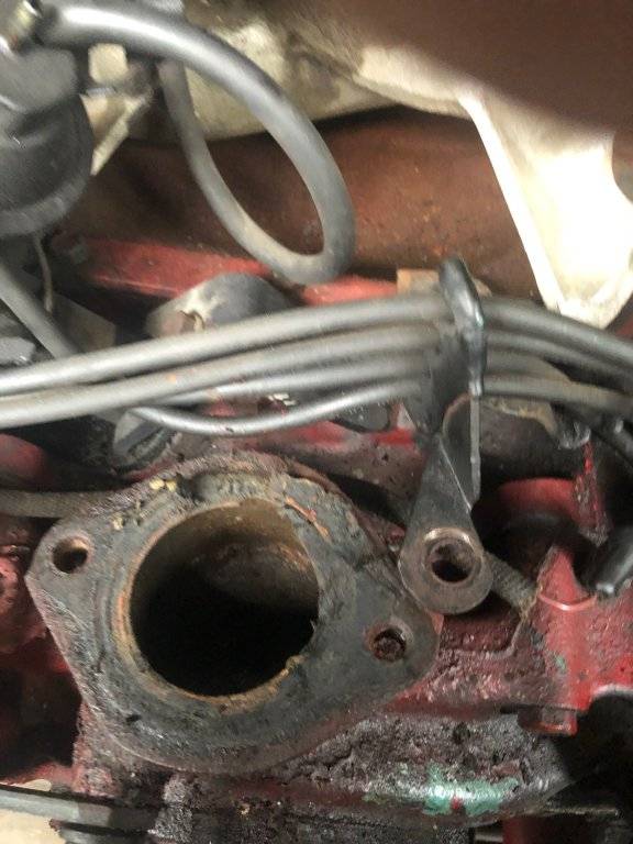

Any further advice is much appreciated. Photos show what old stuff looks like when I removed them today.

IF you want to replace the pump as an investment in not having to worry about it again and with no knowledge of how long it has already been there . . . just to make sure and then have a new baseline time to deal with, changing it while there can be an option.
