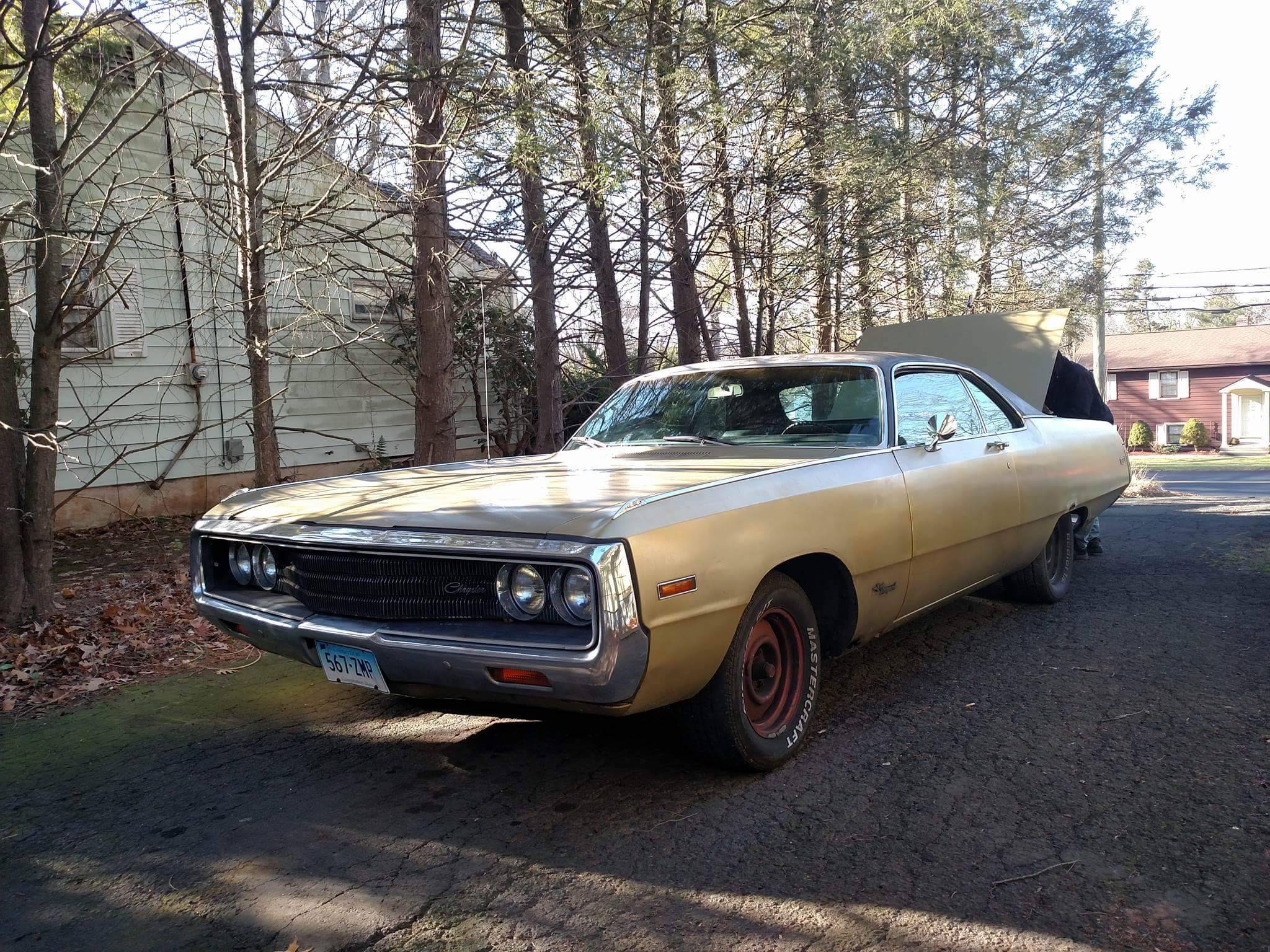

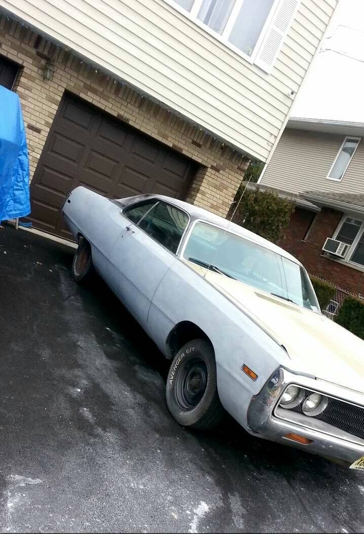

Currently as she sits with all the body work done. Just sent her out to get block sanded and primed.
