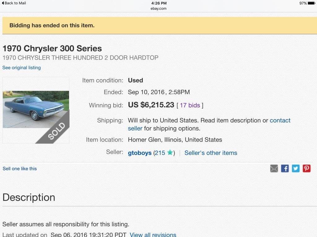

As we speak, it's at 41-hundred so if I wanted it, I would already be thinking of dropping out. I've been called a cheap bastard, tho, and Im OK with that. Your mileage may vary.If you gents were seriously wanting this car, what would be your maximum bid? It does appear to be a nice clean vehicle, quite rare nowadays

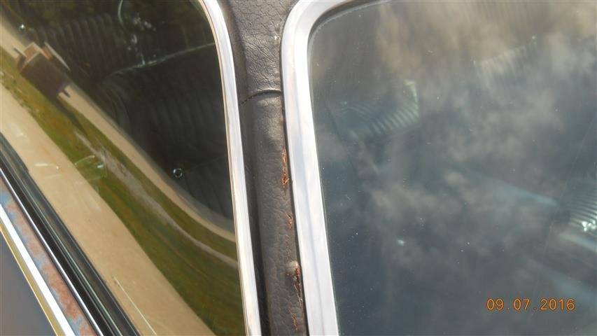

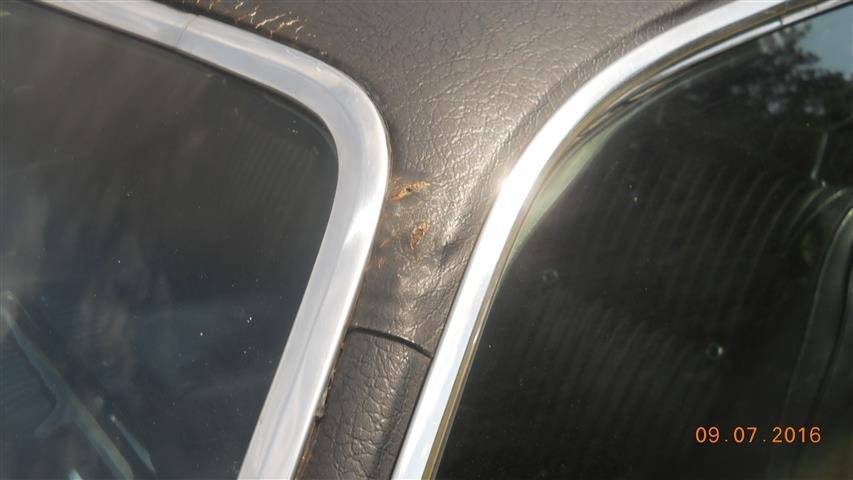

This seems like a REALLY nice car.... (everything has a silver lining though - the good thing about roof rust is you can stand up while you work on it)
$6,000 seems crazy for this car.

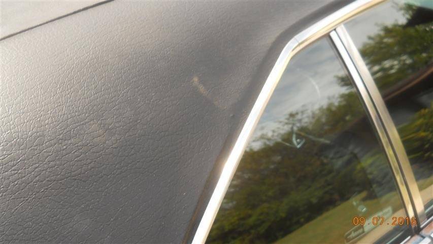

Once that vinyl is peeled away Im sure the rust will be worse.. I think $4,000 would be all the money based on that factor. Otherwise a really nice car!
My hatred of roofrust comes from the fact that you usually have multiple layers of panels coming together, 2 or 3 layers, all spotwelded together, and it's hard to cut all that cancer out to prevent recurrence. Some of the clips are surely rusted, which makes it tough to get the trim back on properly (unless you take the glass out and replace clips, which this car needs). Then you've got to get the surfaces in the right place so the glass will seal properly afterward. I've used a liquid/brush-on 3M product that is great for that, but it's still a PITA 'cuz you have to use such a tiny brush. And if it's severe enough that you need to weld, now you've got to make sure the interior doesn't get spatter-damaged (or burned!).
The 2 times I've done this I just painted the roof afterward with satin-black Rustoleum, with a 4" sponge roller, which gives a suitable appearance for my needs. 1 car I did only once (the rust was very minimal surface spots and never came back even after 15 years) -- but the 2nd car looked much like this one in the pics and I had to rework portions of it every few years.

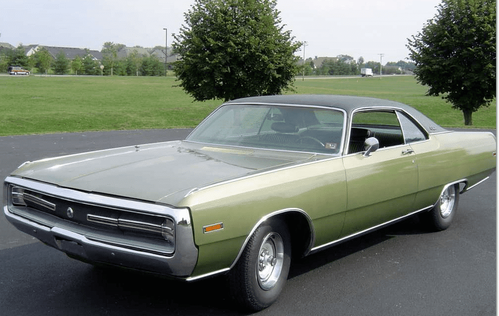

My green 70 300 pictured earlier also had some mild spots in the a-pillar, somebody put a new VT over it so it looked OK but at close glance you could tell what was under there. And it also had a rusthole at the bottom corner of the dash, and some of the understructure at the package shelf and trunk jamb had rusted also. So even though the seller of the blue car said no apparent water leaks, that water can quietly get in and run to invisible places and cause very unexpected/untypical damage.And that car had nice shifter and TS stalks, none of the outward signs of a car that had moisture inside it.
So IMO a guy could spend a lot of effort to fix that roof, and afterward the car isn't really going to look much better, drive any better, or be worth any more. Like fixing a cracked foundation in a house, you can't fully admire your accomplishment afterward...
So I pass on roofrust unless the car is really special, or really cheap, and this car is neither in the grand scheme. If it was a TNT car I would feel differently.
