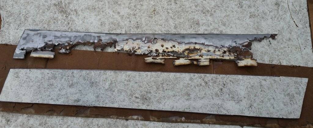

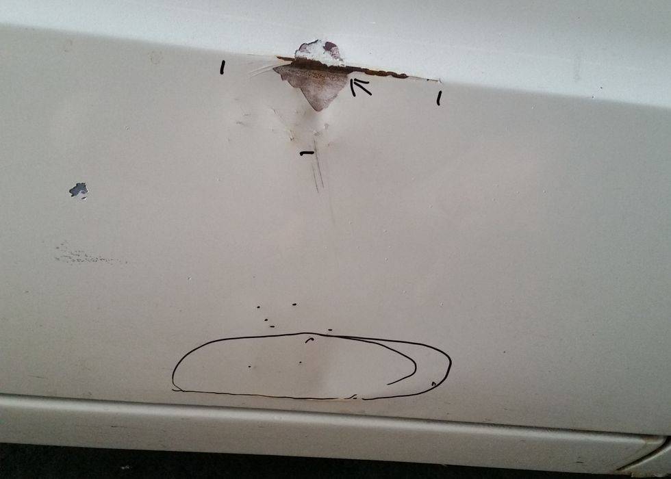

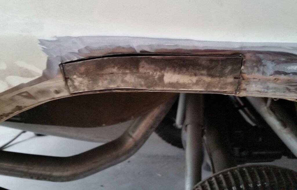

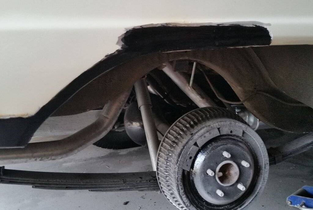

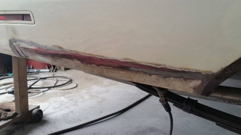

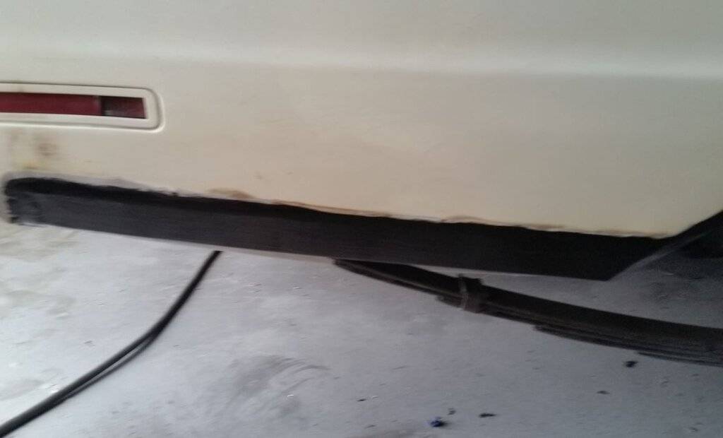

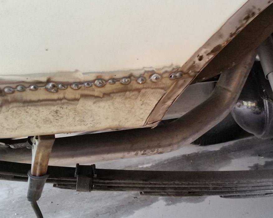

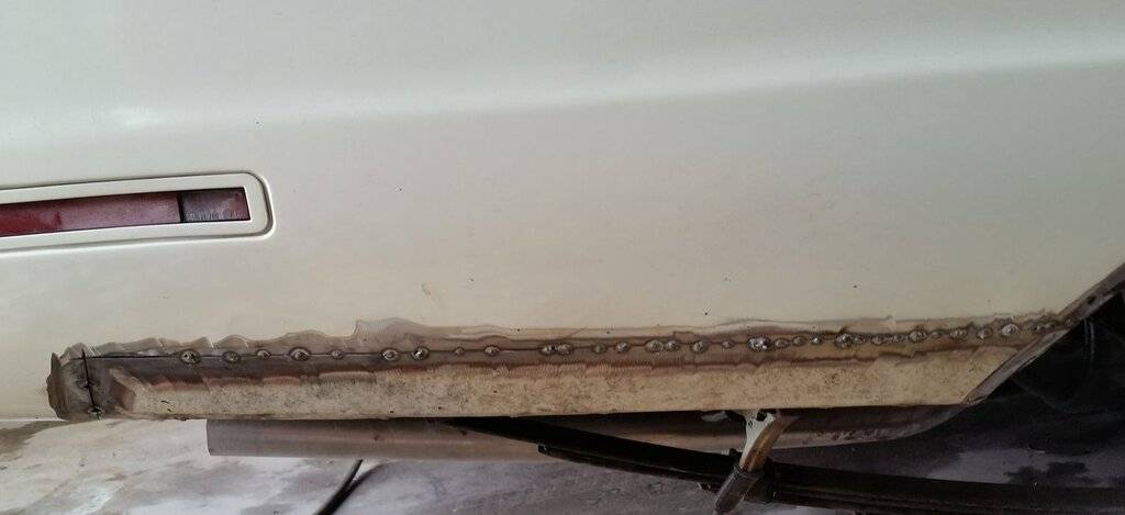

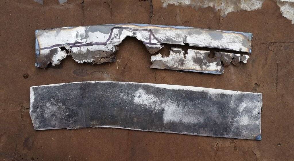

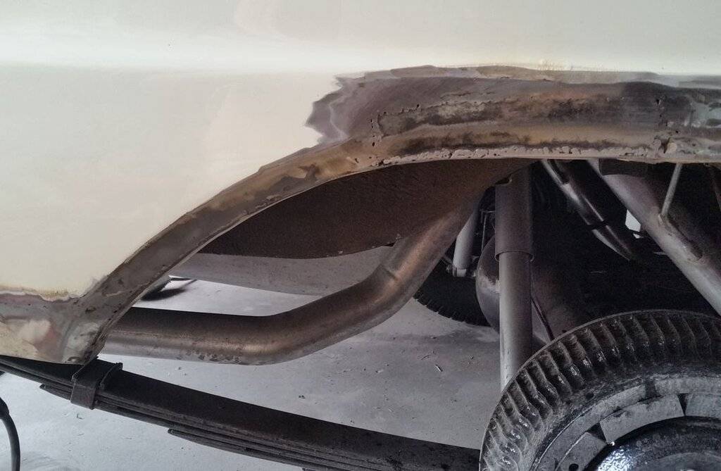

Gary's progress:
· All the previously rusted out pieces replaced have been welded in now and sanded flush. I also knocked out the dents in the door and then I put a coat of Eastwood Epoxy primer over it all. Next will be to put a skin coat of body filler on the door and sand that back for a perfect finish as well as putting body filler back into the rear panels too. Once this side is done, then I will move over to the other side.
· Regards, Gary

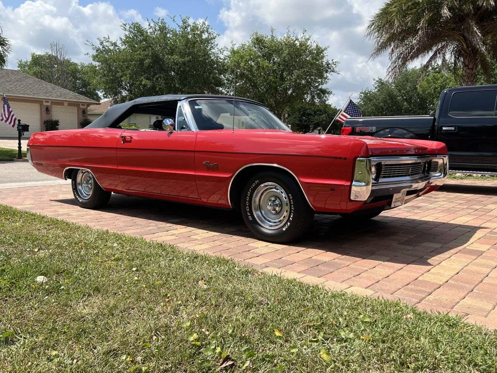

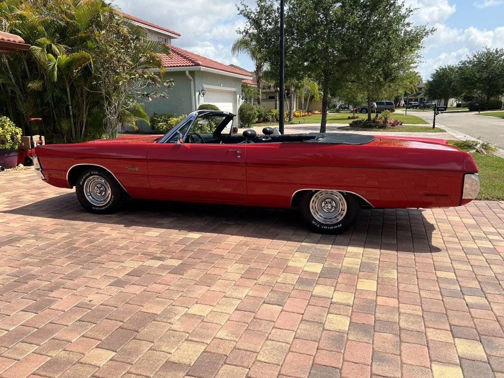

@70FuryConv - Yes Thank you. Did you do a conversion to yours

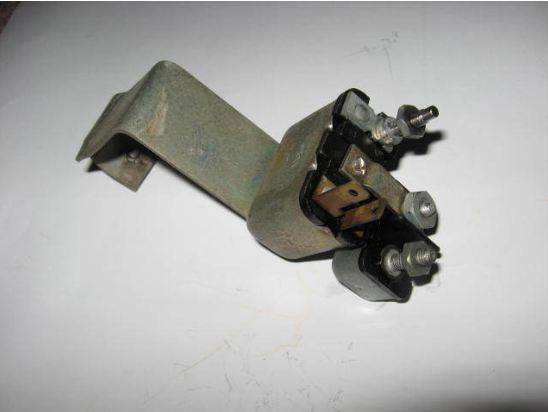

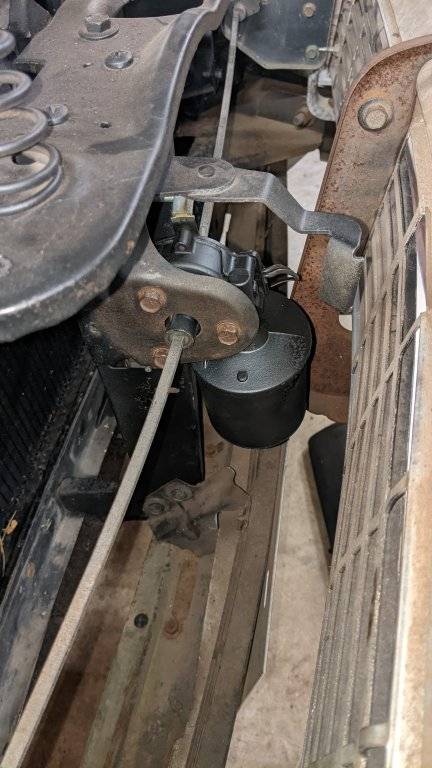

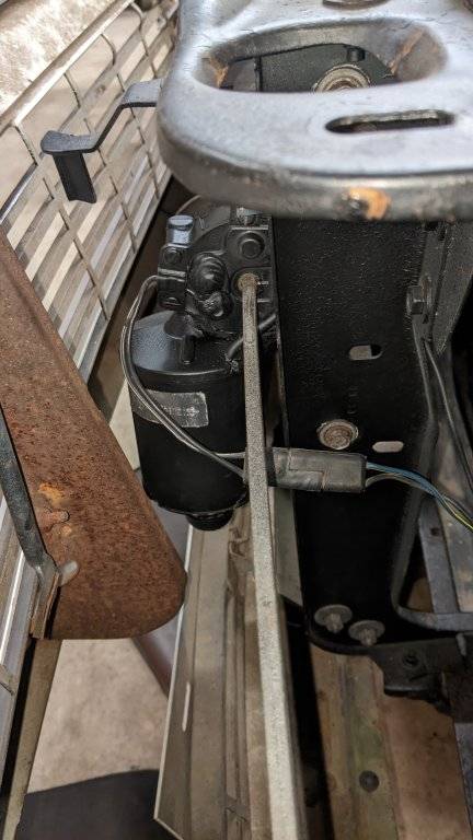

Yes. Normally the Fury III did not come with hidden headlight grill.
For the electrical side of the install, I used an original Chrysler hidden headlight relay, which screws to the dash shell at the bottom to the left of the steering column.
I used the time delay wire from the headlight switch as the activating wire for the relay.
I used ignition-on power that I ran from an auxiliary fuse box, powered from the ignition-on post at the bottom of the original fuse box.
I also used the 2 original wires going from the relay through a grommet in the firewall, over the left side wheel well, through the radiator core support panel, and out to the grill motor.
Do you have a factory shop manual for your car? If not, you can go to Service Manuals – MyMopar
and download one for free. The wiring diagrams will let you know what size wires to use. I could not have made the conversion without the wiring diagrams in the factory shop manual. Let me know if you need anything else. Glad to help. Ben
Also if you want to upload a picture of your Fury to this thread, it would be great to see it.
Hidden headlight relay
Thank you so much for the info. The wiring is the easy part for me. Your pics were very helpful and I really appreciate the info!
