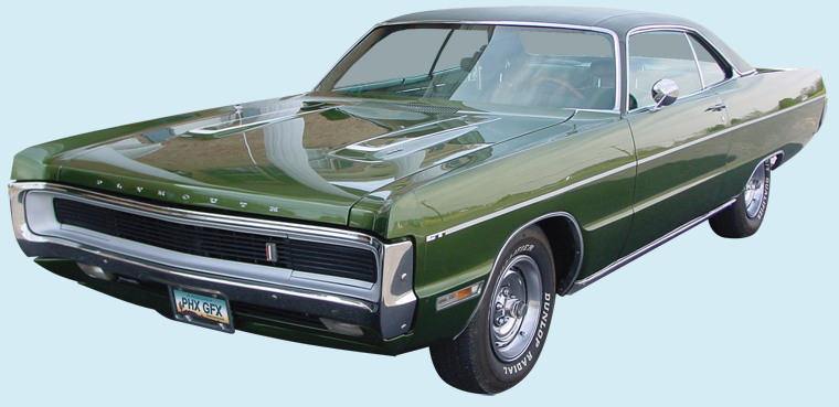

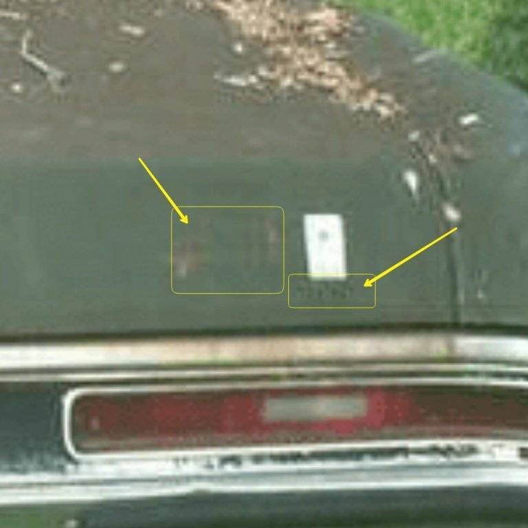

Looks more like the remnants of side body moldings with the pointy ends still attached.
moldings on this would be one piece...that little white spot on fender would be the first decal lm thinkin....
k after checking a GT would start with GT so rules out a gt and the 23 starts with 23
actually looks like the leading edge of the 71 decal package
...sampleing may be right and what that white spot is is whats left of the molding?
bottom line something went down the side of that car for shure as you can see it

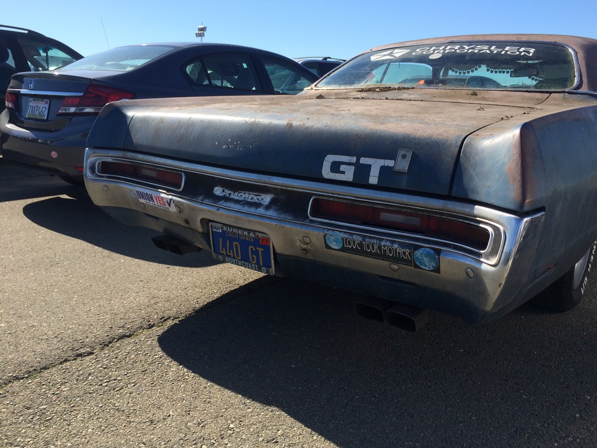

The white one with red rim in critters picture above was mine. in fact it's sitting behind my shop in the picture .
Regardless of what it is, it's a great start to a Fury resto or even a SFGT or S/23 replica. If it's not one of those two to begin with.
