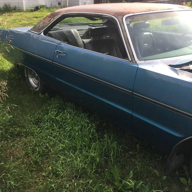

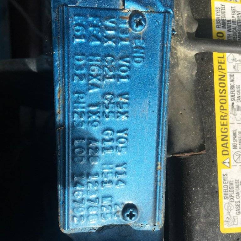

In the end it's a formal roof line with a p23 fender tag as Tobias pointed out....wrong tag for roof...

No is a PH23 car with PH29 vin tag on the dashboard
My PH29 car from the same factory has that on both the fender tag and the dash VIN.Could be a screw up by the guy stamping the tags but that would have to be investigated further.

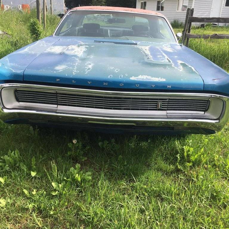

This blue car is also coded as originally being FF4 which is Lime Green Poly.If it had a complete repaint,they did a pretty through job under the hood of painting over any of the green.I'm curious what the trunk looks like inside.
The rest of the options match the tag although the vinyl roof is MIA but should have been black.
Something still seems off here,did the last 6 numbers on the dash VIN match the ones on the fender tag?
The fender tag is right not the Dashboard tag is a totally different number
Sounds like a good one to avoid.The dash VIN matches the car body style but the fender tag matches most of the options on the car but not the color or body style.
My best guess is the actual PH29 body (with dash VIN) was combined with a parts car with the fender tag shown.Not sure why the fender tag was swapped,maybe the person doing the work didn't know much about it and mixed them up or ???
