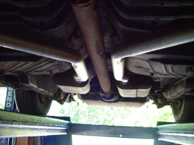

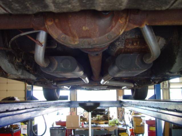

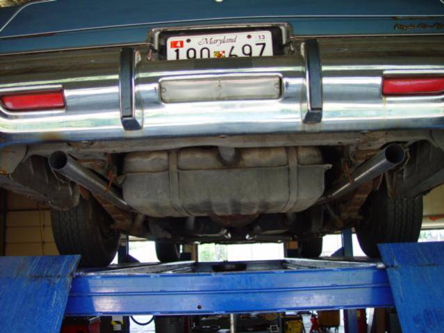

Yes, that is at best, ridiculous. My Imperial had a 2" single exhaust system with resonator. I chucked that and changed it over to 3" dia. dual exhaust system all the way back with chrome tips and could actually feel a bit of difference just by letting the 440 breath a little better.
Some of the bends are down to 1 7/8" or less. I know noise was a big concern when they designed the factory exhaust systems back in the day. Still, all should have at least 2" duals with big, quiet mufflers and resonators. The 3" system a bit loud? The length of the car probably helped a bit...
I guess I could look for one.....I don't feel any heat coming up through the floorboard.

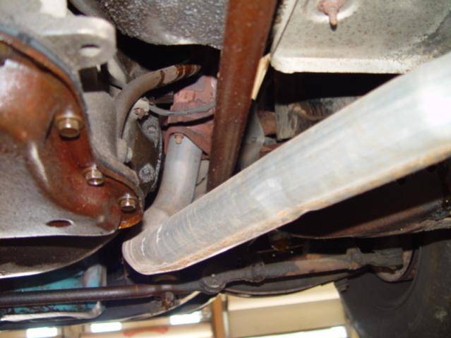

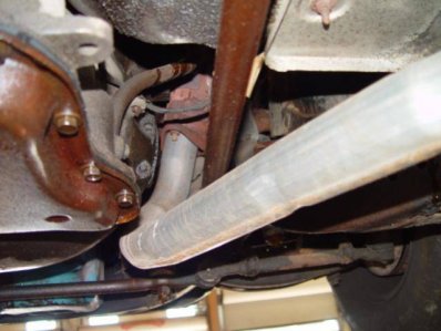

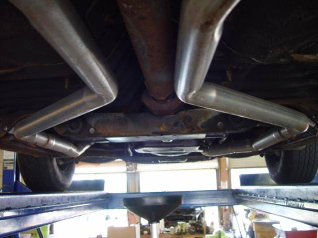

That shop does nice work. The bends with the larger head pipes are difficult where it meets manifold and around torsion bar. The more I look at it, looks like TTI system but welded. I put their 2-1/2" system on my '71 Polara 440HP, fit really nice. I like to use the Flowmaster 70 Series muffler, 28" case designed for RV's, trucks, only fits the fullsize cars... not loud at all. Seeing your system make me want to stop by TTI in Corona and pick up another kit. Oh yeah... needs to run first Lol
I think the entire system including installation cost me $370. He bent the pipes himself and was done in one day.
That is a screamin deal... guy definitely knows how to bend pipe... looks great!
