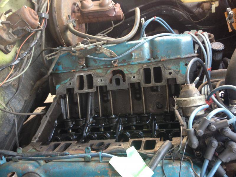

Ahhh,, put new rear shock supports on the back ,,, the front end is all brand new... accept for the shocks but new tie rods and everything for stearing.

Is this a fuel line that is used for the brake booster; used that type as a temporay fix shortly as well but should be a wire-reinforced or solid vacuum line as it could otherwise colapse through underpressure.

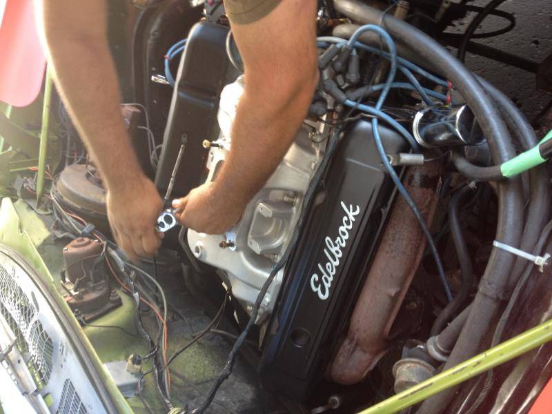

hahah. with the new headers on I got to get new wires with longer boots on them.. that's next... was also thinking of MSD ignition what do you guys think of that?
