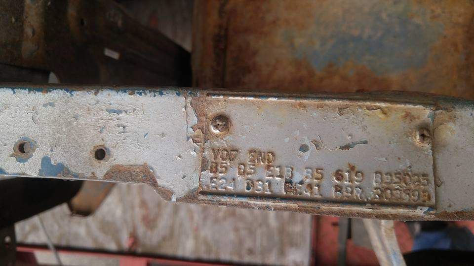

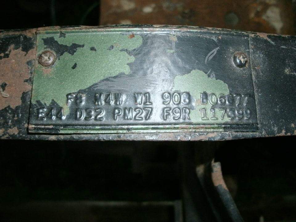

Spot welds, rivets and screws were all used. Screws were common on Newark cars. A lot of the build tags also had pre-drilled holes for screws.
Dave
My 2 cents worth, the tag has bee. Off, but the screws aren't the deciding factor.... Here's a few untouched tags with screws.....my Newark DE built 73 also has screws...
View attachment 314321 View attachment 314322 View attachment 314323 View attachment 314324 View attachment 314325 View attachment 314326
Belvedere was the only plant that used rivets during this time frame. The car in question is from the Belvedere plant.
It has screws and not rivets you should expect to find.

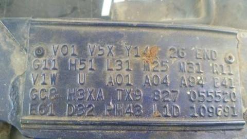

Another car with 827 SPD. The inspection tag on this fender tag (under the upper left corner) is still present. I don't see it on the car in question.
My 70 Fury was built in the Belvedere plant and my fender tag was screwed on.
That's very possible. The use of screws vs rivets seems to change during the fall of 1969. It looks like screws are used very early (80* SPDs), then rivets in Sept and Oct until about mid October when screws are used. (I have a B05 with rivets and B13 with screws). It looks like rivets are back by February and used until the end. Some cars seem to have come with both.
Research continues. More examples are always appreciated.

I'm curiuos,what is the inspection tag under the fender tag?? My 69 SF has this as can be seen under the left top corner of fender tag.

Even the screws on the fender tag appear too big, this is an interesting car as built, why try to claim it's something it's not?
Told ya it was a hack job.
