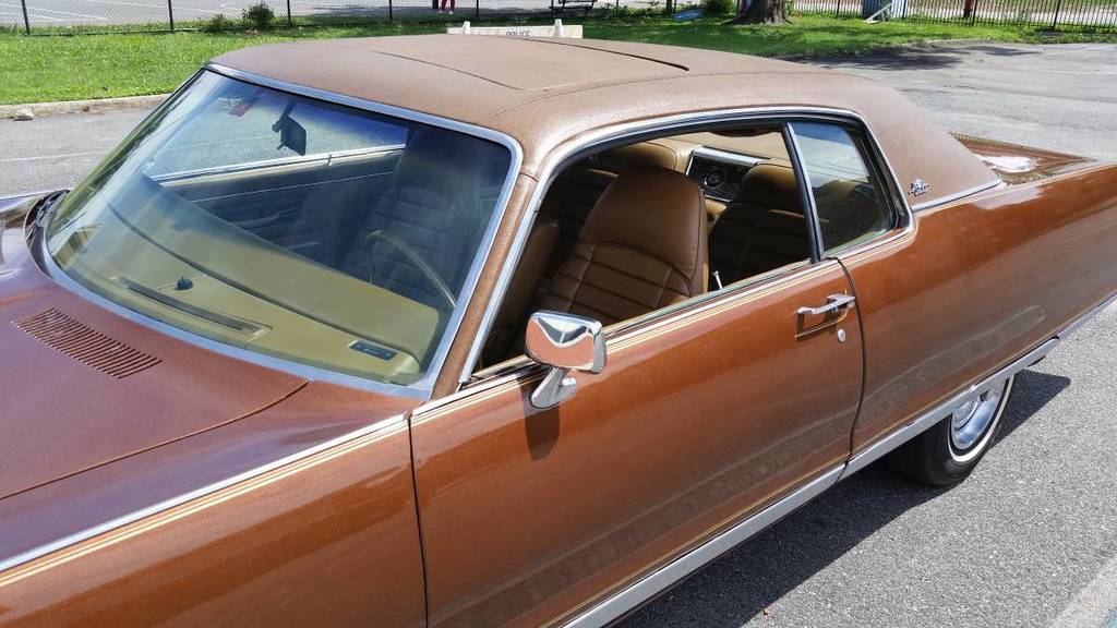

Why do you say so? I cant see any giveaways in the pictures.
Offhand, I at least see some waviness above the driver side rear wheel and forward of it too, right above the lower trim. And at rear edge of door too. Lower driver quarter looks funny too at rear.
Usually there is trim where that gold pinstripe is above the wide mouldings and that trim is held on with studded fasteners.

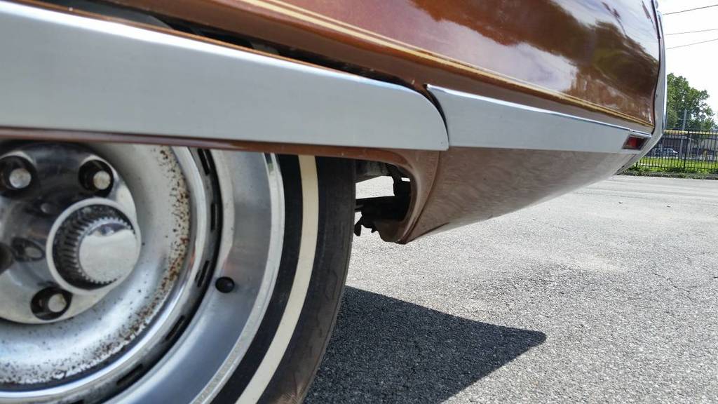

Real pretty car, but I'd say that it's had extensive rust repair done, and that's why it doesn't have the upper side trim anymore. You can see that the rear 18 inches or so of the stub frame has been capped. Look at the rectangular cut-out to access the rear body bolt in the upper right corner of the photo. Also, look at how badly corroded the left front wheel opening trim is. Sorry to say, but a patched up Jersey rust bucket.

Re the rust issues - interior driver's door panel shoes evidence of wetness... not good - rusties may be hiding.
