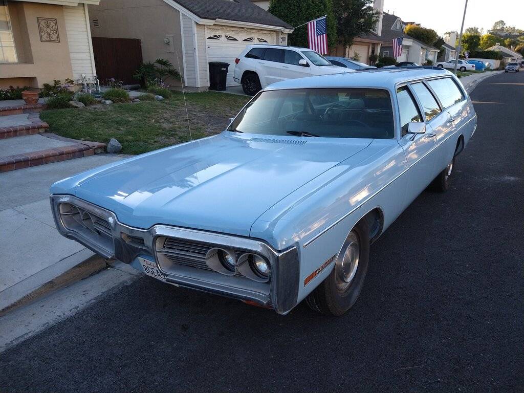

Beautiful wagon! Perhaps a spot of weld or a shim carefully placed might solve the problem. Probably just a case of wear over the years. Enjoy your great car!! Lindsay
