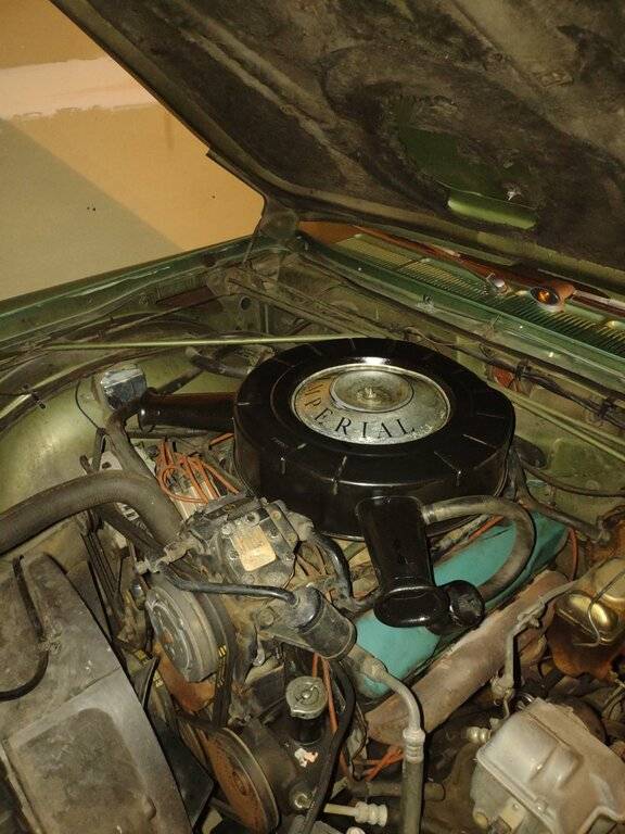

I can concur with the '68 Imperial having the factory option for the dual snorkel air cleaner and dual exhaust. Mine has these options, and it is reflected in the fender tag and the window sticker...

Thanks for posting. Are those the regular log type exhaust manifolds? I cannot tell for sure in the photo.
