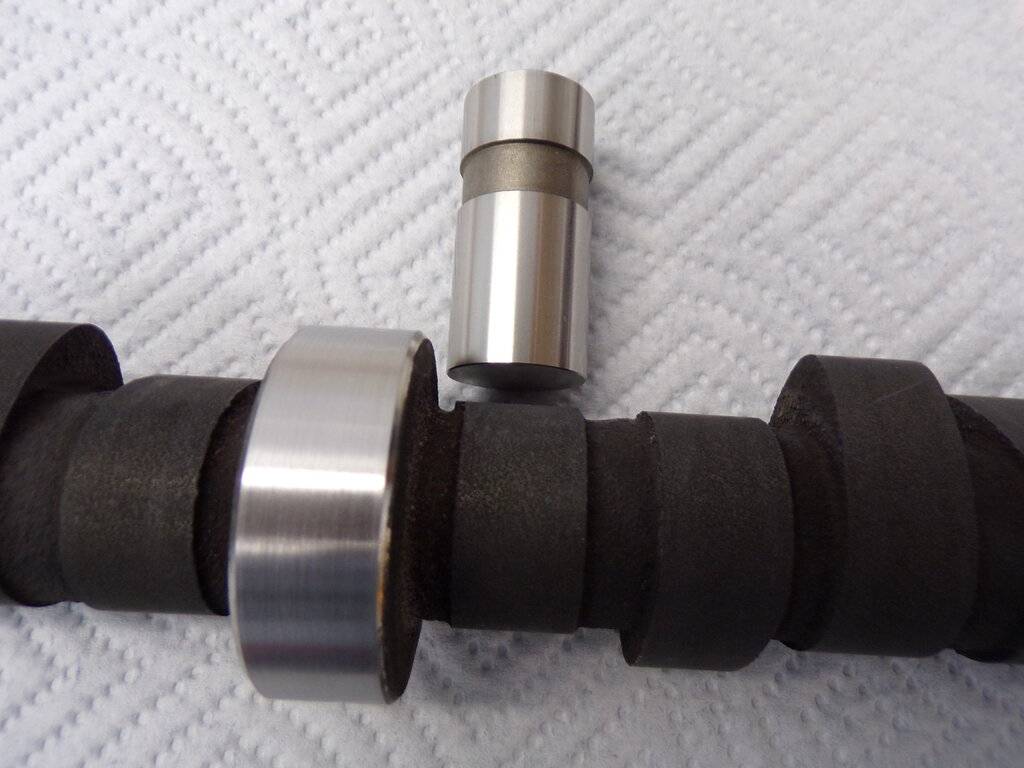

So when I get my solid flat tappet cam I'm going to use in this little stroker, I can just pull it outta the box, clean it up, lube it good, push it into the cam tunnel, and drop the lifters on it......right? Uh wrong.
You need to inspect that new cam for flaws that will ruin your day.
Look at this new OOTB cam and how the casting flash is out beyond the base lobe width. This flashing tit might be above the lobe surface and cause lifter damage and ruin the cam itself. I've had to return two cams in the past because of this problem.

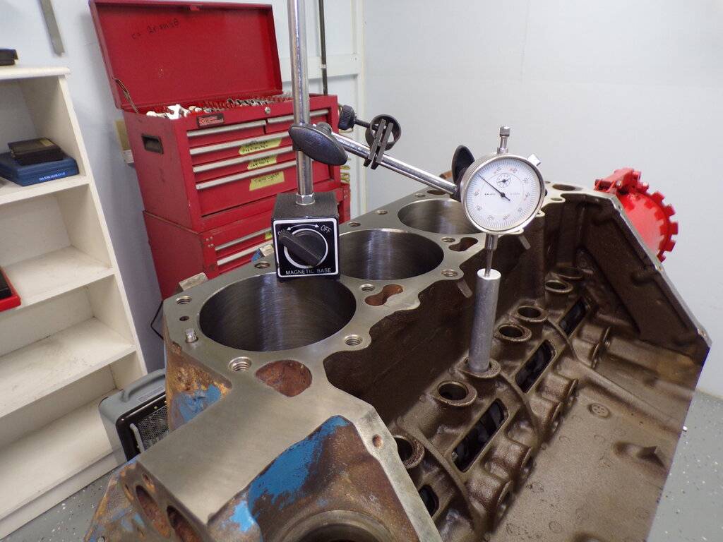

So we do put the cam in the block, but we install a test lifter and using the dial indicator we test all the lobes for an abnormal bump on the gauge indicating a flaw like casting flash that wasn't removed or hasn't been ground with the lobe at least as wide as the lifter. In the case of this cam we were good to go.............

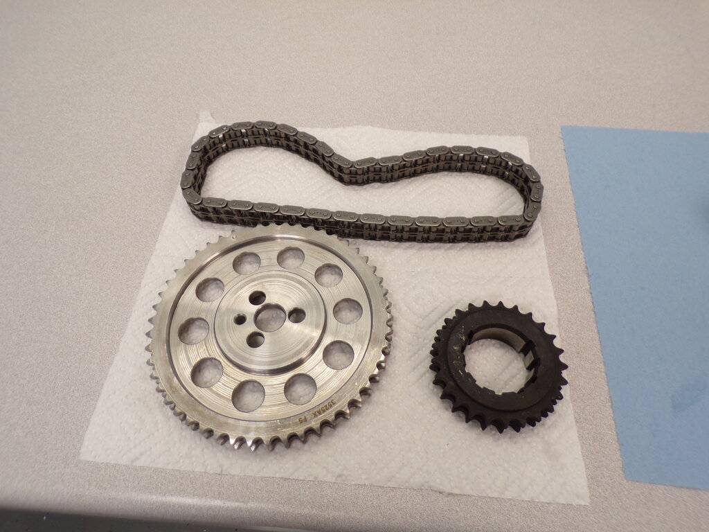

$100 timing chain and sprockets........out of the box, clean 'em up, squirt oil on the chain and slap them on....NOT!

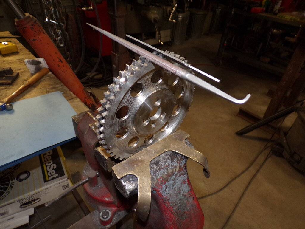

This cam sprocket has burrs and proud metal between the rows of teeth that would have been rubbed off by the chain and spred through the engine. Out come the fine files, brass jaws for the bench vise and we carefully remove the burrs without deforming the sprocket teeth.

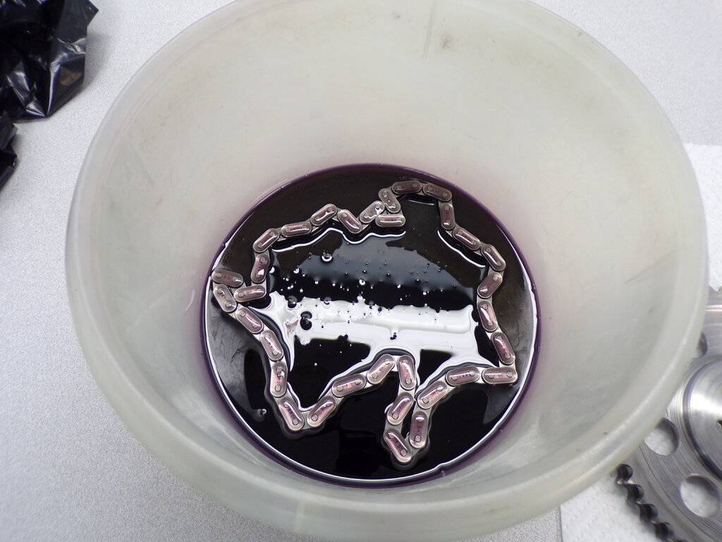

And the roller timing chain gets soaked in a bath of break-in oil overnight. Stirring the chain in the bath every once in a while helps get the oil throughout the chain components. I didn't do this once and had a chain gall and stiffen after a few dyno runs. Just dumb luck saved me a wad of lost dollars and had me pull the timing cover and discover the destroyed chain before anything else was hurt.
