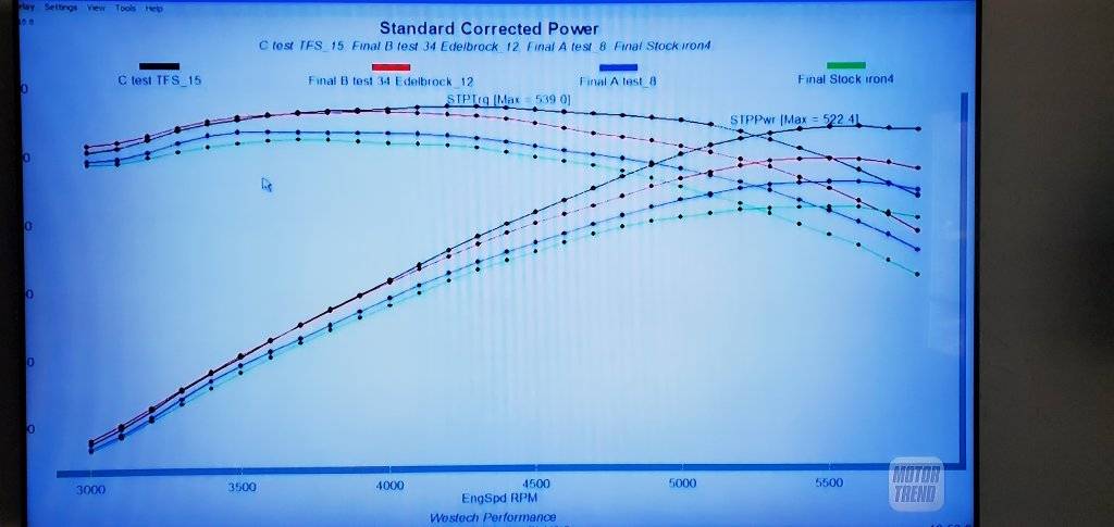

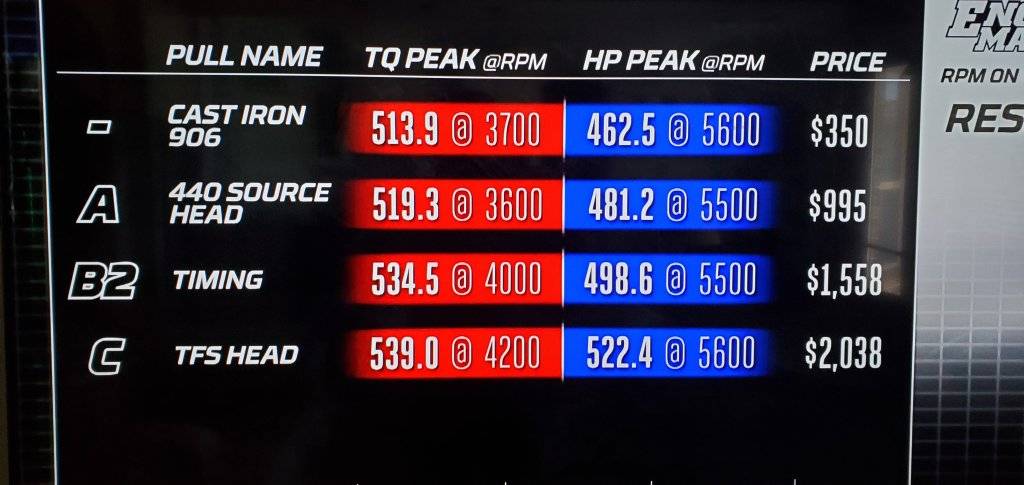

There is an episode of Engine Masters that was about different heads for the 440. Here's a screenshot on how they fared on the same engine.
B2 is an Edelbrock head with the timing adjusted to 34 degrees.
Thanks for the info, I was leaning towards the Edelbrock heads. This helps confirm it may be the right choice.
