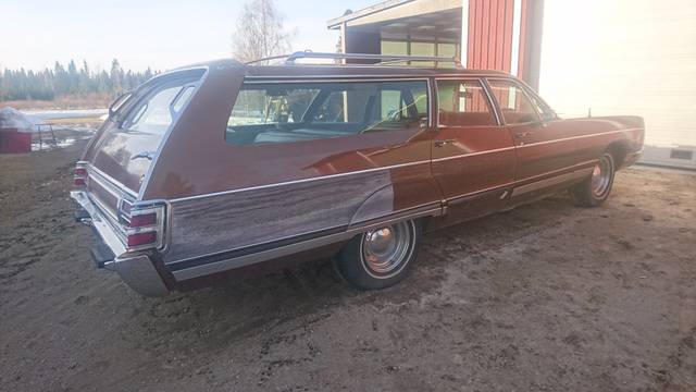

Today I took rest of drivers side woodgrain off. It took about 3 hours to clean rear door and quarter panel.

That must be a good feeling. A relief, even. Looks good. What worked best? Did you use a 3M wheel?

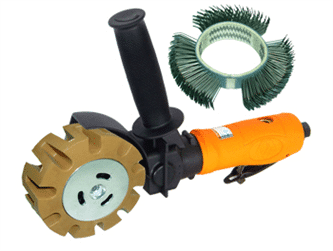

I used this. I don't know the name, it is just cleaning machine with sticker removing wheel. One wheel used, another one ordered. Passenger side next week.

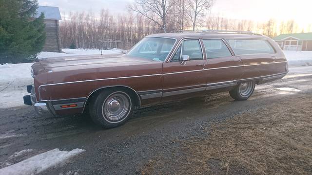

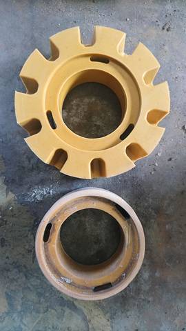

Passenger side woodgrain is almost gone. I have used 2 sticker removing wheel now, had to order one more.
I was at auto parts place yesterday, $50US for a 3M remover wheel. Seems expensive but if a person works at a shop...’time is money’...

These have been about $25 each. Not cheap either, but nothing else worked...
