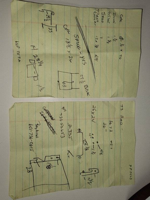

I don't fully follow all the notes and drawings but I clearly see the core dimensions of 26"! That's why the term 'you can always learn something new' is a good one! I have never seen any AC car beyond 1965 where both the inlet and the outlet are on the same side. So unless there is an obstruction on the upper driver side, I would swap the inlet to a drivers side one and get a new hose.
Is there an original fan shroud? If I could see the shroud and maybe some hole dimensions, I should be able to confirm shroud fitment. For a 26" unit, we've not had issues with re-using the orig. fan shroud.

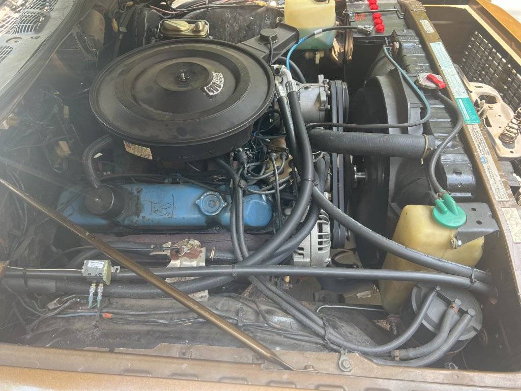

73 for sure, here is a pic of mine.
But possibly started in 72
Nice original looking engine compartment! Looks to me like they put the top hose over to the RH side to avoid the hose having to deal with the AC compressor. Not great for cooling but this was 50 years ago!
the shroud looks symmetrical and therefore should fit on a radiator with the LH upper hose position if you can clear the compressor.
