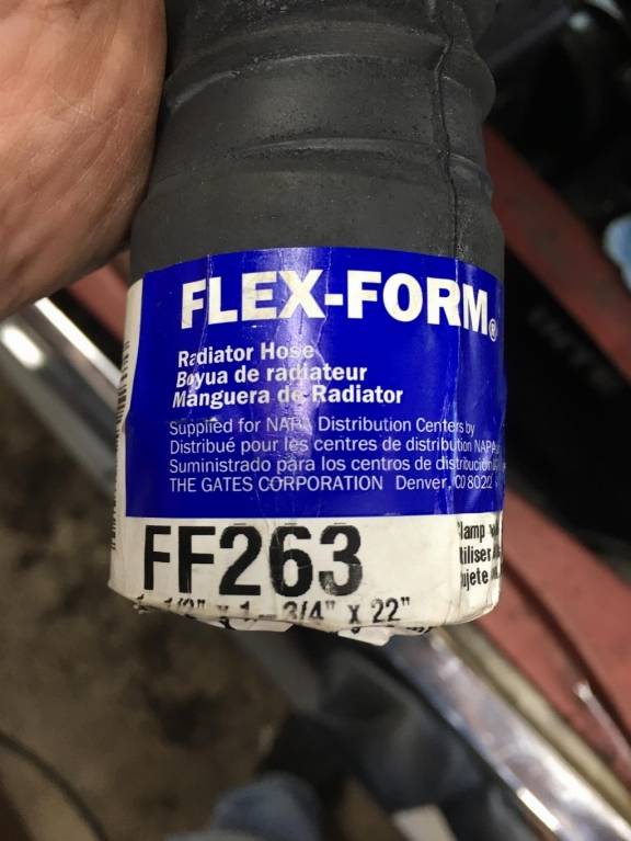

I used one of these hoses for the bottom and a flex hose on the top. While I don't want to use this radiator long term, it's doing the job. If there is a rubber bushing available, I can't see how that would be bad.

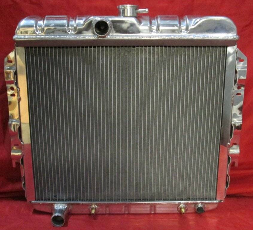

I've looked at Cold Cases radiators and quite frankly, their web site sucks. I did find this... But I think the upper mounting holes might be off... Not sure. 68-73 B,C,E Body 16x22 Manual Aluminum Performance Radiator I also think they mean 1.75" lower inlet size, but who knows? The upper would probably work with the AC hose.
This link will show the difference in the optional cooling radiator. BTW, that's my car in the upper two pictures as the web site belongs to the previous owner. lcool

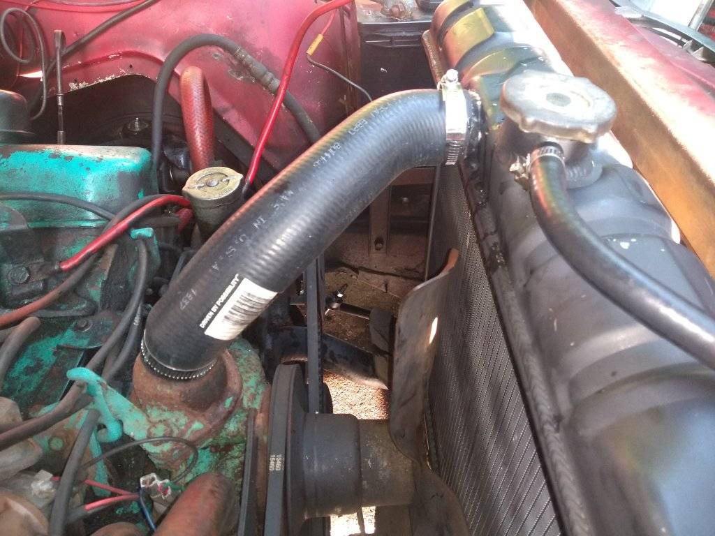

This is what I bought on ebay. It is marketed as a B body radiator. I put it and my old one back to back to compare. The overall size & shape matched as did the lower hose outlet, the transmission fittings and the upper mounting holes. I had to drill 2 holes for the lower bolts as the slots did not extend far enough up.

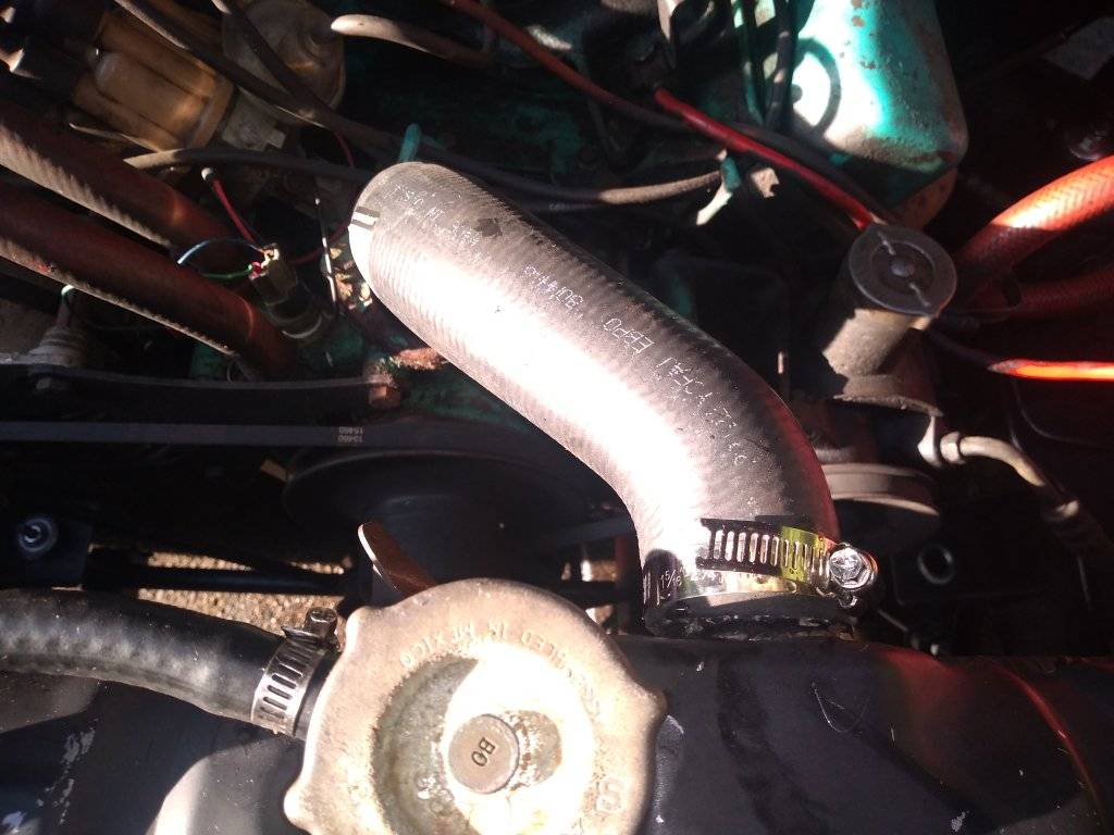

The upper hose was the only real issue. My original had a center inlet offset to the passenger side, so it lines up straight with the thermostat housing. The new one is offset to the drivers side. I tried the same hose, and it did work, but had more of a kink in it than I liked. This is a Dayco 70344.

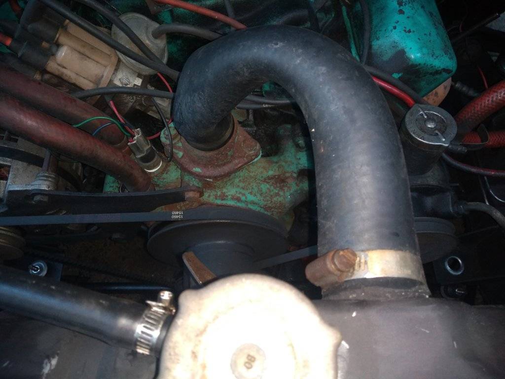

I could not find a listing for a hose to fit this radiator with an RB engine, but did find the Gates 20370. This seems to be for small blocks which have the thermostat 3-4" farther back from the radiator. Cutting about 3" off each end of the 20370 got me a fit that I'm happy with.
