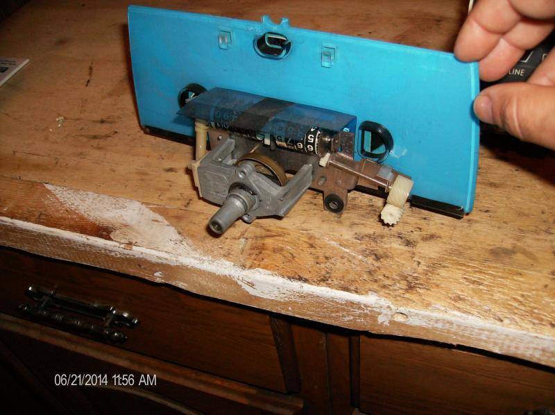

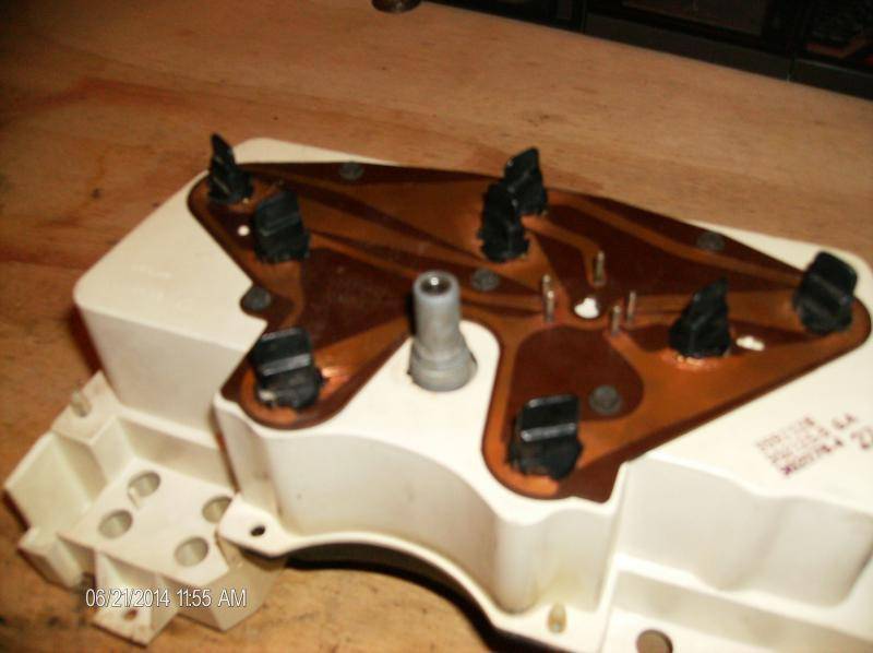

This pic shows the gear head at the back of the cluster and how it is not removed from behind.

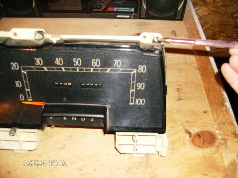

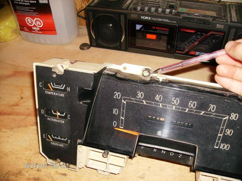

Now back to the cluster. The plastic cover is held on by plastic push on clips. Use needle nose plyers, find them all and pull straight back on them to get them out (I find wiggling them helps too).
Gently take off the cover and you will expose the speedo assembly and all the gauges (be careful not to touch the 3 gauges to the left, they are very sensitive and you can wreck them easily now that they are exposed.

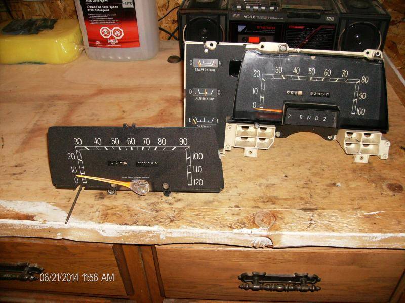

Two screws at the base of the speedo and the face/ gear head come out together.
Here's what it looks like once its out (front and back view next to the cluster). Note that the removed one is from a 74 Imperial (last year for the 120mph speedo in a C body). The cluster next to it is from a 76 NYB (last year for the mph only face. In 77 they had both mph and km- and depending on US or Cdn/ export the prominence of mph or km swapped).
