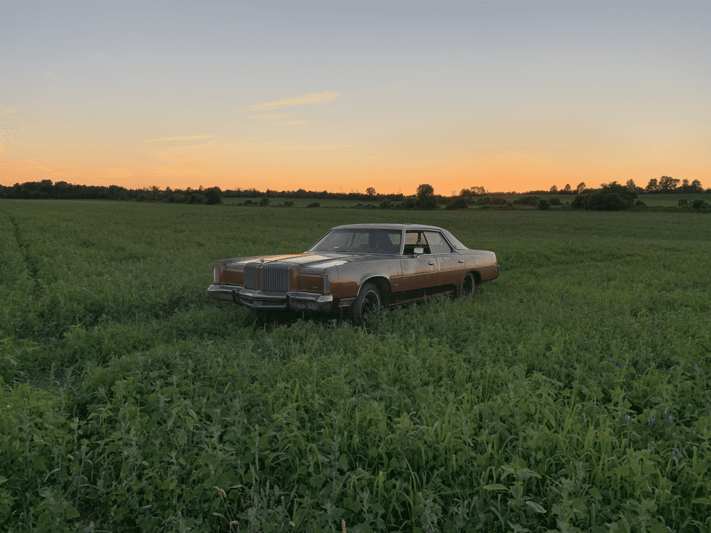

It's surprisingly very clean, I'd say even more so than the typical southern car. There's only light surface rust on the underside with a sizeable amount of (presumably) factory undercoating. The only real rust spot is right behind the captain's side rear wheel along the weld where the trunk floor meets the quarter panel, and even then I'll only need to replace a ~6"x1" portion

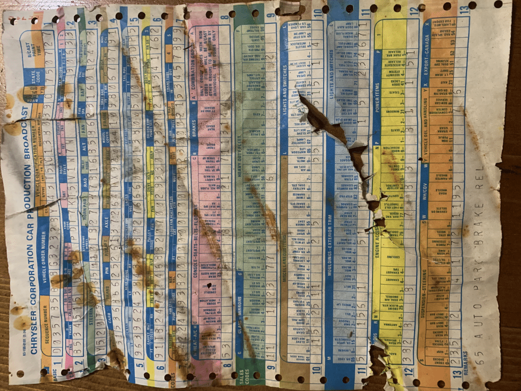

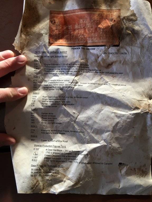

While tearing into my interior to get rid of all the mouse house and related smells, I was able to retrieve a complete build sheet from under the rear seat, I also managed to get three others though they are in much worse condition. When I bought the car it came with a decoded fender tag paper, other than that I'm pretty much clueless as to how this car left the factory. It's a Canadian car (1 of 32 to come with a sunroof) that's spent its life in central Ontario, presumably starting in the area west of Barrie, I'm guessing it was taken off the road sometime around 2010, in 2020 it was sold to somebody near Brantford who planned to run it in a derby, I bought it in 2022 and brought it back up to around the GTA, where I'm putting it on the road. Here's the sheet for all that are interested, I don't know how to decode it myself but if anybody wants to take a crack at it, go ahead. I can clarify the numbers if needed, between the four sheets I should have all the columns

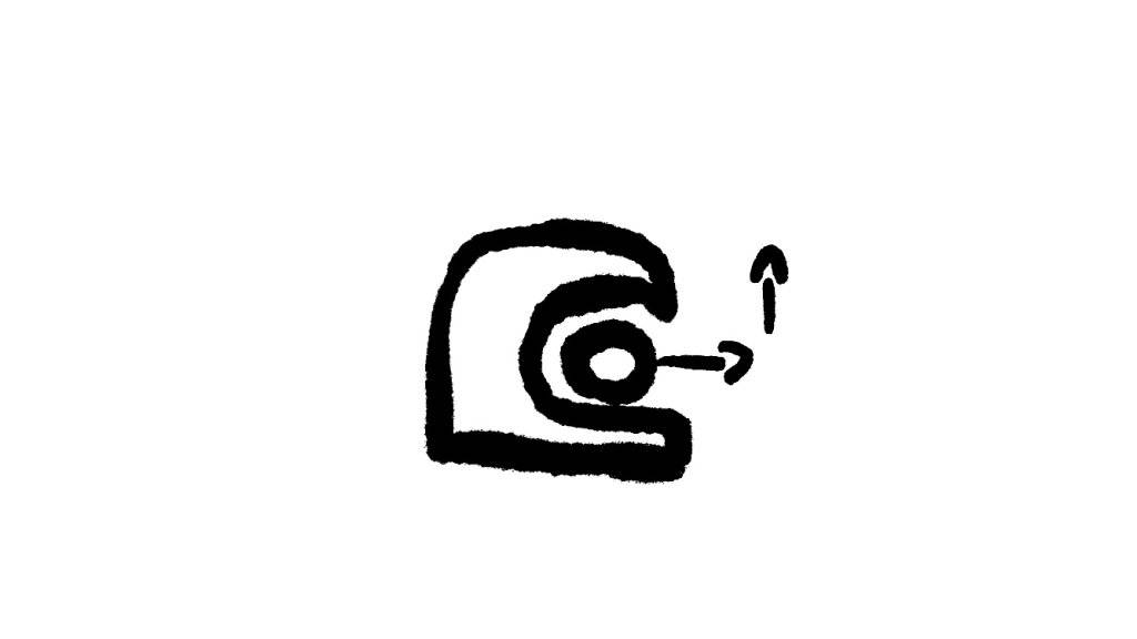

If you want to try and take out the bottom of the back seat, push inwards on the bottom frame then lift it up, there's a clip on both sides that look something like this holding the seat in. That's where I found two of mine, and a large mouse house. It's cool that your's came with all that documentation, mine didn't even come with the owner's manual
